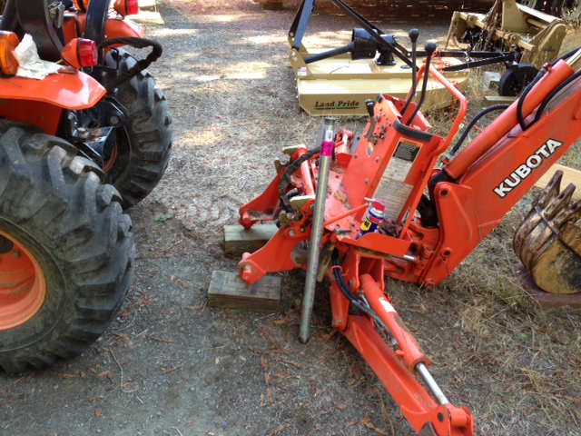

This is the first time since it was new, that is 8 years. Never under a roof. So I expected the worst. At first nothing would move. Photo shows Persuader #1 (pipe) and #2 (penetrating oil). Did not need Persuader #3 (big hammer). There was no rust at all, just caked grime that came loose by jiggling the mount arms and catches using the pipe and the backhoe hydraulics. I'm posting this in case some other B21 owner is wondering, will it come off after several years, the answer is yes.
