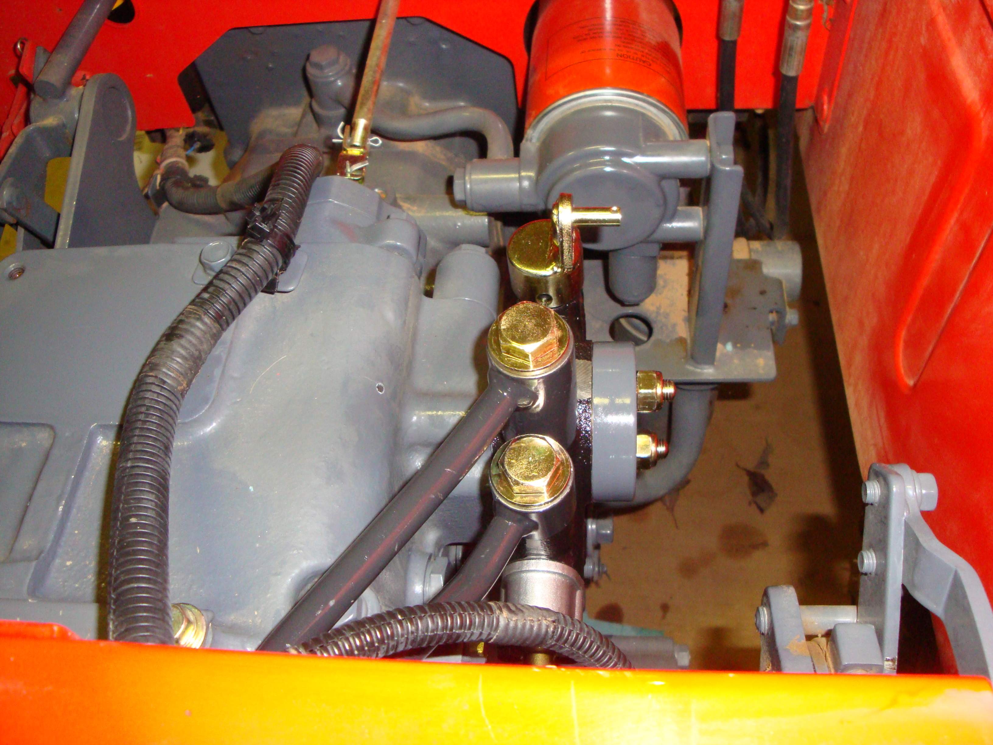

The term is "banjo bolt". It must come from the look of the hose end that it goes through? Neerneerneer
Thanks for the actual name of the part. I probably should have looked at the parts list that came with my kits. Always learning.
Bigturk, That's how my double remote kits were packed for my CK30hst but each valve for this model requires a short and a long banjo bolt. Good info for others with the various models.
   / Remove the right side tire? on CK 30
#12
Locktite. I never thought of that.
Would that be blue or red locktite?

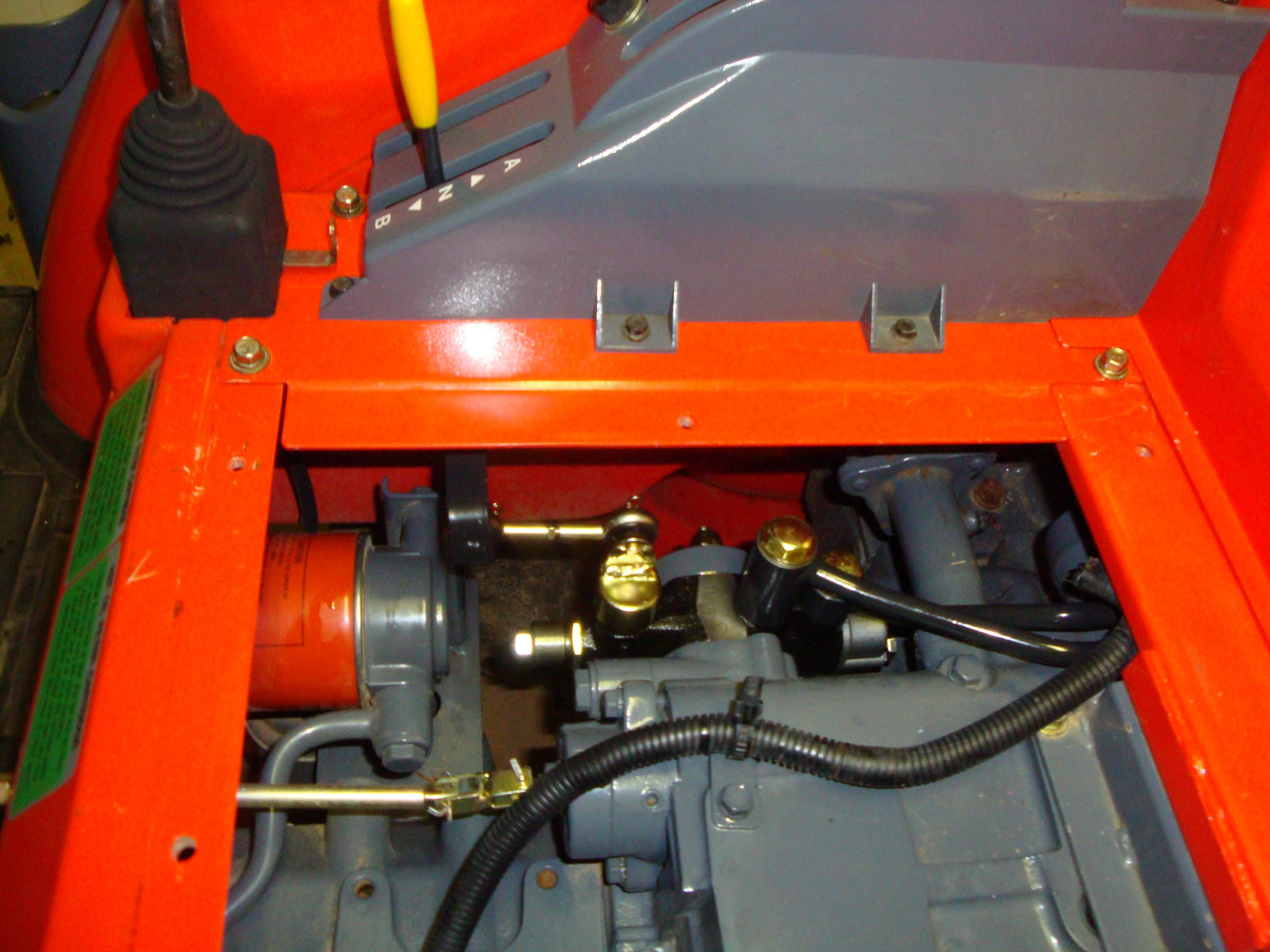

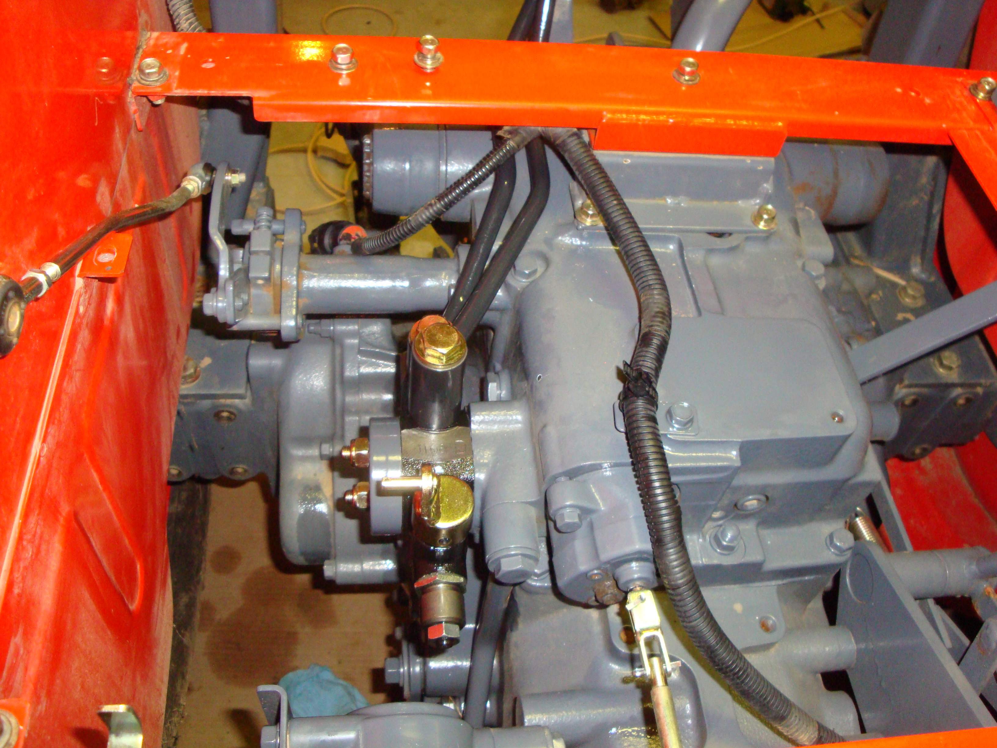

Got the remote kit on in about 3 hrs. Not as hard as I thought it would be. 2 thumbs up to Kioti for this one.
Let her run for about 15 min. and no leaks that I could see.
Thanks to everyone. I am happy.

Dang, missed this thread due to title. Would have chimed in, but I see you did a fine job. Congrats. Now for the second function.... and HSL.
ETA: I didn't have any leaks after 15 min run, but did notice some weeping later after use, just retightened.
   / Remove the right side tire? on CK 30 #15
The "blue" is sufficient. If your don't treat the threads on the studs, you may notice some leaking around the valve stack eventually.
