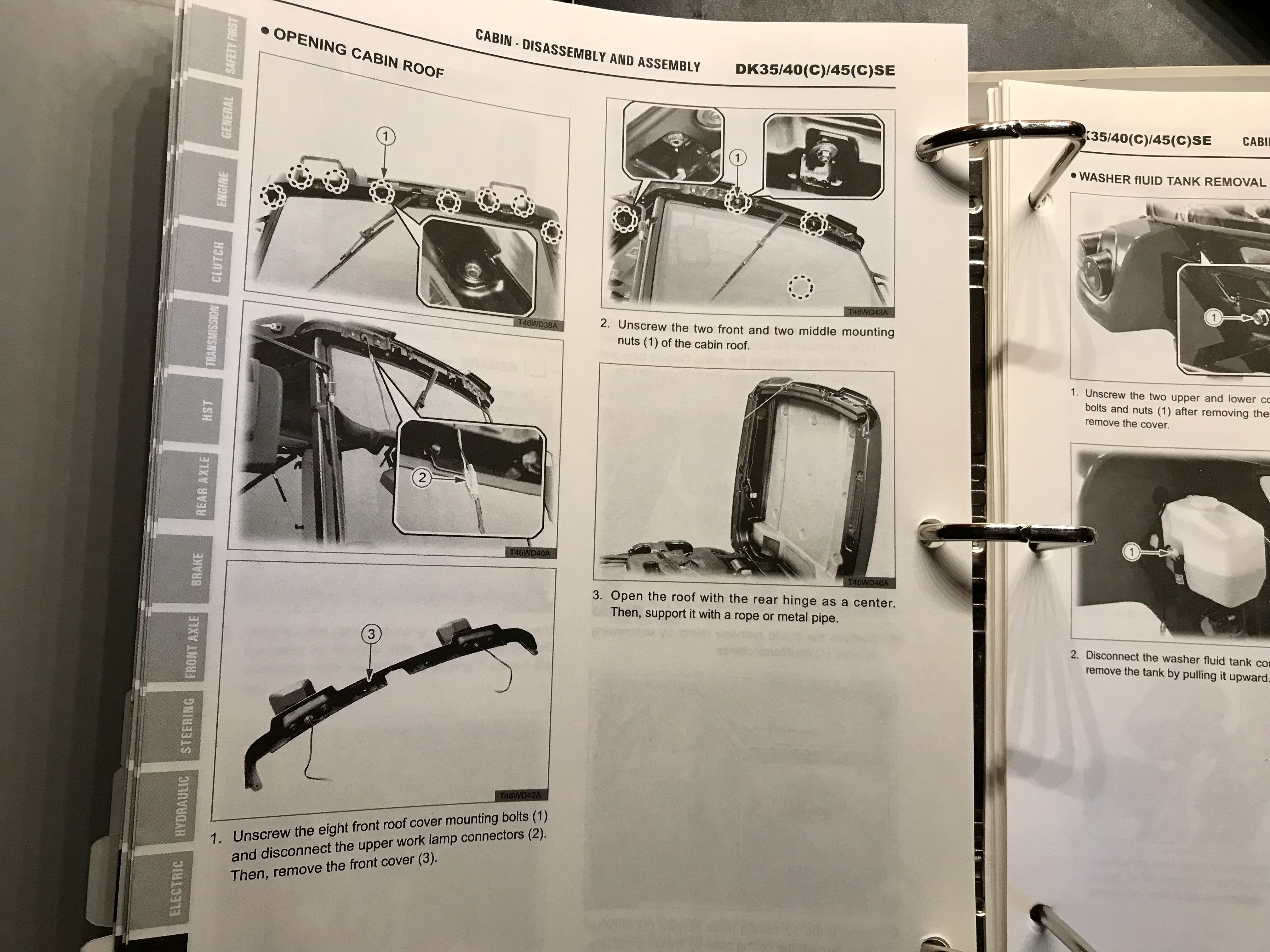

I'm looking at replacing the radio in my Kioti DK6010SE can. I have all of the push pins removed but the liner won't come down. Looks like I need to remove the temp controls, the radio and the cab light but I can't figure out how to do that? Any suggestions or manuals I can reference?

Don't remove the Liner from the inside!! All you need to do to install the radio is remove the cab roof. There are nuts you remove from the outside, front and side, and the cab roof will lift off exposing the top side of the roof liner.
Most of the time you can add a radio by just removing the stereo cover plate and reaching inside for the wire harness. If it is not a KIOTI Radio, you will need an adapter harness. Just google KIOTI Radio Adapter. I believe it is a Toyota part number.
Hope this helps
   / Remove cab liner for radio install on Kioti DK6010 #3
What he said. Very easy
This is from my 2010 dk45 , but im sure yours is similar
