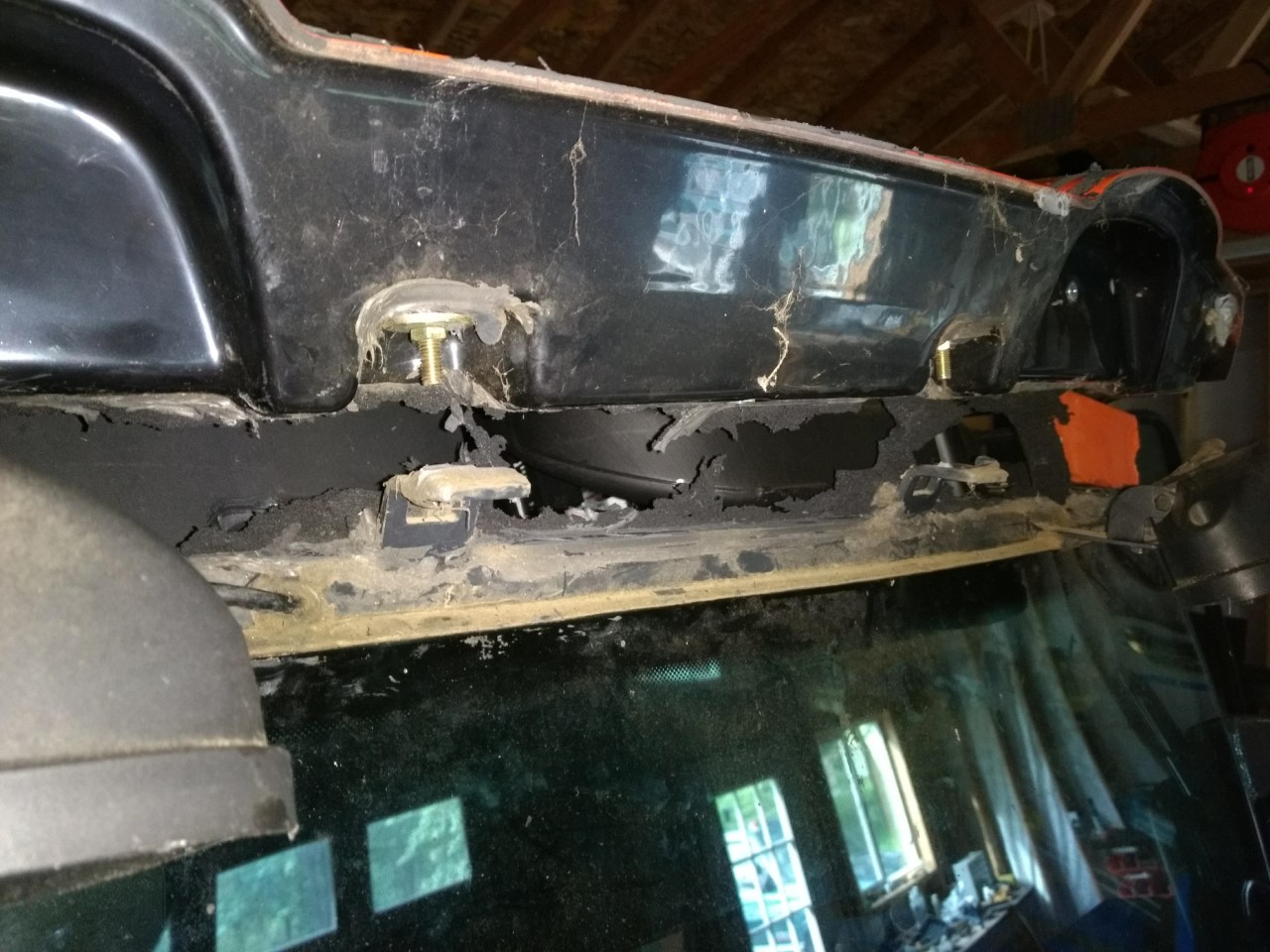

Hi, guys! Thanks for the input.
My quandary is that I don't have access to the front edge area to cut the RTV!
I am planning on running straps (or such) under the roof (when I'm sure that the RTV death grip is gone) and lifting it up from my rafters. With the top suspended I'll drive the tractor out from under it. I need to clean off the RTV from the top, so it needs to be brought down and turned over for that operation: there's also a crack, with some small branch piece piercing it, on one of the back corners- I think I can extract the wood and seal it up OK). Will look to clean the tractor up outside the shop (weather permitting)..
The bezel looks to block access to slicing the RTV on the front edge. That's why I'm thinking I need to remove it. I have thoughts about using my heat gun to loosen the RTV but worry about harming the plastic and fiberglass.

Clocked in a bit over an hour to get the front cab bezel off. Now I can get at the front seal. Nothing like being up in the air with razor blades!

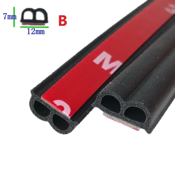

Eric, did you replace the original foam seal? My dealer RTV'd over the foam and it's all going to have to be removed (tack on a couple hours for this work). I don't ever want to face this amount of work again; also don't want leaks. I've got some butyl caulk that I'm contemplating using.

I’d clean off both the frame and the top , then buy a good D shape seal from 3M that is adhesive backed on one side. Might upgrade to a little thicker wider one. They also have a B shape that may seal better , I don’t Remember just how wide the sealing surfaces are on the tops , been several years since I had mine off.

Country, thanks for the tip! But, I was kind of looking forward to staring the dealer in the face when ordering a seal from them, noting that their "repair" job will, when all is said and done, cost me 5 extra hours of my life.
Only been able to peck away at this an hour or so a day.
RTV and foam. A HUGE mess:
After about 2 1/2 hours of work. Roof lifted. Have yet to clean things up (mouse nest should be obvious):
