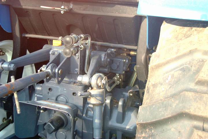

Would someone post a picture of their remotes installed on a TC45 or similar NH tractor. I'm wanting to add two, maybe three and I'm curious to where they're located on the rear.
Thanks, Jeff

Jeff, I have photos of the single remote valve on my TC45D and the Maintenance Manual illustrations already scanned and ready to send to you because I already sent them to Dave Varberg. I'll be happy to post them, but it will be Saturday before I am in the location where they are. If someone else doesn't post before that, I'll post them.
JimI
   / Remotes #4
Here is the single remote valve quick connects on my TC45 (just above and to the right of the toplink). The second set of remotes is mounted just below this set and the third is monted on the other side (left side) of the toplink assy. I'm also going ot attach the illustrations. Essentially, the remote valve assemblies just stack on top of each other as you can see in the illustrations.
JimI<P ID="edit"><FONT SIZE=-1>Edited by jinman on 10/13/01 00:45 AM (server time).</FONT></P>

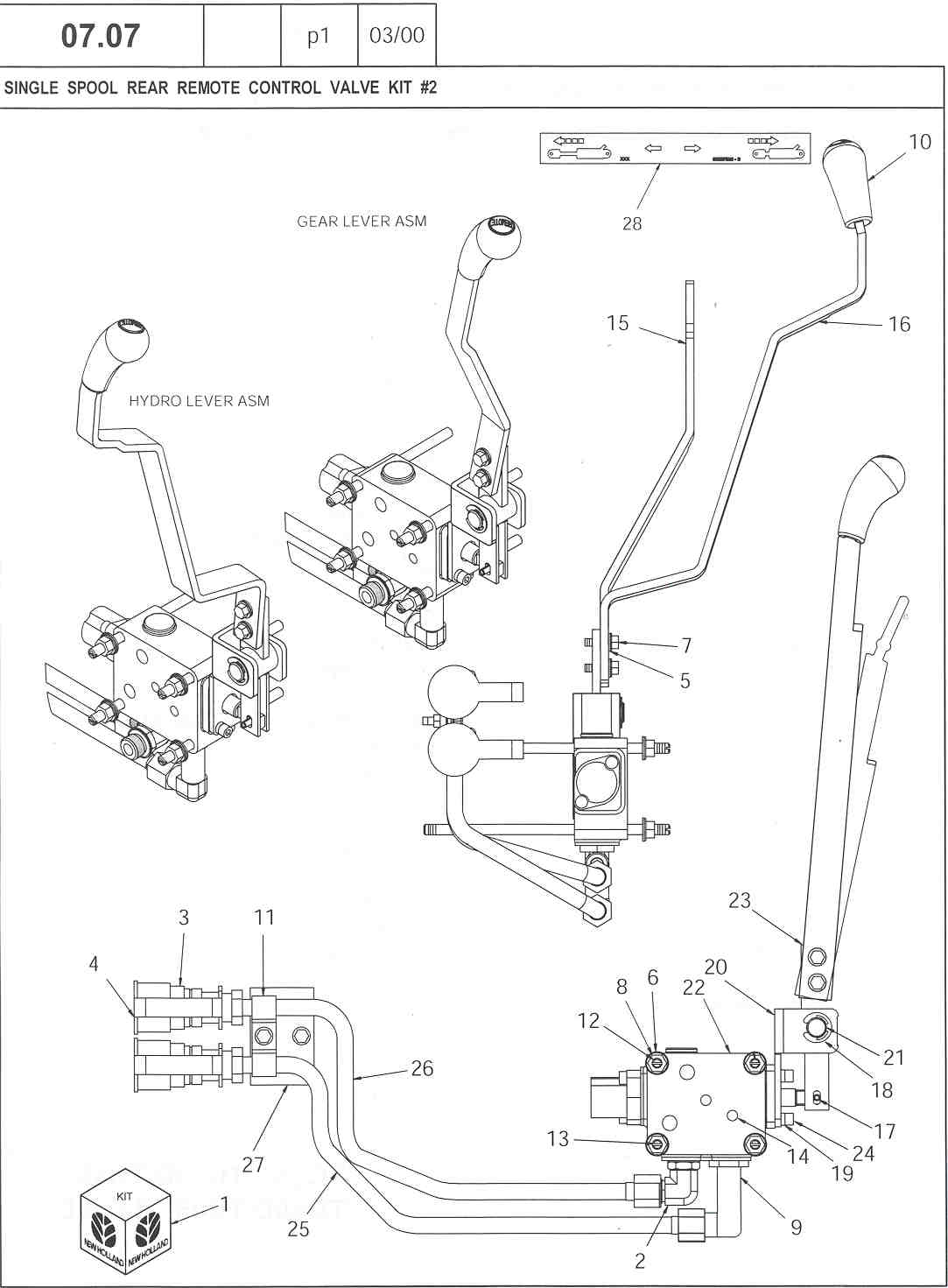

Valve 1 illustration.
JimI

Valve 2 illustration.
JimI

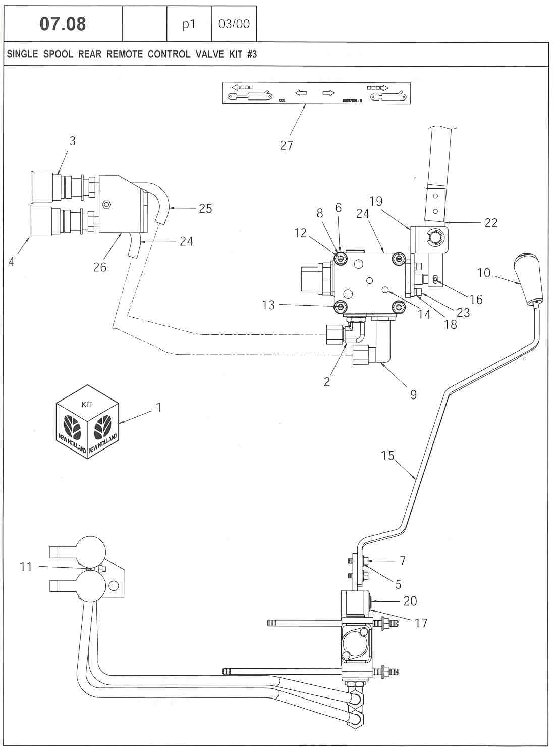

   / Remotes #7
Valve 3 illustration.
JimI
