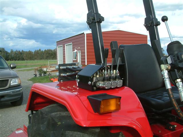

I have triple rear remotes on my 2008 Mahindra 5525.
For front mounted equipment, I run a pair of 3/8" hyraulic hoses from the rear remotes forward.
The setup on your Mahindra looks like a bit of home brew. Very tidy. Tell me what you have done there. At some point I would like to add a rear remote or two, but have been a bit put off by the price of the New Holland kit. I have a diverter valve on the FEL, and have been using those lines as needed.
Thanks,
Christopher
Home brew--no way. That's a dealer installed setup ($700, installed when I bought that 2008 Mahindra 5525 new). It's his own design, not factory. The power beyond (PB) port on FEL control block is used to supply high pressure to the triple remote valve. And the spent fluid is returned to the sump via a tee in the return line.
The dealer did a nice job with your setup. By home brew I was thinking ,"not factory".
I will think about how that setup might work for me. Thanks.
