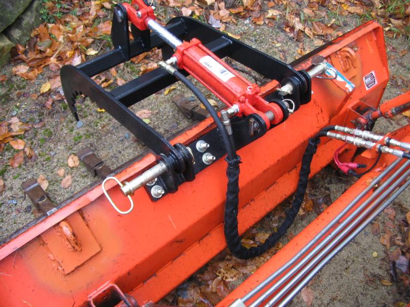

Does 'spool' mean just one hydraulic valve? So, double spool is to levers-each with their own body and each can go forward or reverse?
I'm looking into adding remote hydraulics to the front of the FEL. Is there anyway to add on to the existing B7800 valve to accomplish the need? Does anyone have a source for bent tubing or is it feasible to bend your own tubing (then take it into a shop to have the fittings installed)?
When adding a remote to the front of the tractor, is it best to tap into the rear remote on the B7800 and run the lines forward?

A valve can have one or more spools (functions). A standard double acting spool has 3 positions, center neutral, A and B. Your loader valve is a 2 spool valve.
There is no way to add on to the existing loader valve short of purchasing a new 3 spool valve and fabbing a joystick linkage. Most people install either a diverter off the bucket curl spool or a third function valve. There are plenty of posts on the hows and whys of these methods. Just search for WR Long or take a look at the dozens of posts on grpple installs.
It can be done that way or with an electric diverter or third function solenoid valve. Having a button on the joystick is more convenient than using lever mounted on the fender. Routing the hoses can get a bit messy but people have done it. Search TBN for the various grapple installs to get an idea of how other people have done it.
