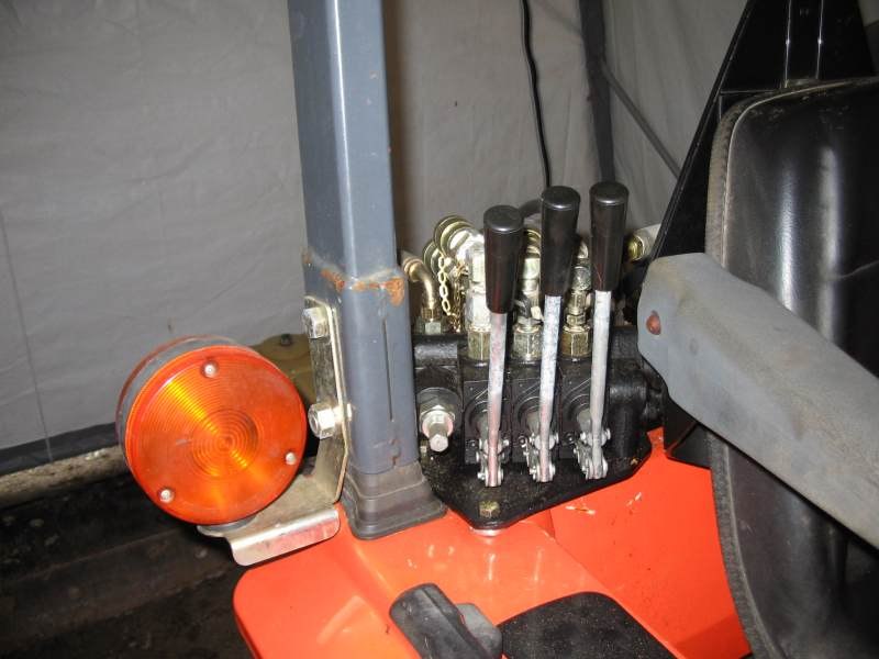

I'm in the process of collecting the parts to add remote hydraulics to my Kubota B-7800. I've decided to use a Cross 2 spool valve per the recommendation of a large dealer that posts here.

Yes, your tractor has an open center hydraulic system so you will need to have an open center valve with power beyond that will connect in series with the loader valve. You should purchase a valve that is sized for your hydraulic system's gpm flow. A little larger is ok but not too much larger. For example if your tractor's gpm is around 5 then you should be looking for a valve in the 5-10 gpm range. Pay close attention to the size and weight of the valve because as the gpm rating goes up so does the physical size and weight. The commonly found 25 gpm valves are real monsters.

Based on your L3000 tractor and your requirement for 4 spools, your best, most flexible, and probably least expensive route is to purchase a Prince SV valve with 4 stackable spools. I used a 3 spool version on my B2710 with just a little over 6 gpm of implement flow. The 4 spool will be about 2" wider than mine.
You can configure the spools to meet your needs. Here is a link to the Surplus Center configurator for that Prince valve. The typical spool valve selection would be "Section B".
