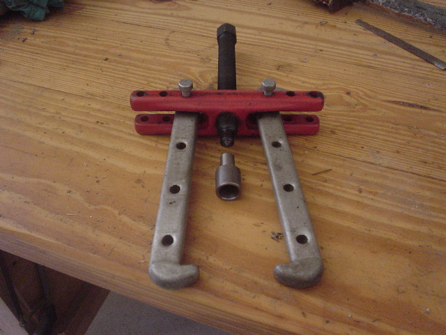

Ok, hope you weren't expecting anything elegant. This one is for the male side. The gizmo sides on the male connector and is held there by sliding the cross pin to engage the connector groove. The black bolt, 1/4 -28, compresses the plunger. Whatever you use to compress the plunger, make sure it can't contact the sidewall of the hole in the connector. There's a seal in there that is fragile and I ruined one.

This picture is of the gizmo for the female connector. The plunger on the female connector is a ring and the bullseye is part of the body. Since there is no way to retain a gizmo, I just made a ring shaped adaptor to be used with a gear puller. It fit well enough that if there is a seal in there, no damage was done. Picture 2 0f 2.
