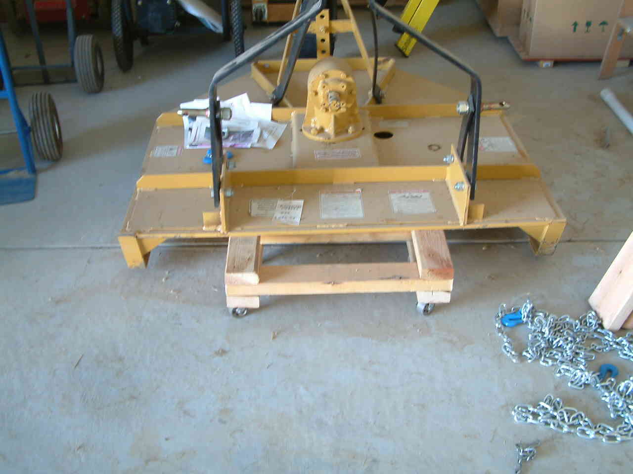

My trick is to keep my 4-ft KK brush hog parked on dollies on the concrete garage floor. The image shows the front dolly. There's another one to support the rear end of the hog.
The lower 3pt arms each have a sway link that's adjustable via a turnbuckle. I unscrew the turnbuckle completely to get max spread on the lower arms. This gives plenty of room to get the hog hooked and unhooked to the 3pt arms.

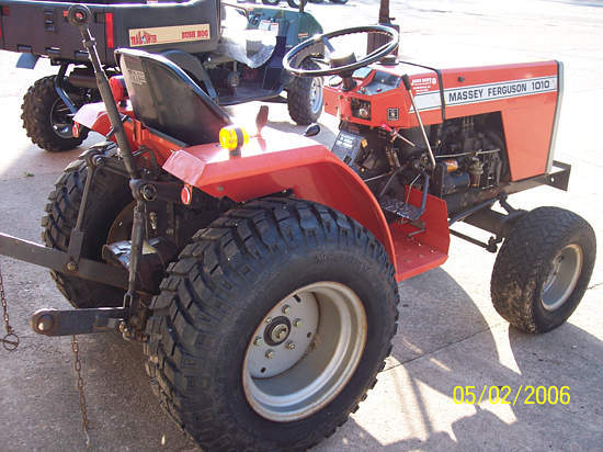

Hi Rich,
Yeah, mine is an '87 MF 1010, and I actually got the manual for it, but it leaves a lot to be desired. All of the photos are in black and white, small, and some are washed out really bad by what appears to be a very bright flash on the camera so you can't see much detail. You would think that even back in the 80's a major tractor manufacturer would at least be able to publish clear photos and illustrations in their manual. I've got the manual for the MMM and its the same way :(. I don't see any mention of a toolbox in it either. Either way I've got a wrench that easily fits the jam nut, but I still think it is easier just popping off the link arms. I find I don't have to do this with my blade as I can easily move it around, but with the hog its a lot easier, although I only have to pop off one of the link arms. The only real downside I see is that it increases my odds of losing a hitch pin in the field :).

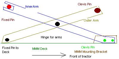

I re-attached my MMM last night for the first time. What a pain. I have to admit that I unattached a few extra things that I didn't need to the first time I unattached it so that added to my grief (like the lift arm that comes from the rear hitch). So are the actions of a newb. I also had to work on the front shield as it was dented in some and made it nigh impossible to remove one of the belts from the pulley. I was able to pound it out some. But hey it was a good educational experience and now I know quite a bit more about how the thing is attached and how the lift works from the 3 pt. hitch.
Oddly enough one side of the MMM doesn't seem to lower as far as the other via the scissor like arms on it. I'm not sure if its being bound up somewhere or what. I reattached the forward arm to the more forward hole and this seems to have helped. See the attached very primitive image. The inner arm (blue) attaches to the front of the MMM via a clevis pin through a mounting bracket (brown). The arm has a long slot that at that point that is supposed to slide along the pin as it "scissors" up and down. The manual says its supposed to attach to the most rearward hole (the left one of the 2 bright green holes). However on the right side of the MMM this limits the up and down movement so much that the wheels hardly touch the ground. I switched to the more forward hole and it seemed to increase the motion.
Related to all of this might be the fact that on the left side of the MMM, the big bright red round bracket that the inner arm slides onto (via the fork at its upper left end) is missing and has been replaced with a large hitch pin. This allows a little more lateral movement than normal.
I like the dolly idea, if I had a concrete floor to store it on :)
However on my little tractor even with the sway links fully loosened the tires are too narrow to fit the 3PH on to the hog (the tires actually get in the way). Thus I have to pull it over one way, attach one side, then pull it the other and attach it. Quite the pain.
Another problem I am having when attaching/unattaching the hog. My PTO attachment link for the hog is too long after I've attached it to the 3PH. I slid it as short as it would go (unless some of the plastic housing is getting in the way) and when attached to the 3PH its too long to fit onto my PTO by just a couple of inches. So I have to back up to within a couple of inches of where I need to be to attach the 3PH, shut down & get off, then attach the PTO, then start it up, and back up those last couple of inchese, shut down again, get off and attach the 3PH.
When removing, I have to do the reverse. Is this a normal problem or is there a simple solution?
