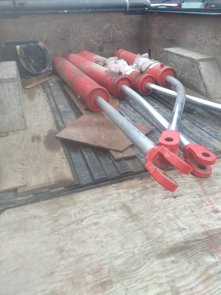

Starting off with a job that came in recently. I rebuild these cylinders off large air drills for one of the local equipment dealers. Mostly lathe work these. IMG_20201002_105004212.jpeg

Welcome (back). How do those cylinders get bent so hard?
   / Reintroduction and project thread
It's bad design or user error depending on point of view. On these specific air drills if you leave it in transport mode with the wings down, going over a bump on one side makes the other wing over center and it bends both cylinders on that wing at the same time.
5.5" bore 36" stroke cylinders with 2" rods, so to bend a pair of them is a fair bit of force....

Not to say it's impossible, but I've never seen it done successfully. The issue is if it isn't absolutely perfect you can ruin the gland and the tube. It will cycle until it galls the inside of the gland, the piston, and the bore of the tube. And at that point you're basically at throw it out or spend more than it's worth to fix. And you also run the risk of the shredded off bits of steel running through your hydraulic system and causing all sorts of other expensive damage.
Very small cylinders (the sort available for $200 or so from the various sellers of chinese hydraulic components) usually arent worth fixing. For large or expensive ones the rods are typically replaced. My shop buys 24' lengths of SuperChrome shafting, cuts to length, and then lathe threads or welds on ends as needed.

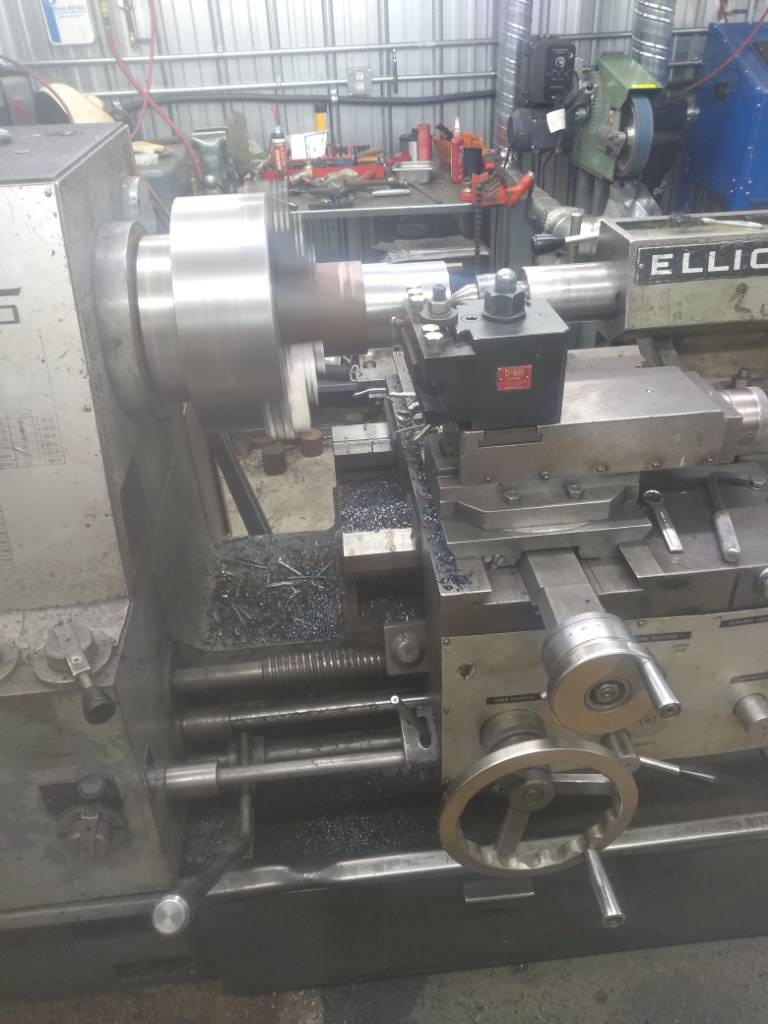

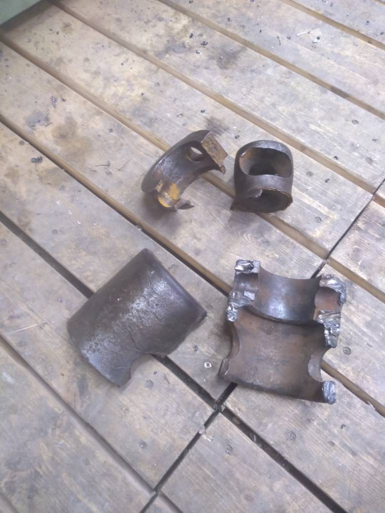

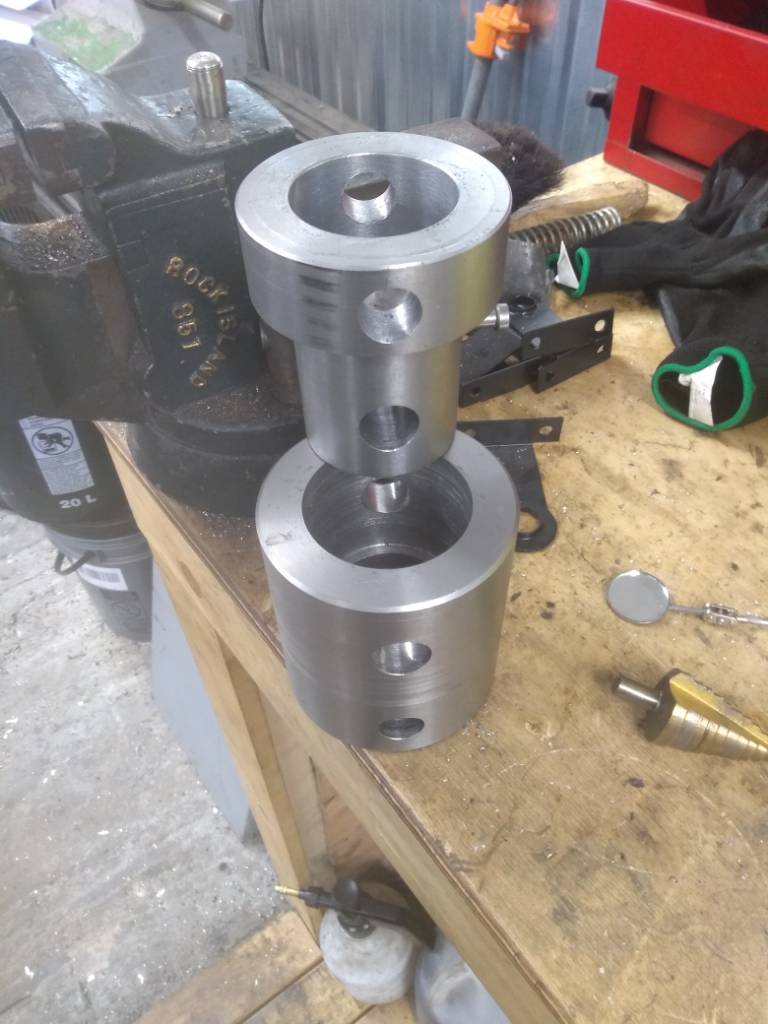

Another recent one. A bit of reverse engineering on what used to be a shaft coupler on a disc that was no longer available. Started as a length of 5" round 1045. These jobs are where having a nice heavy lathe pays off. IMG_20201021_083613515.jpegIMG_20201020_095156540.jpegIMG_20201021_083621488.jpeg
   / Reintroduction and project thread #8
The right tools and the knowledge to use them!!! Nice work!!!
