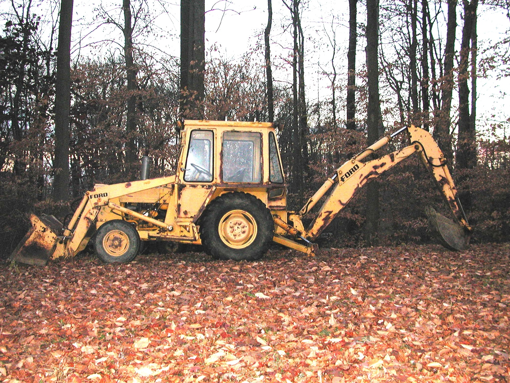

First propery it was all about digging out stumps, grading and moving big rocks.

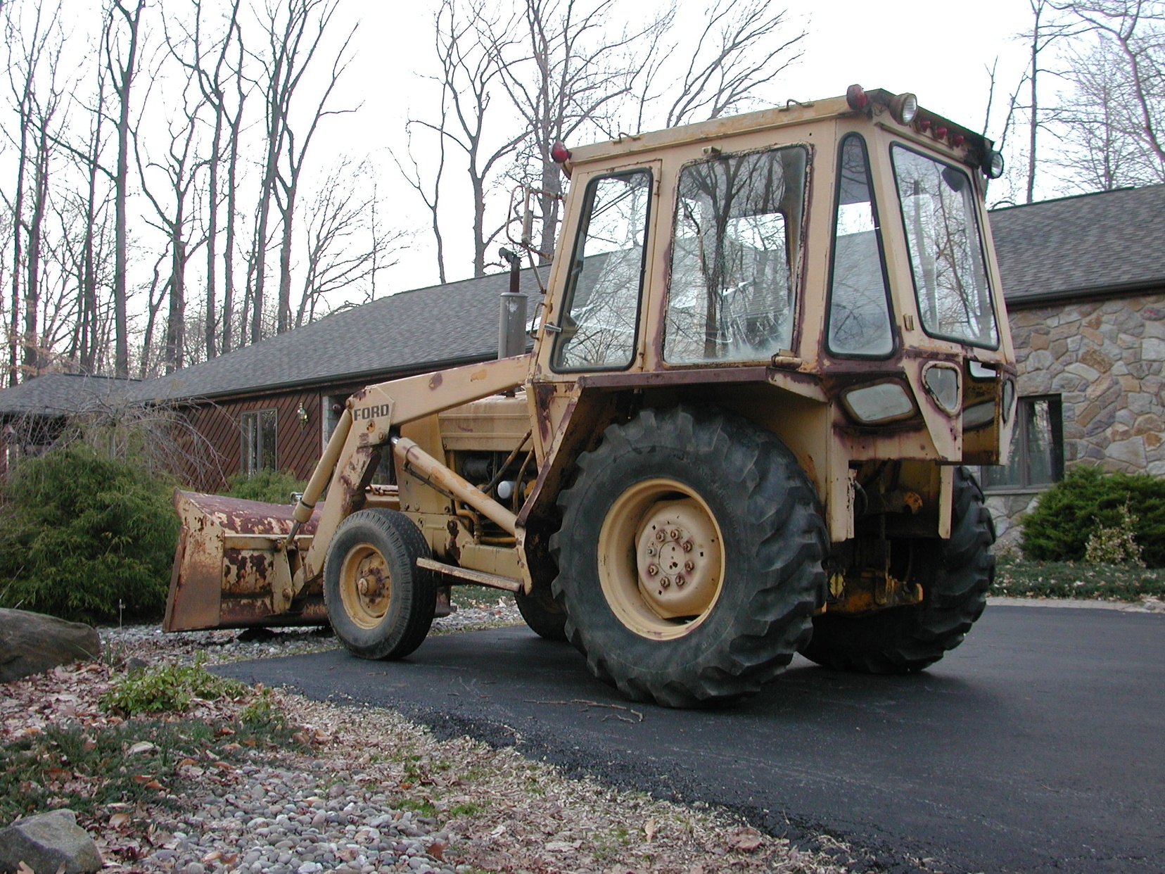

It was a 1973 Ford 4500 Industrial.
Someone here said you shouldnt use a farm tractor for a backhoe.
This 4500 is a farm tractor that was redesigned by Ford to be a backhoe.
The original pedals are still there under the footboards. The rear end has the same casting that would have had the PTO but no PTO gearing. If you removed the backhoe specific metal... you had a farm tractor.

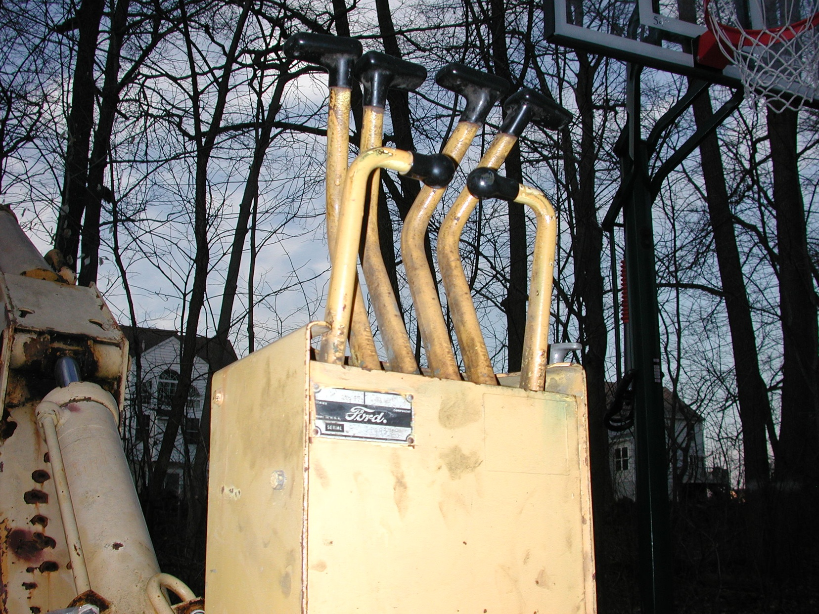

Here it is with the hoe removed so I could replace all the hydraulic lines to the four stick control valve. Actually six valves when you include the outriggers.
Modern backhoes are purpose built. You can't take them apart like this as a unit.

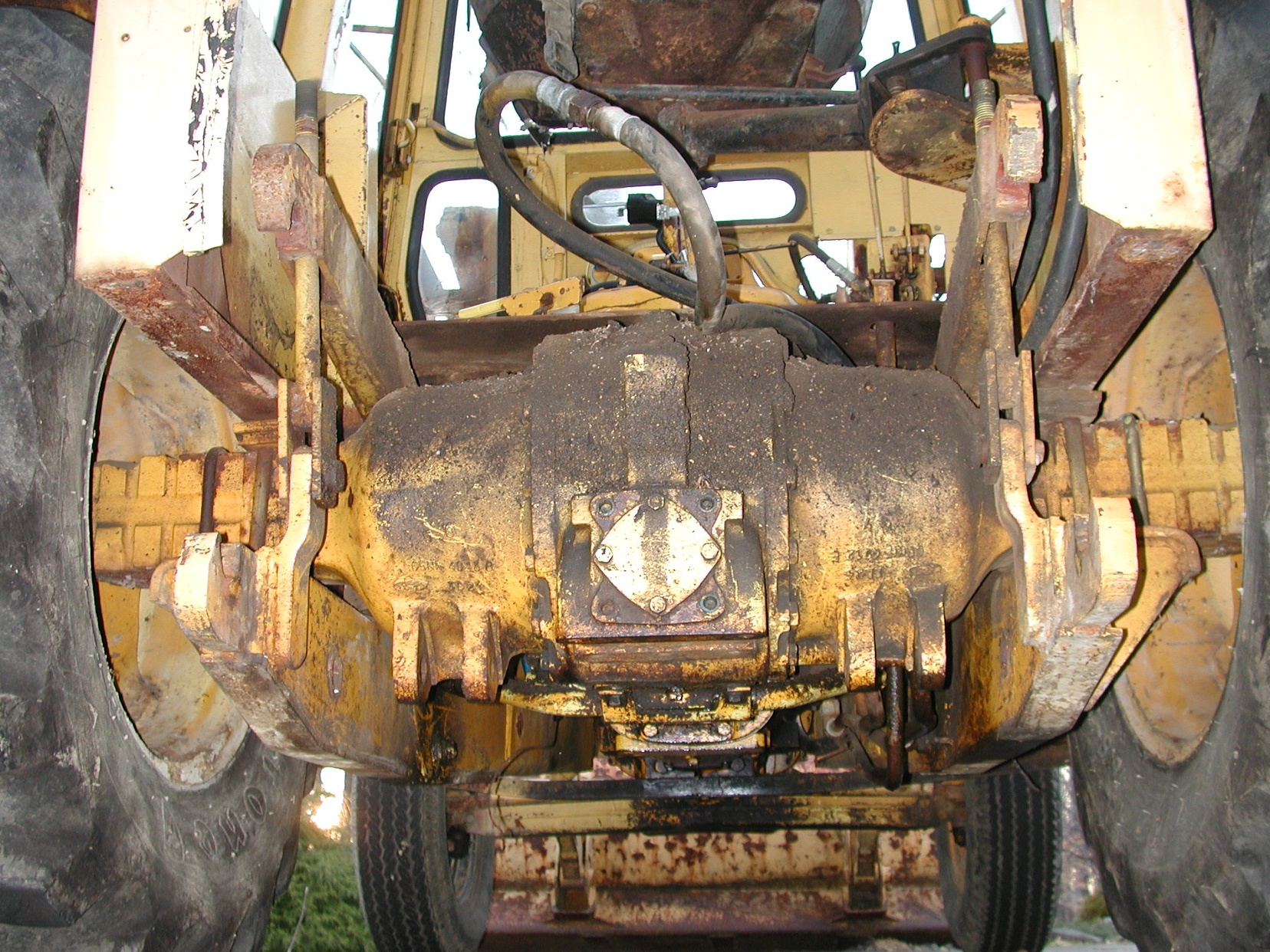

And here is a view of the rear showing the 3PH attach points and the PTO access. You can see the two large arms hanging from the upper bars and the "hooks" in the bottom ones that the hoe drops into.

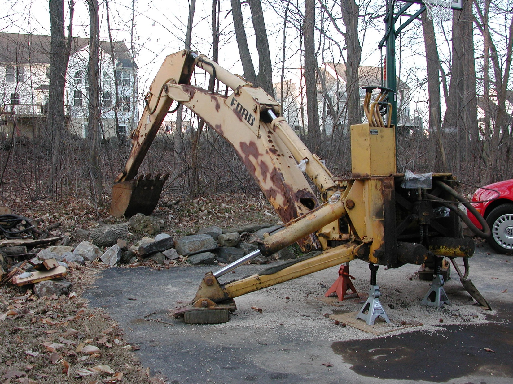

That big hyd line above is the feed for the hoe. I had to couple it together. The hoe itself has everything on it just like the detachable small tractor hoes except the seat. It uses the tractor seat and rotates.
And here is the hoe removed..View attachment 3886578
