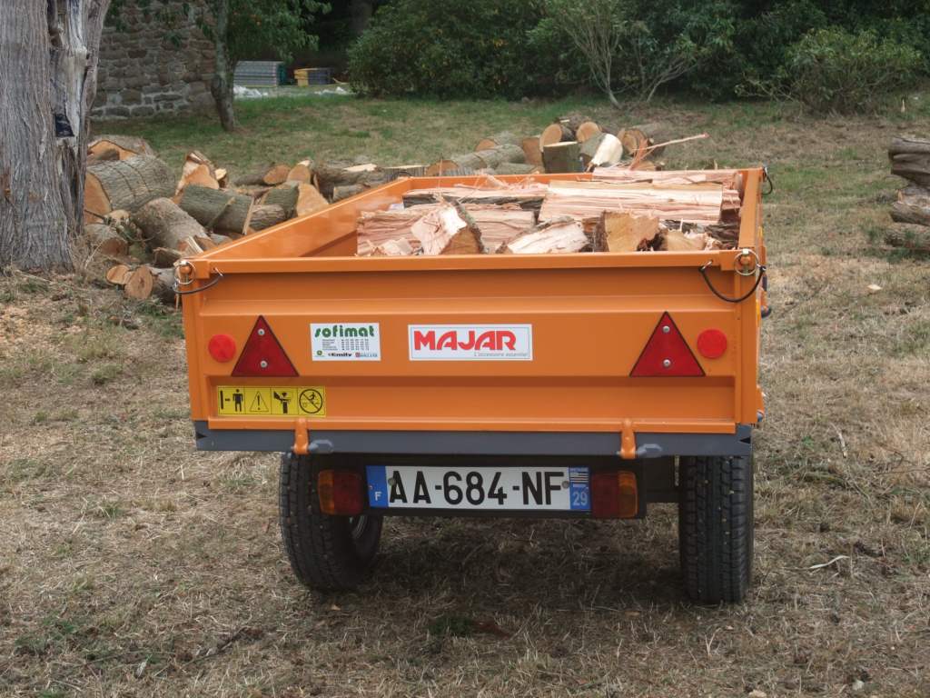

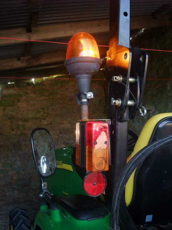

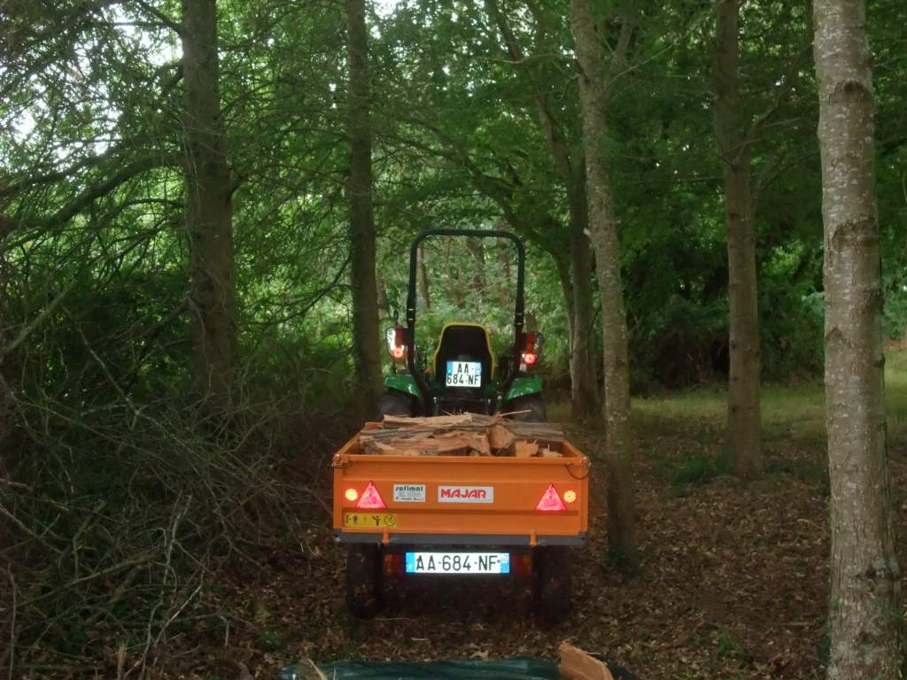

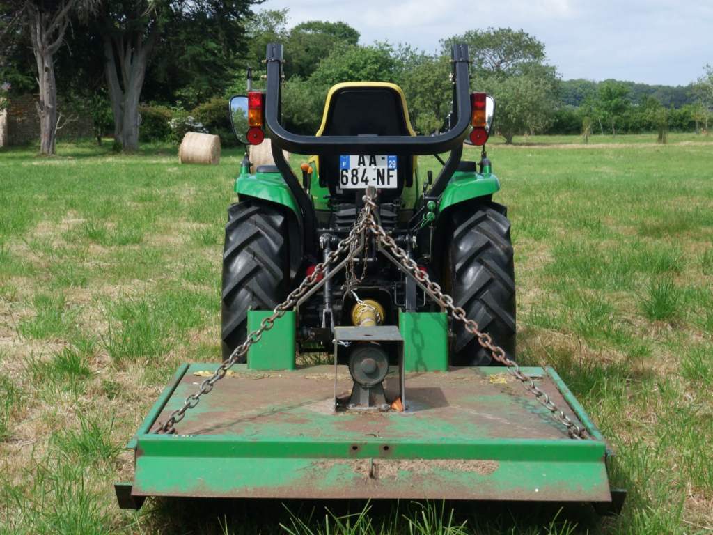

/ Registering a tractor in the UK #5
In France tractors are freely allowed on the roads if the design answers a number of specifications, hence the need for a certificate. They must apply the highway code : riding lights, brake lights, mirrors, blinkers, number plate at the back, metal plate showing the main specs and as slow unpredictable vehicles they have to show an orange strobe light. Light trailers show the same number as the tractor and, in most cases, do not require a specific driving licence.
