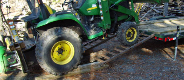

Eddie, finally got a picture of the ramps to load.:D
/ Refurbishing the Trailer #13
Thanks Egon. I was wondering how how that worked. My ramps are detached and a real pain to deal with. Your system is much better.
