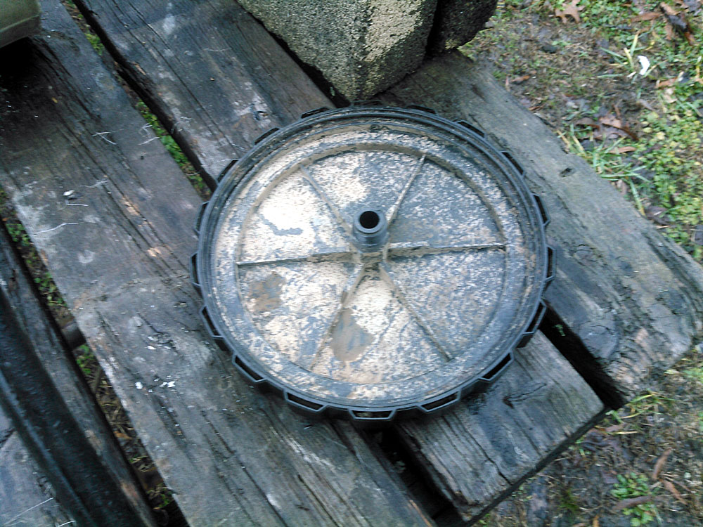

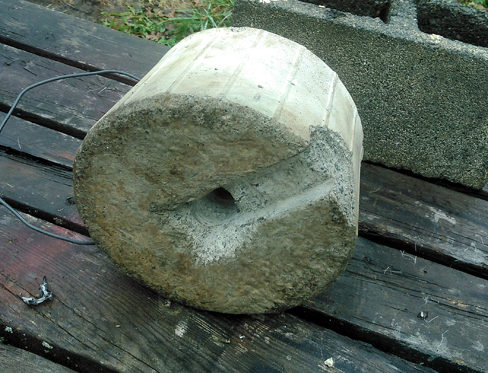

My aerator stopped working; I mean the compressor was still running, but the cauliflower of bubbles was not there anymore. I pulled it out of the pond to clean it and improve on it. I use a commercial membrane diffuser, I tried to make my own but the profi grade - mainly bubble size and overall performance - is impossible to replicate at home.
I had this concrete cast of a flower pot and it fits the aerator like a glove, all I had to do was to drill the hole and cut a grove for the tubing.

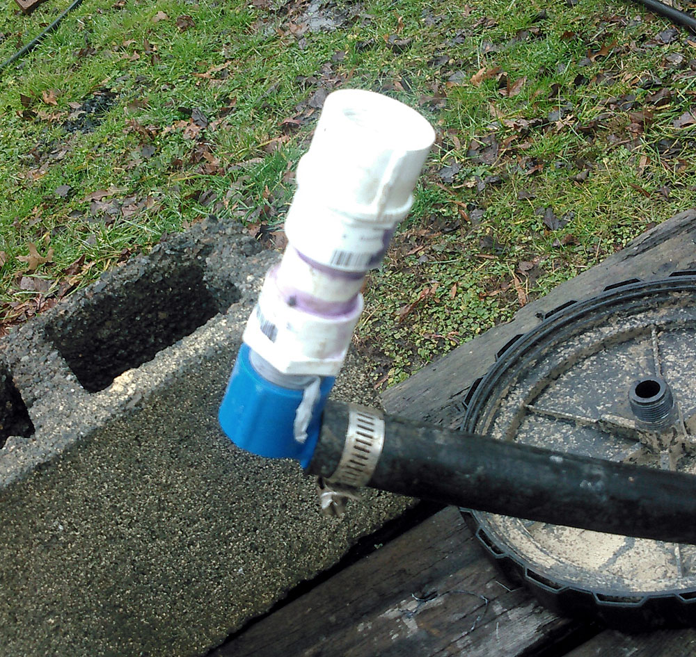

All the connections are 3/4" NPT.

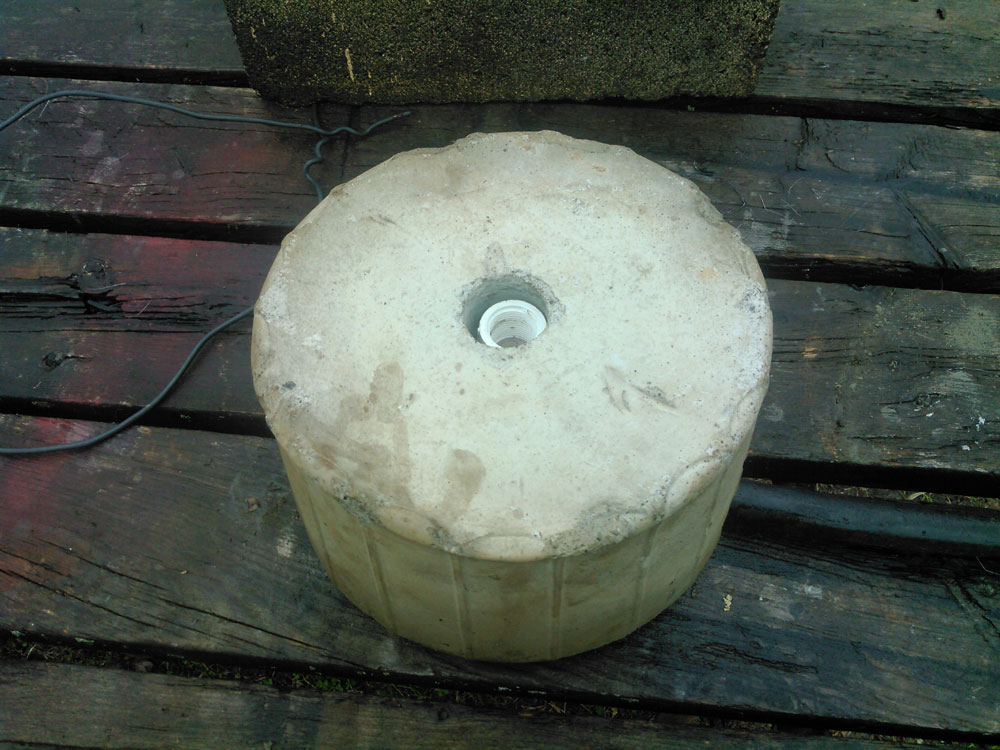

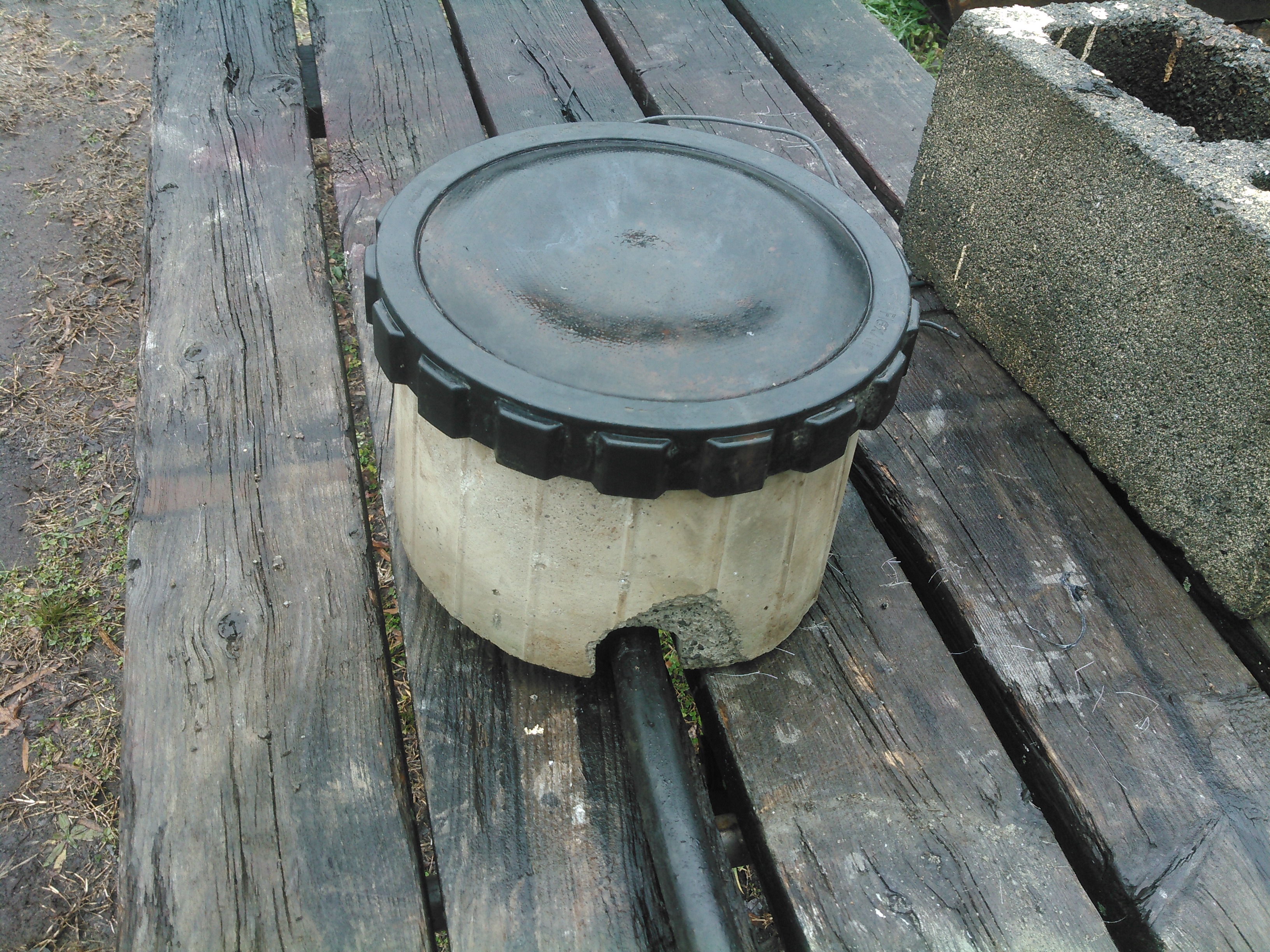

The diffuser itself screws in. Now I need to figure out how to sink it to the bottom keeping it upright.

/ Refurbishing pond aerator #4
My mfr says to set diffusers in a 5 gal bucket, weighted as needed, tho' my diffusers are ceramic vs membrane. Inlet screens for my 2" pump setup have always been set in buckets with a fist-sized rock for weight and the bails lashed to the hose to keep things in place. I can hook up to either one where they lay every few yrs, and the only maint is when a wire bail rusts, the screen/hose floats out, and I replace a bucket. (Getting 'em with plastic handles anymore.)
btw, I bought weighted hose (300') for the two underwater airlines. Advice NOT to set diffusers at the deepest point makes perfect sense when you understand why. Windmill is an American Eagle 18'.
I used bucket for 10 years, this seems to be cleaner solution. To weight down tubing I use three hole bricks.
/ Refurbishing pond aerator #6
Could you imitate a bucket handle with a poly rope and lower it with a gaff or on a rope with a hook.
'Yellow' (also white) rope floats and would be easy to spot or grab for future svc w/o having to pull up by airlines.
Metal anchors in the 'crete would corrode too soon, but a guy could tie up a 'basket' of rope with a few clever wraps.
I'd use 1/4" twisted polypropylene for all the above vs say nylon. (Both make good anchor ropes but nylon sinks & gathers more gunk over time.)
btw, props for a thread title that searches will find easily from anywhere. More folks will see what you've put together. :thumbsup: jon

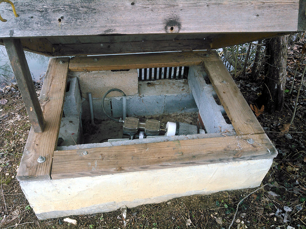

The compressor is housed right by the pond. I used to run water fountain from there too, but that thing died and I need to buy new pump for it.

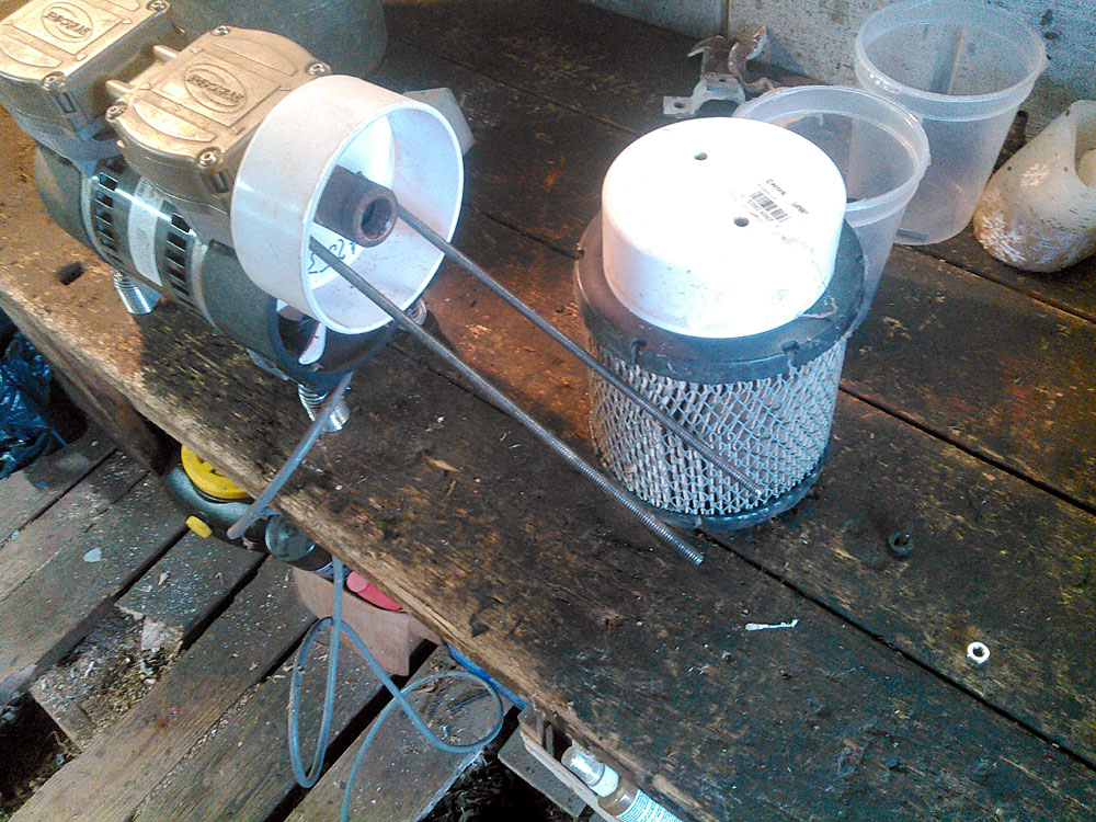

The filter needs to be replaced, but the plastic cap directly by the compressor is cracked, I guess the vibration done it in. I will try to sandwich it between some plates with rubber cushions.

You already had me thinking I'd want some kind of air cleaner for my windmill pump, as the air intake is just the threaded inlet of a check valve. Gotta keep the bugs out.

That's quite a bit of weight hanging way out there for that filter. Maybe mount the pump to a longer base that also supports the filter so it all shakes as one solid assembly. Or you could keep the filter assembly sitting next to the pump and not bolted to it, and connect it to the pump intake with a short rubber hose. Or, use a schedule 80 cap to replace the schedule 40 that cracked.
That's a pretty cool setup by the way. :thumbsup:
Thanks!
And thanks for the fresh eyes approach :thumbsup: Detaching the filter is a great idea, much better than my old solution.

Back in business. Seems like detaching the filter cut down on the compressor noise, too.

There you go! That looks like a much better setup to relive the stress and vibration.
