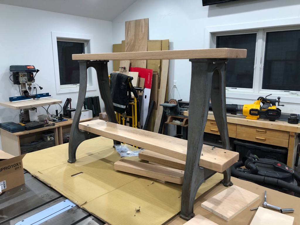

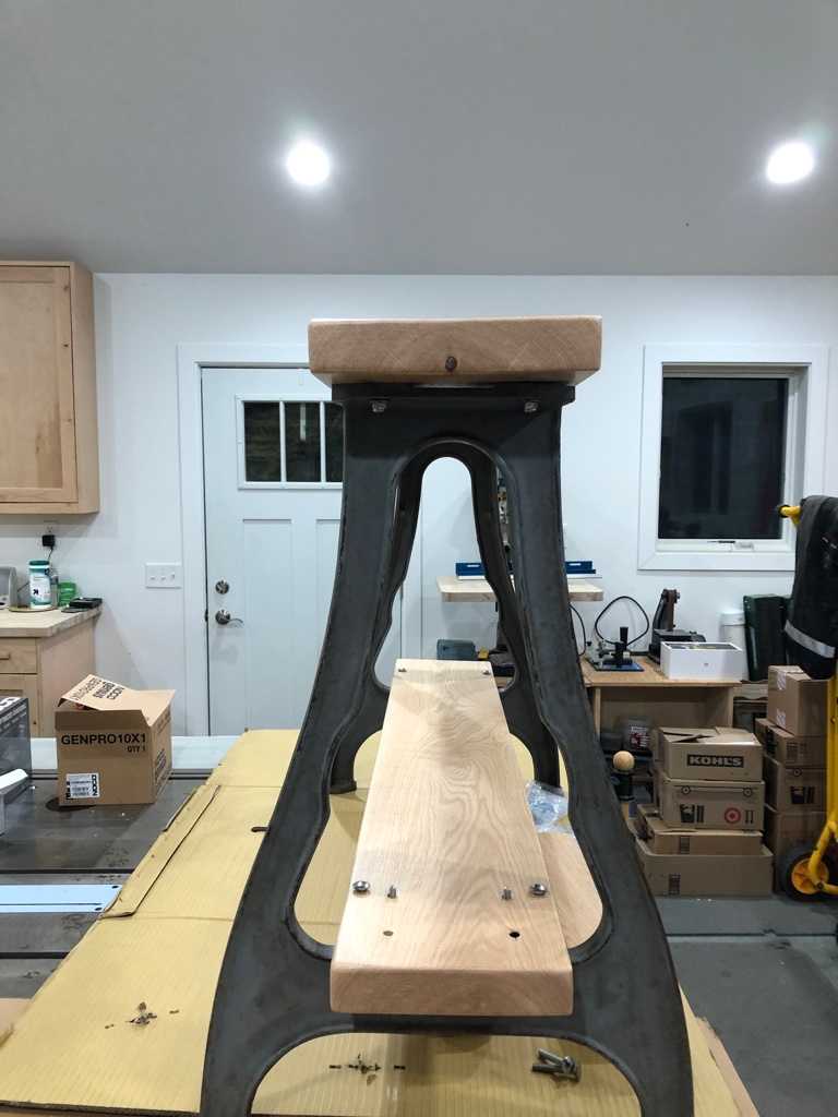

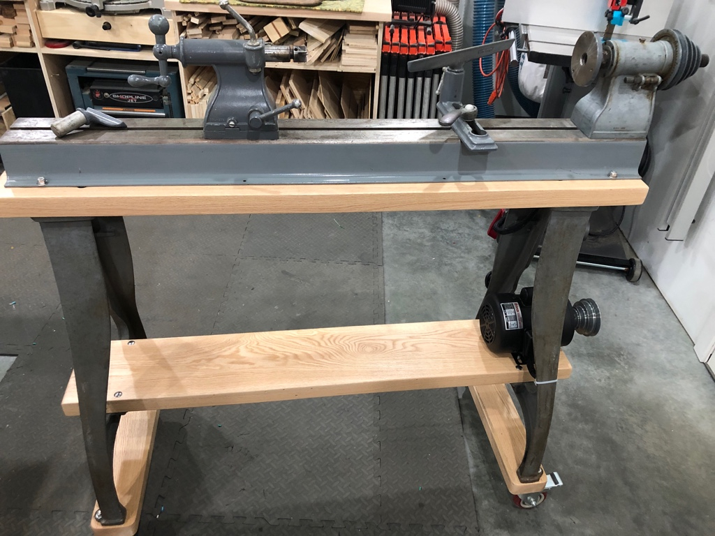

I purchased this antique lathe, then found an original set of cast iron legs for it. I built the connector planks and feet out of Red Oak cut and sawn from the location where my woodshop stands now. I purchased a new motor to be trouble free.

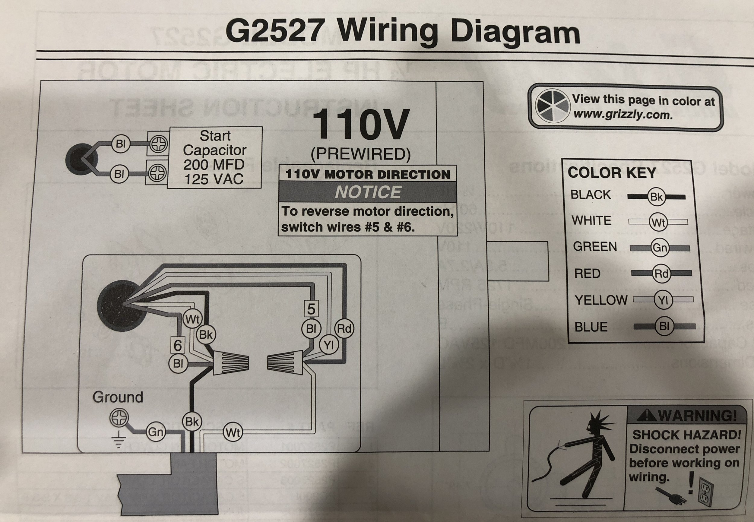

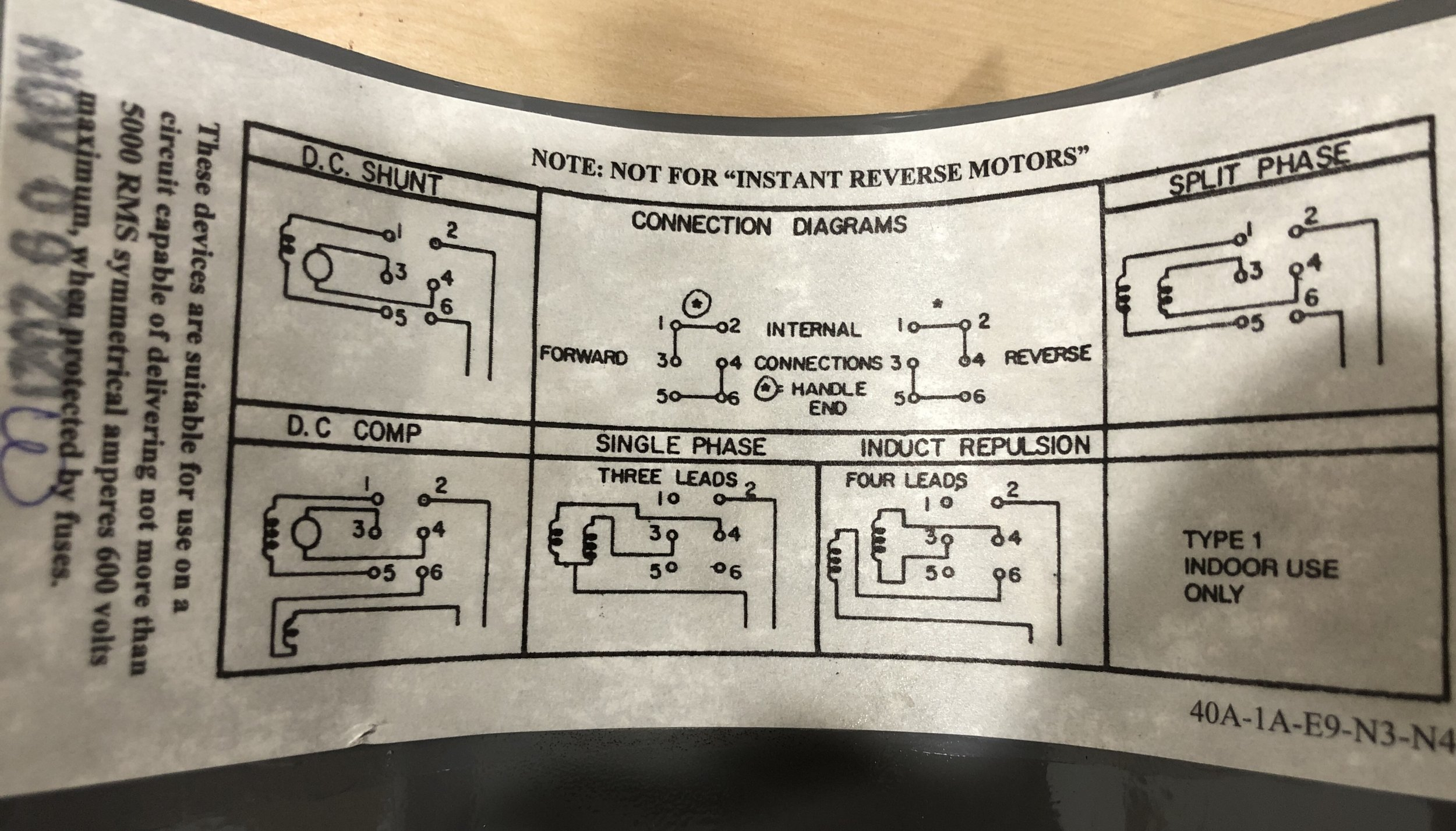

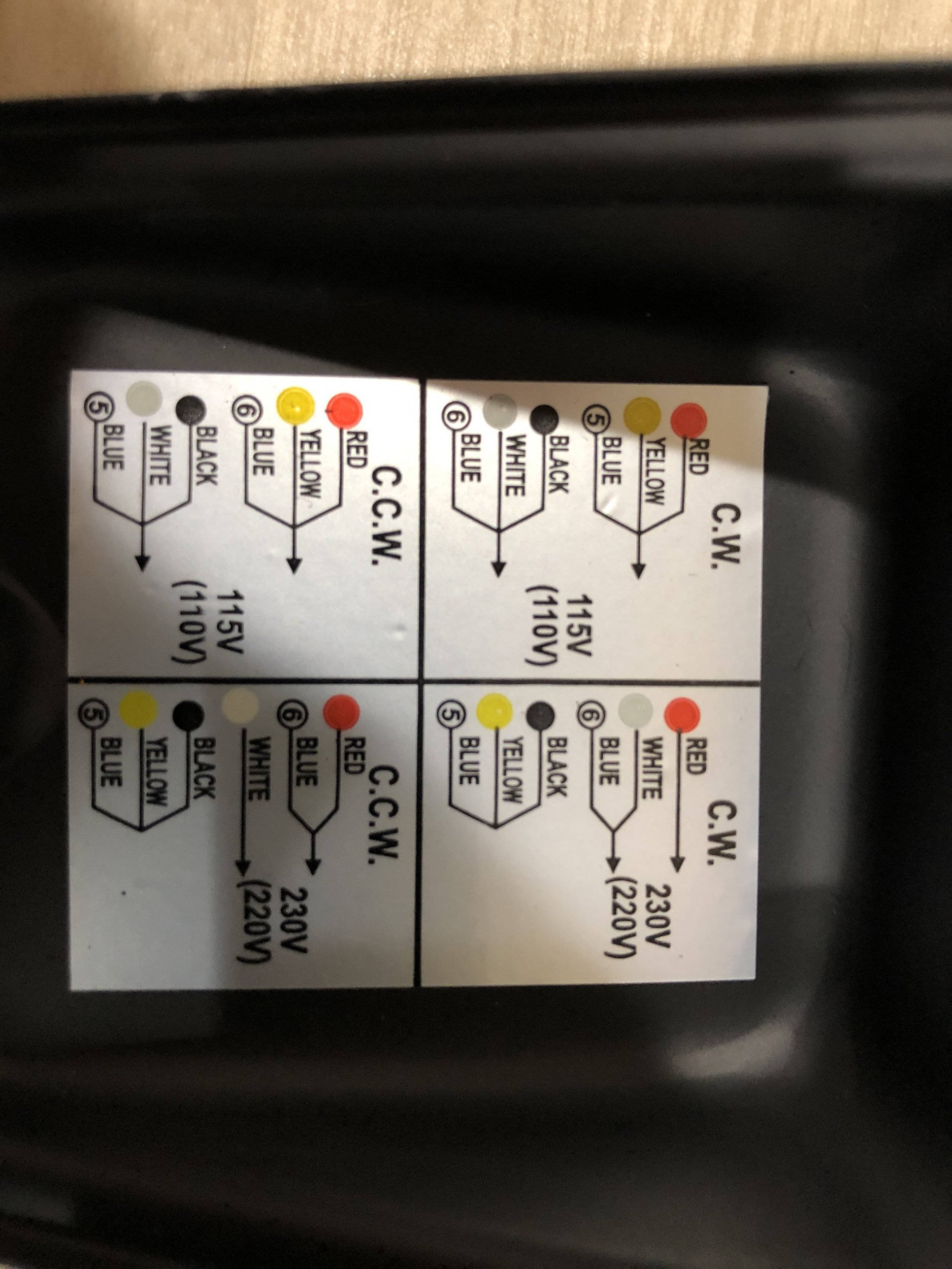

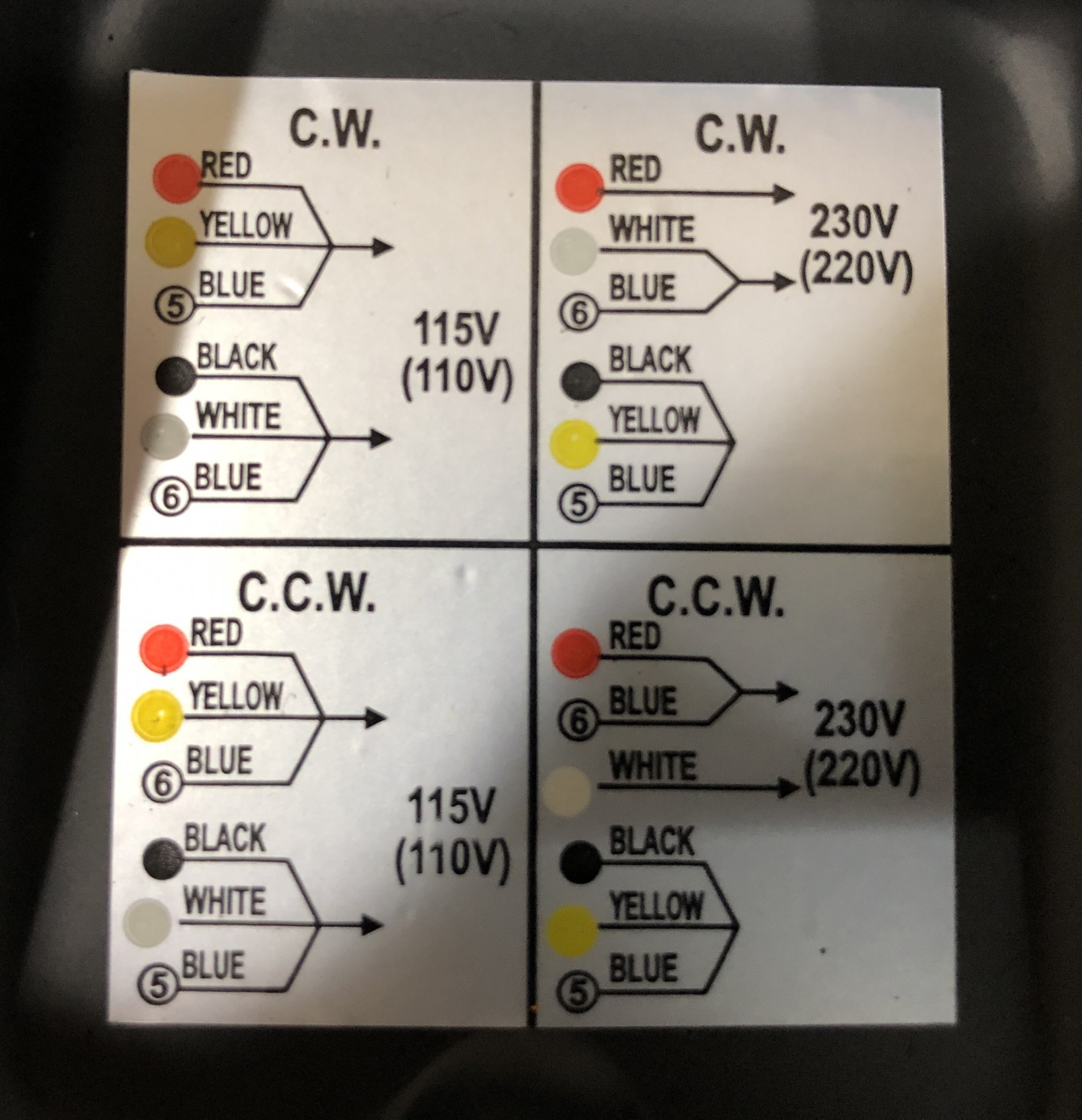

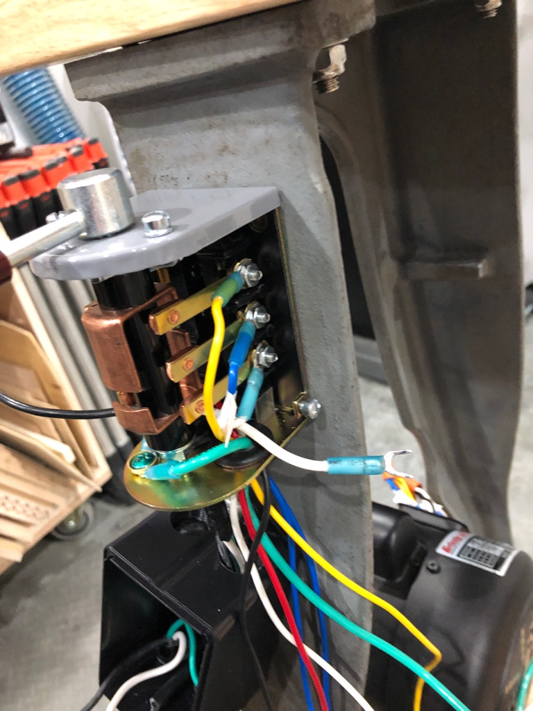

I’m having a heck of a time figuring out this drum switch. Just when I think I have it, nope, nada.
Has anyone connected one of these? It has to be so simple that I am really overthinking it. I have watch numerous YouTube videos and looked hundreds of wiring diagrams on Google’s image library with no better understanding or clarity.
Here is the motor diagram and I am using 110V.
Here is the drum switch for forward and reverse:
Thanks in advance if you can help me connect the drum switch to flip 5 & 6.

Good news!
You have all the info that you need, as you have motor and switch documentation. I find it easiest to start with the switch.
If you look at the connection diagrams, switch lead #3 and switch lead #4 are all that switches between forward and reverse, so for 110V, those need to be blue wires, i.e. motor lead 5 and the other needs to be motor lead 6. Put the red / yellow and black/white wires on the switch for whichever direction is "forward" for you. (i.e. CW=forward, 110V, red on switch #1 yellow on switch #2 and motor lead 5 on #3, with motor lead #6 on switch #4, black on switch #5 and white on switch #6.)
220V is simpler as three of the wires bypass the switch, (black, yellow, and motor #5, blue.), so fewer wires on the switch.
Clear as mud?
I hope that it helps.

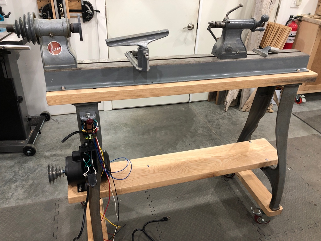

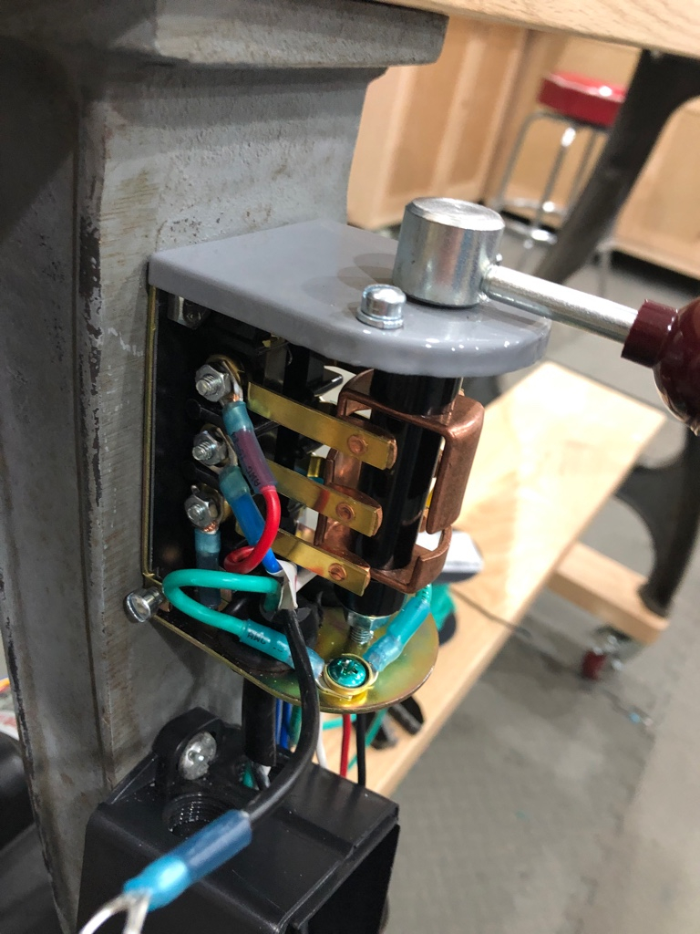

Thanks Peter. Really appreciate the help. Got the switch wired up like you wrote.
Now need to move on to connecting the power. No place to connect that makes sense to me.

Glad to help!
You made great progress! Nice terminal crimps and heat shrink.
If you look back at the motor wiring diagram, for 110V, you see that red and yellow go into one ac lead, and black and white go into the other, so on your switch, you put one ac lead on either red or yellow, and the other ac lead on black or white. Usually, I pick whichever side of the switch has the most room, usually the side away from the motor lead entry. (Like on yours, red gets one and then whatever color is on the bottom that side (black? I can't quite tell in your photo.) gets the other ac lead.)
The really important thing is that you don't want to have the AC leads side by side on that switch, or they will short.
Does that help? Just for the record, I am not an electrician and I don't play one on TV...

Glad to help!

Peter,
Thank you. Worked like a charm. The one thing I needed to do was individually tie nut each line at the motor. What is obvious to me now is… the way they are tied together in the picture below is if I did not have the drum switch.
You made it as simple as possible and I can’t thank you enough.
Awesome. Had to do a bit of super glue on the cheap safety switch housing. The screw posts broke off I put arrows to them glued back on in the picture.
So… will have to wait until tomorrow to post pictures of the finished product.
Thanks again Peter. So happy.
