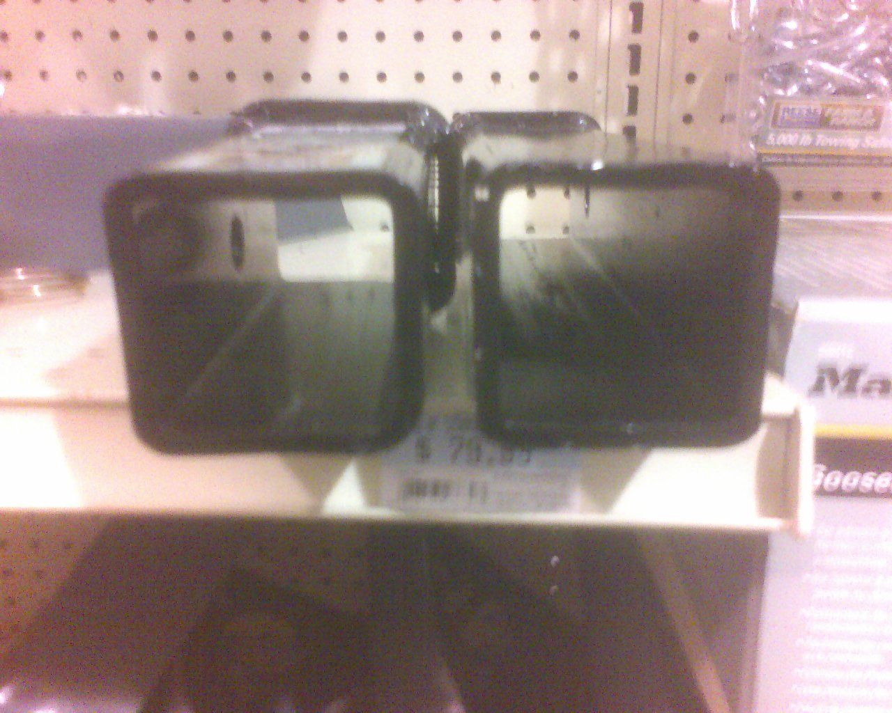

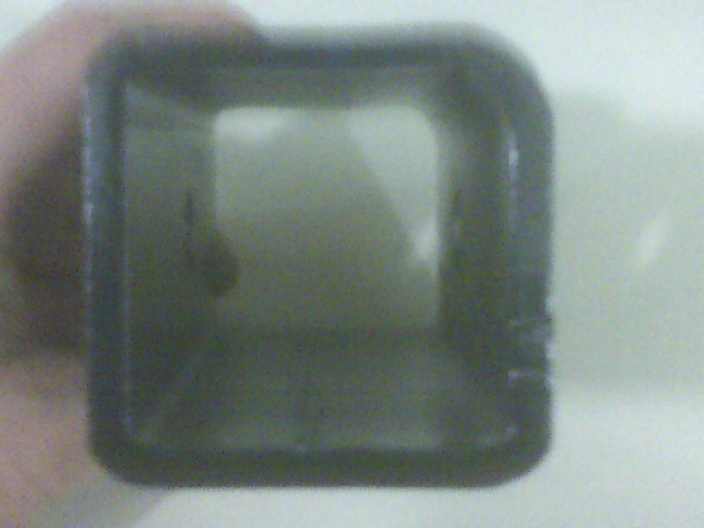

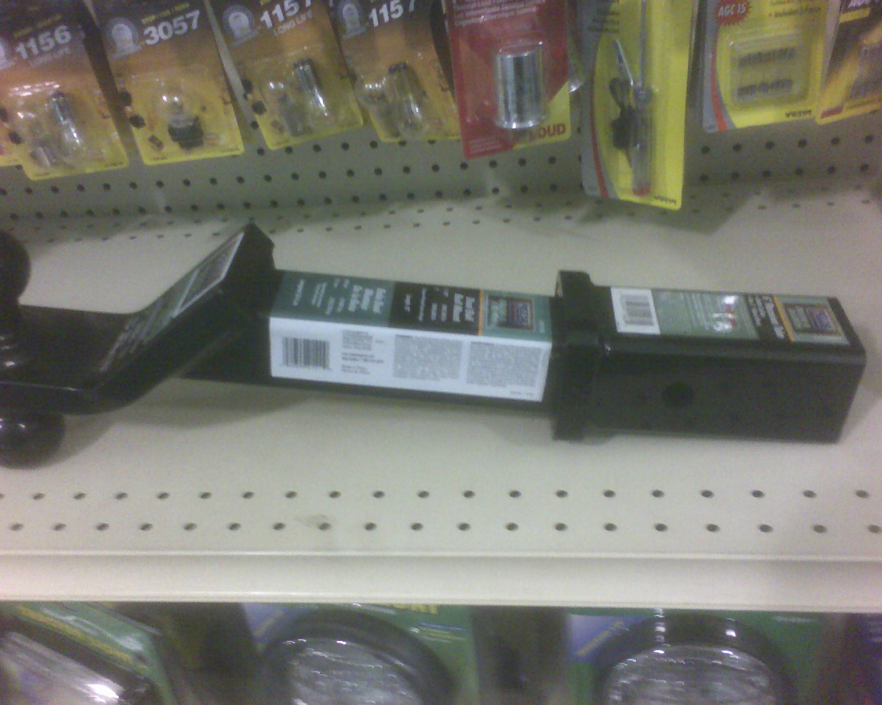

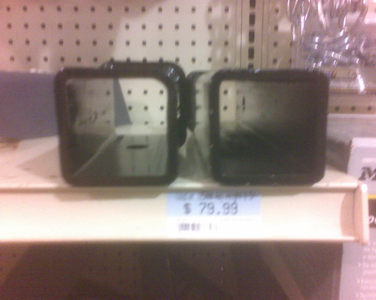

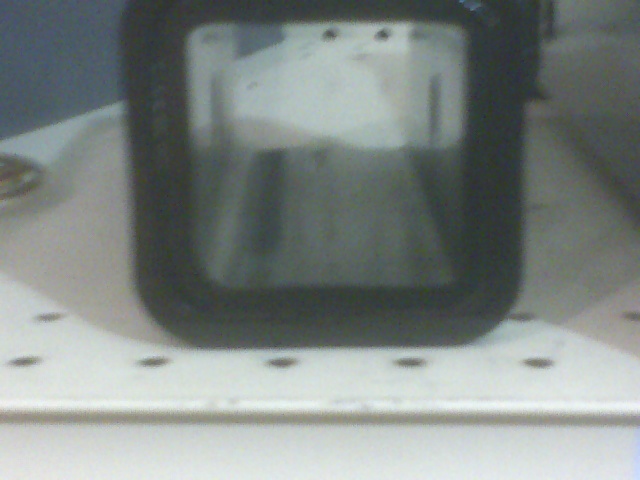

Went by TSC today to look at the receiver stock like I bought. Yep- made in China. Tried a test fit and lo and behold some of the Reese drawbars will not go in the Reese receivers. In fact I got one stuck about an inch in and couldn't get it back apart:D:p
I took some crappy (really crappy!) cellphone pics below. Notice the radius of the internal corners in the tubing. Look closely at the 2nd pic upper right corner of the tubing:eek: The one I bought was nowhere near this bad, but still wouldn't accept some 2" drawbars.

I've explained in previous threads that receiver stock isn't a common thing in steel yards. No steel yard locally has it in stock. The 2 in sq tube for the drawbars, yes they have that, and I have most of a 20' stick of that out in the shop. Proper receiver stock has a .238 wall/rounded corners and is flash removed on the inside.

I had a similar problem with the cheapie HF receivers, but this was due to the seam on the inside of the tube. Took a big, long flat file and worked on it until the drawbar went in.
