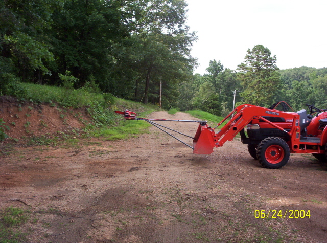

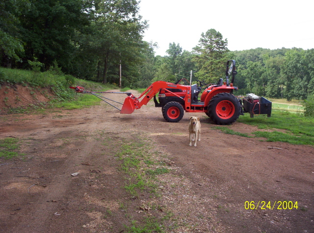

Some of you guys have seen this before, I had it on another site.
The saw is electric. The pole is about 8 to 10 feet, and I can tell you if you just turn your wheel a little it well move that saw a lot!!!!
The base plate is spring loaded side to side and on the down pressure.If it wasn't it would brake it right off.....been there.
After I done the base plate it works very will and real safe. There are 2 Co. making them now and if you search you well see they are new Co. started after the date on my pictures.
