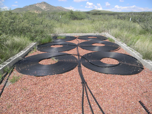

Here is mine. It will heat the in ground pool to over 90 if I put the cover on at night. Without cover it will get to about 80 or 85. It needs some weed control.

That's a nice one Jim! I bet if you put landscape fabric, or tar paper under them it would not only control the weeds, but a black background will help produce more heat. We don't exactly get the same sun/ heat as you do in Az. LOL

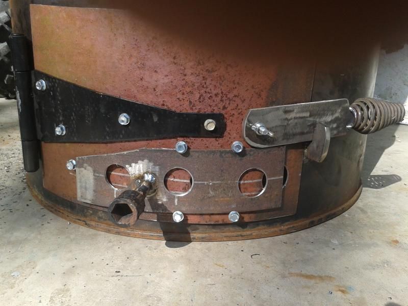

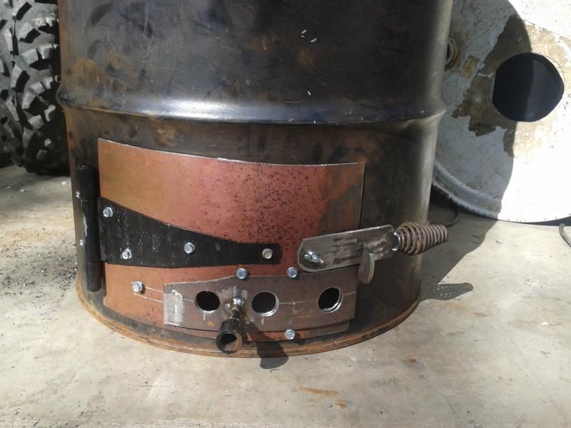

Got her done yesterday
Expanded steel for the copper coil shelf
The inlet gauge isn't accurate, either the run of hose or the radiant heat from the barrel must be effecting it... the pool water at this time was 22C, so that's a gain of 28deg!!!!! 50C didn't last long, but 45 was pretty steady.

So I didn't build the diffuser plate off of the lid, or installed the chimney braces. I was in a hurry to get this going. Yesterday was supposed to be the only "nice" day of the weekend. I may still do the diffuser, but the chimney I plan to add another length to get a little better draft and keep the smoke out of my face. Also, I think the plan will be to remove it between uses so i can cover the unit with a tarp instead of the original plan of storing it in the shed. The last improvement is to set if up on cinder blocks. Probably 3 high. Make tending the fire a little more user friendly. LOL

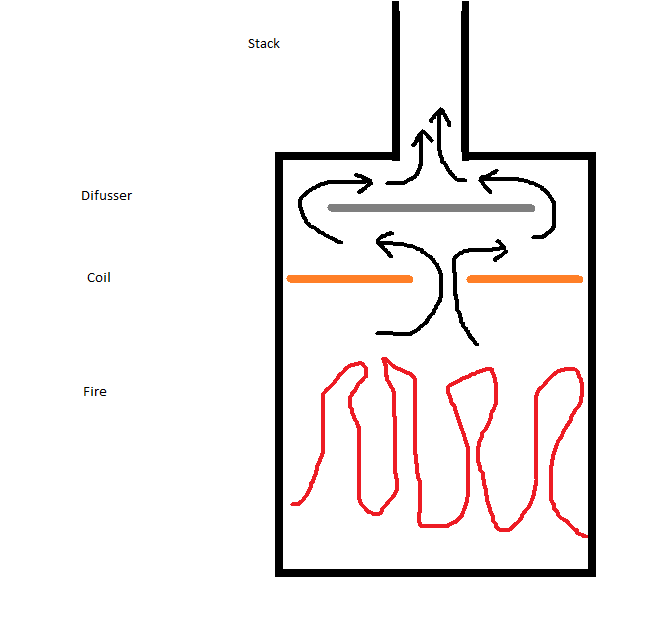

Sure doesn't stay pretty after a fire
Made the baffle. It sits aprox. 4" below the lid, 4" above the grate, and leaves 4" all the way around
Guess what this is going to be! :)
...also picked up a 3rd length of chimney.

Had a wood fire in it last night. It seems the baffle made a significant difference! 5-10 deg better output.

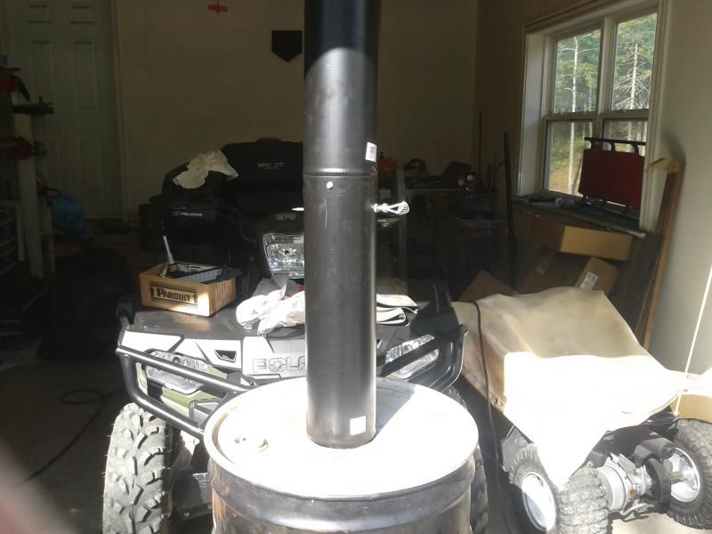

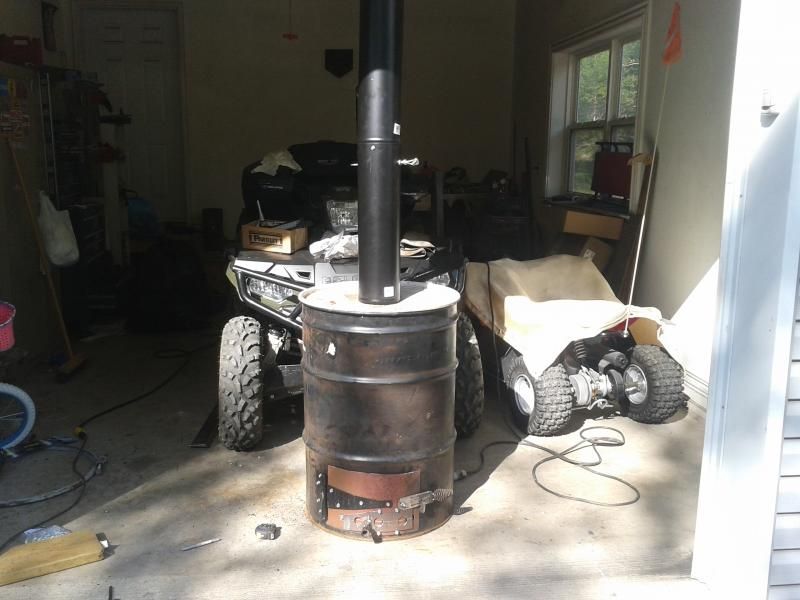

I was lucky enough to get some insulating contractors make me a blanket for the top of the barrel. I'll have to cut another slot for the outlet. No biggie
Found another old blanket that we'd thrown out anyway... bad idea trying to put it on hot. LOL I'll do a better job later.
Also scrounged a length of 6X2"
Cladding to come later. Also working on a bigger door. Keeping a steady 60deg output now without too much stoking. Used to be 45. Small changes are making a significant difference. :)
