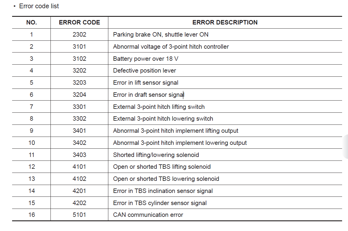

I have a 2013 Branson 6640. I was doing some field work and hit a hole with tire. The red light on dash began to flash. I have inspected tractor and nothing obvious is wrong. Tractor runs perfectly fine but light will not go off now. Any ideas why light is flashing now? Thanks

Ok I got some stuff figured out. It's throwing 3204 code. Which is "towing power sensor signal error". Now a fix for that is needed. I unhooked battery and hooked back up and code is still flashing. Tractor still running great. I'm assuming a new sensor will be needed. Any advice on were this would be located would be great. Thanks
   / Red light flashes #5
Error 3204 refers to the Draft control sensor:

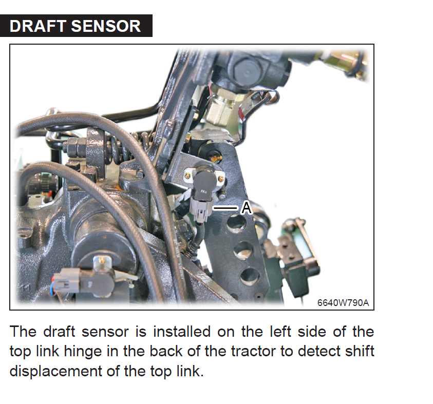

The draft control sensor is located on the left side of the top link mount. You may want to check for damage wires, plug and etc before throwing a sensor at it:

Looks like my wire wise is in great shape. I did locate draft sensor unplugged wires and reinstalled. No sign of damage or problem with wires or sensor. If I replace sensor will I need to reset computer to get rid of code and flashing light? Unhook battery or pull a fuse maybe? Thanks
