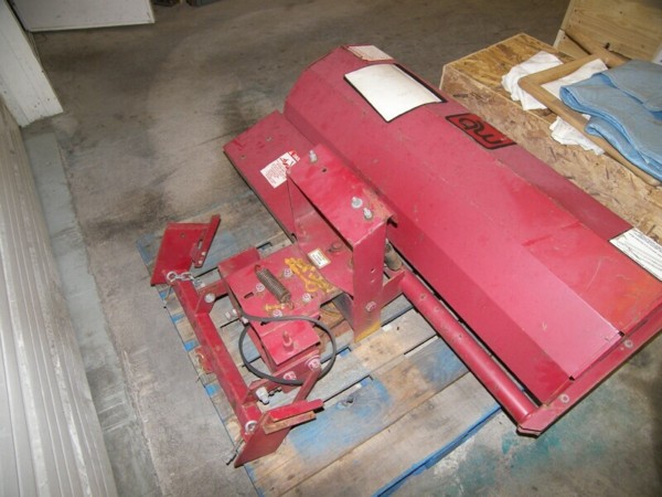

According to the parts manual the company does offer a hydraulic lift cylinder, not needed, and a angle hydraulic cylinder. I emailed the company about the cost of replacement brushes and they responded promptly. The answer was $140 for poly and wire. I will send them an email today to check the price of a cylinder.
The cylinder connections are in place so it would be easy if the price is right. The manual angle is very easy. Pull one pin and push.
Dale
If the manual angle is that easy, I wouldn't worry about it; however if you make note of the size of the connection and the shortest and longest you need to be, you might stumble across a great bargain.

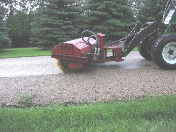

As far as the reverse, when I installed my reversing valve, I used manual spools so I ussually don't give the power rake near full pressure in reverse.

Purchase sweeper on ebay. $280
I like the Red Green reference...so how many rolls of duct tape did you use in the project?
I also have an angle broom that does a great job of removing up to 3 inches of snow in the winter...you'll get good use out of it.
Dean

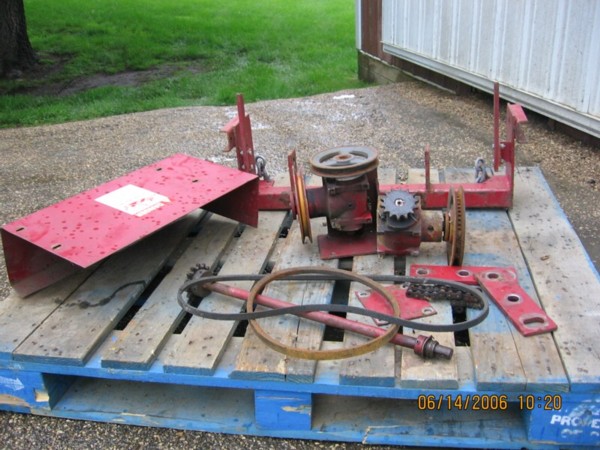

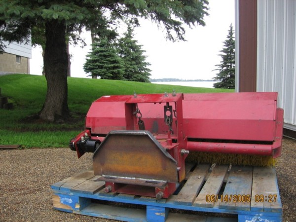

Looks like your sweeper does a great job with the snow. The company that makes the sweeper wants $300 for the angle cylinder. I found one that will work at Hydraulic's parts surplus center for $82. My intention was to keep the cost under $500. I am still debating adding the hydraulic angle.
I did use duct tape to make a motor bolt pattern to drill mounting holes.
How far down do you wear your brush before you replace it?
Dale
