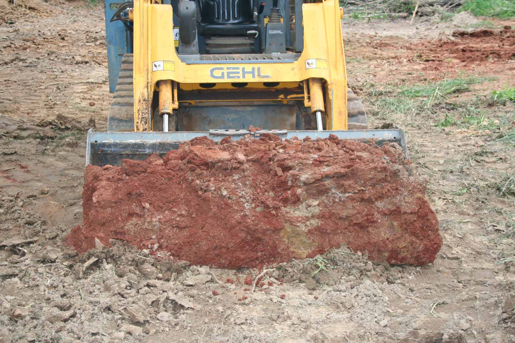

OK, maybe some pictures will help quantify what I am looking at and trying to decide on.
I want "red Clay" or whatever you care to call compactable stable stuff to put in a hole and build on. Rock would be nice but would get a tad expensive fast.
5701
Red Clay, mixed with a bit of Yellow clay, and some Gray (Grey) which is also called "Guthrie soil" here. Guthrie is a small town just north of here with notably terrible soil that I happen to sit on the line of where Guthrie soil ends (my backyard) and red clay starts (my front yard)
The question would be are these traces of other soils in with the red acceptable?

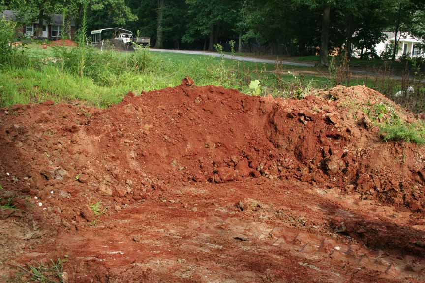

5703
The pile I happen to be moving at the moment, but really the question is generic as I go to other places and pick up and evaluate where I want to put it. Pretty clean red in center, Little mixed on Left and what I call Mid soil which is not good top soil but not good clay (what I have a lot of) on the right.

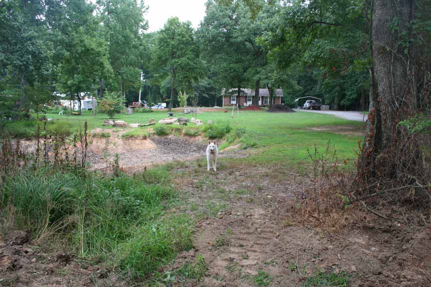

5707
The inspector came out to catch some frogs :)

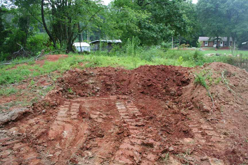

5719
Pile again, Mixed on Left, Decent in Center and mid soil on Right.
Eddie, yes, I am very familiar with top soils and what I refer to as "mid soils" which are the soils of the area from around here that are not clays, but not really the nice rich in organic matter soils that you want as top soil. Unfortunately I have a couple inches of top soil, then lots of mid soil, then depending on where in the yard you are, either Guthrie soil or Red Clay base, sometimes pockets of each.
On our large construction projects around here, (and I assumed in other places but really have no experience to base the thought on) they will come in and pull off all the top soil and pile it, then pull out the mid soil's and pile it separate, often called the trash pile, then haul in clay to grade, then dress after completion with the top soil. The mid soil they will use to fill something like a sports field or something where there is no intention of building anything as it will not compact and firm up.

Oh, and when I drop that clay in the picture into my shop hole on top of the existing red clay, the new stuff looks more brown then red where in the front yard it looked red as could be against the brown backdrop of the other soils.
