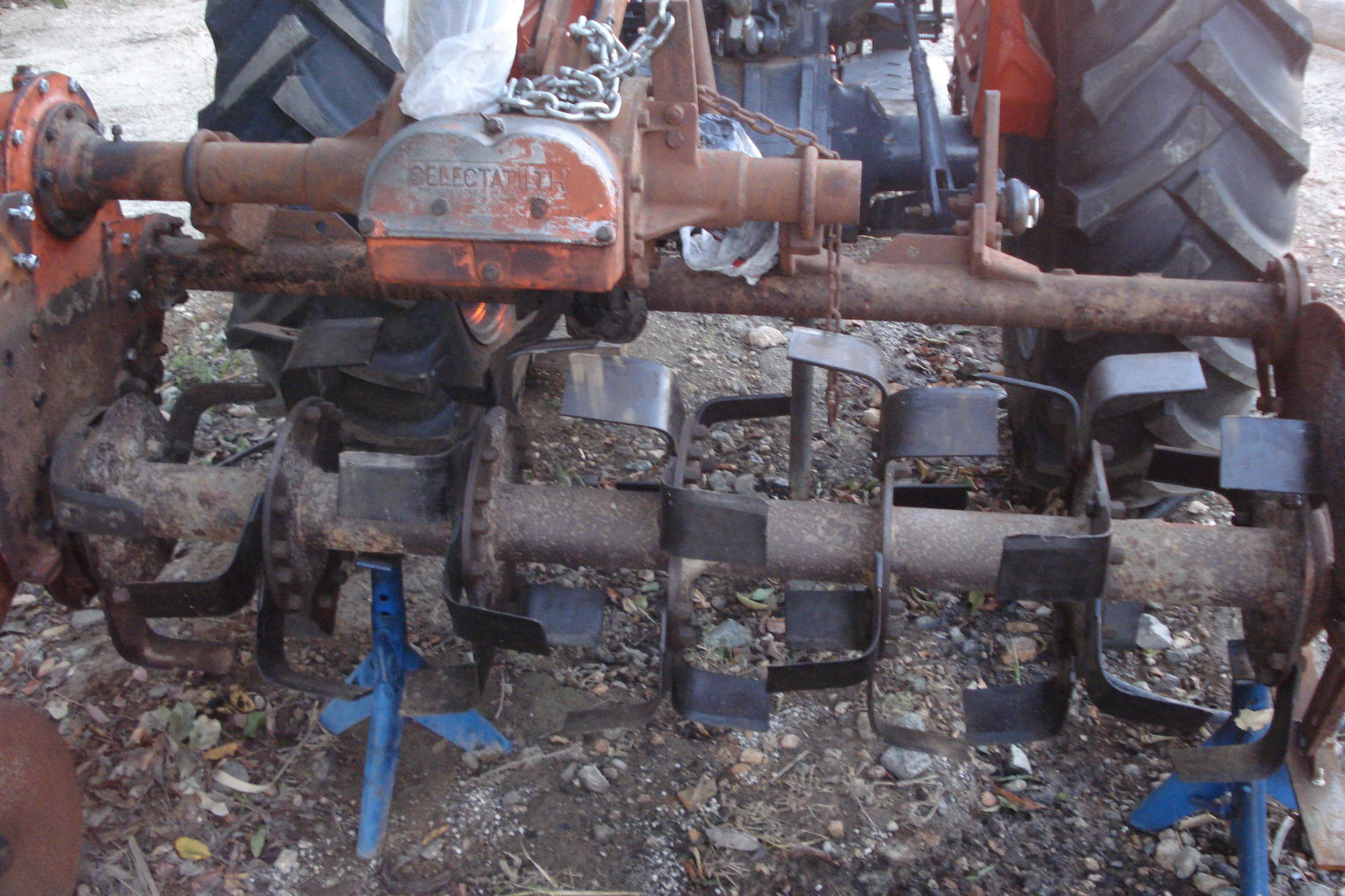

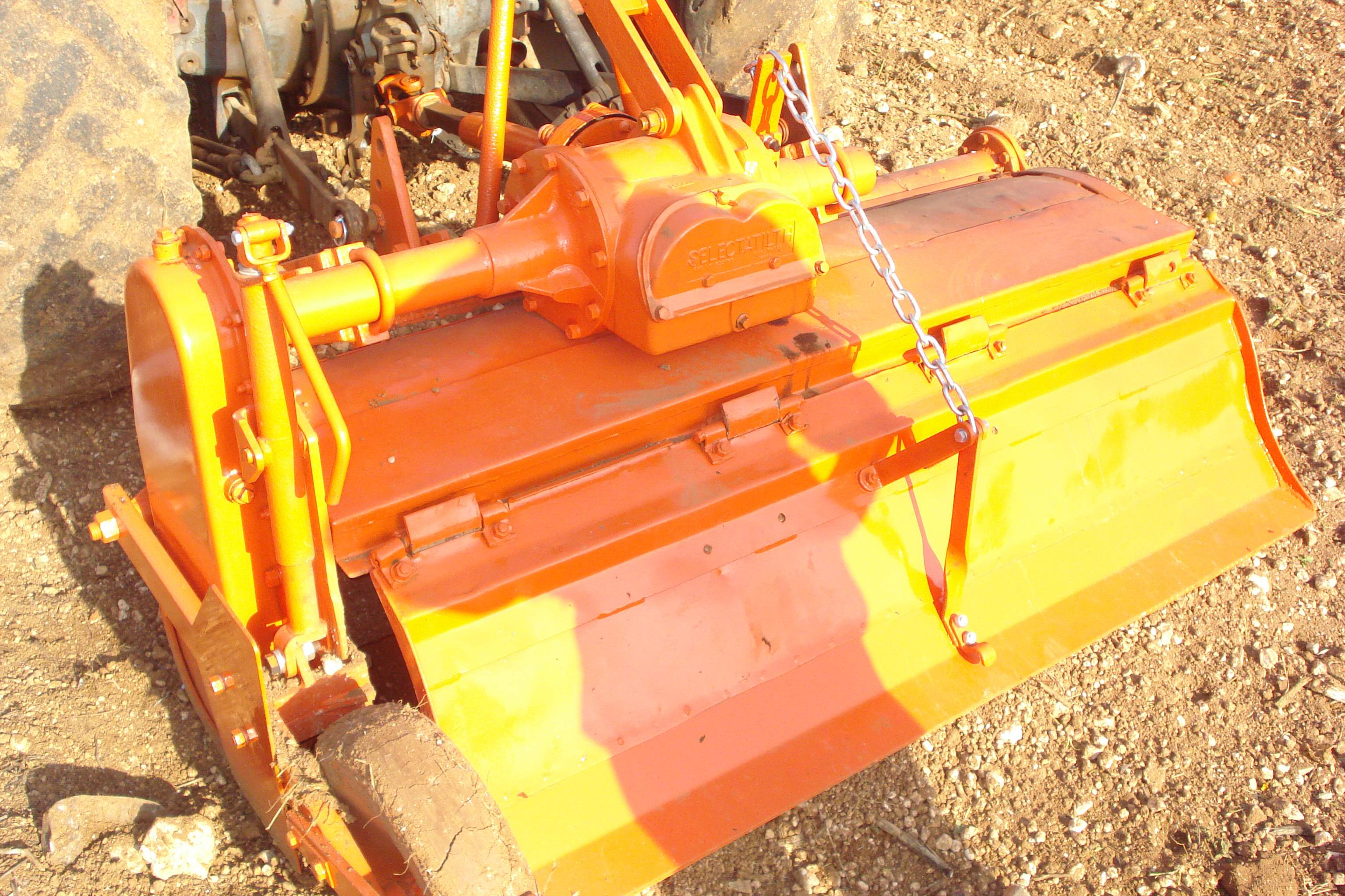

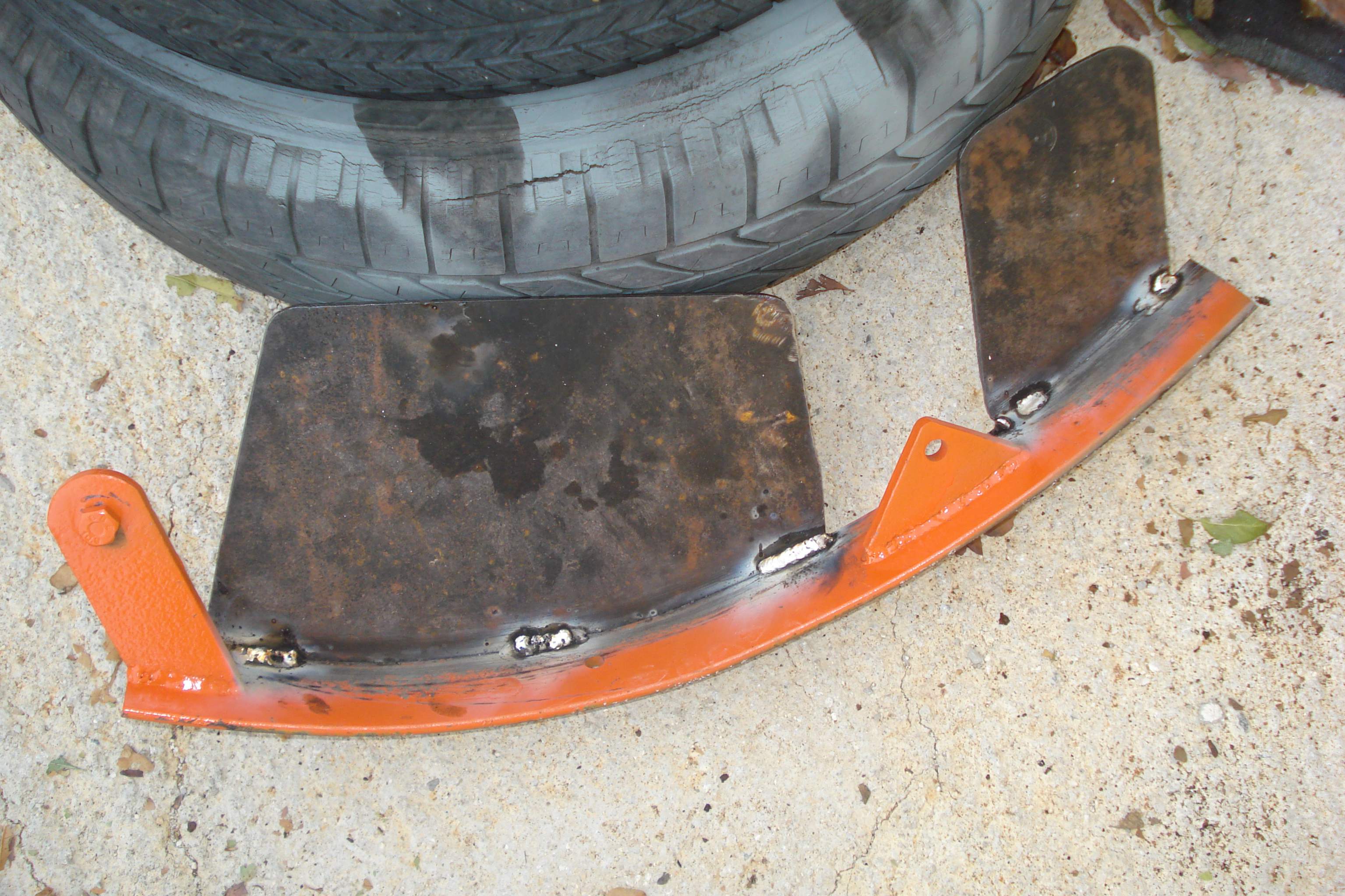

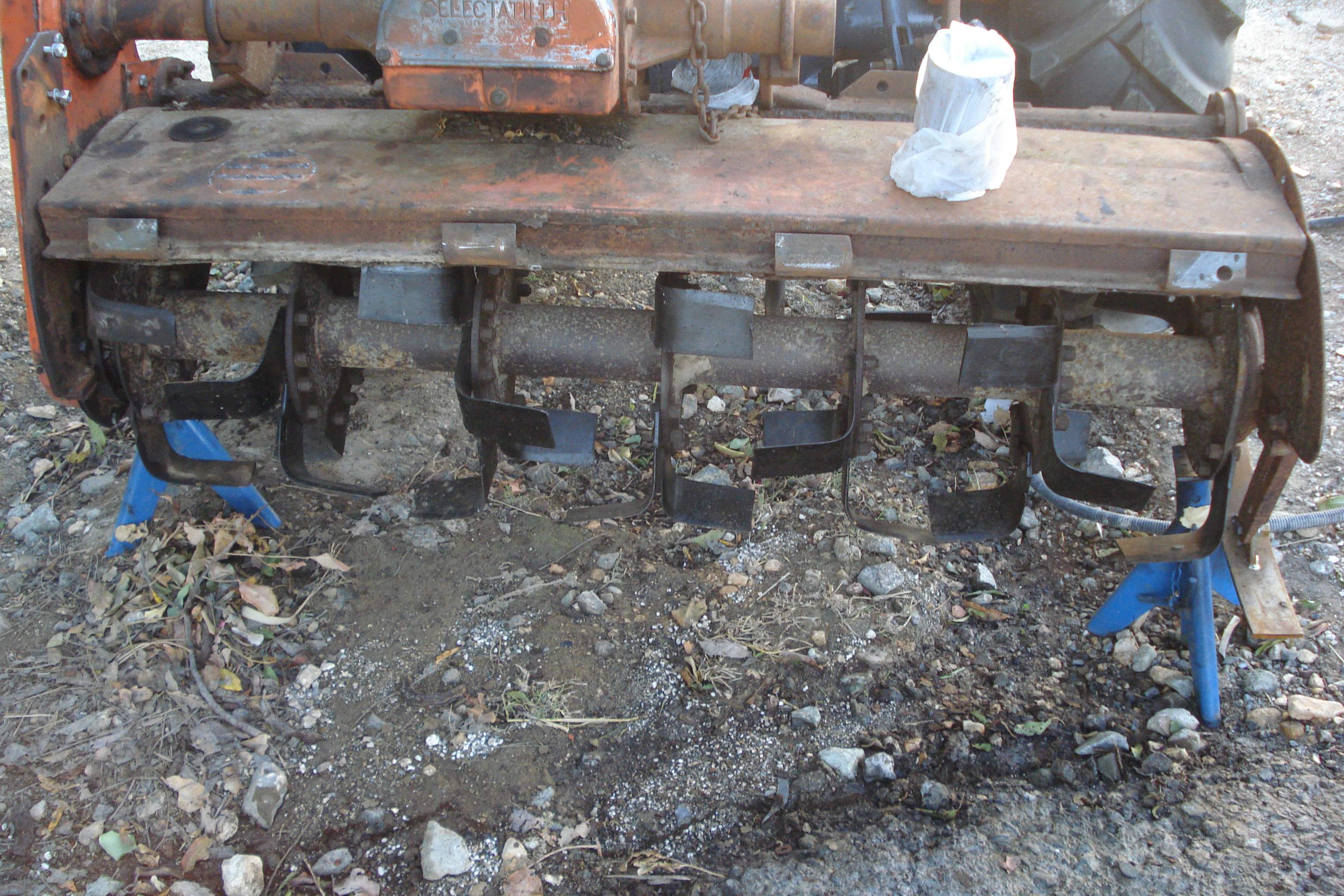

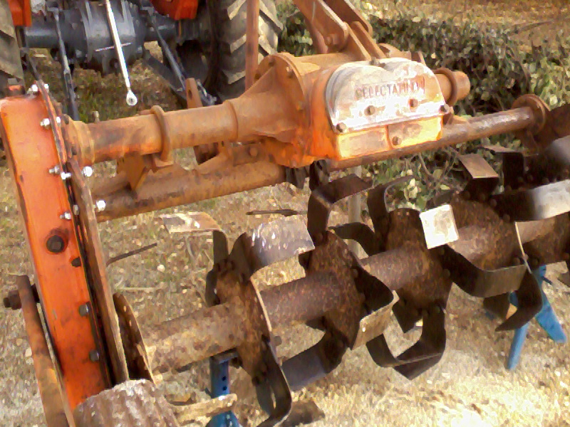

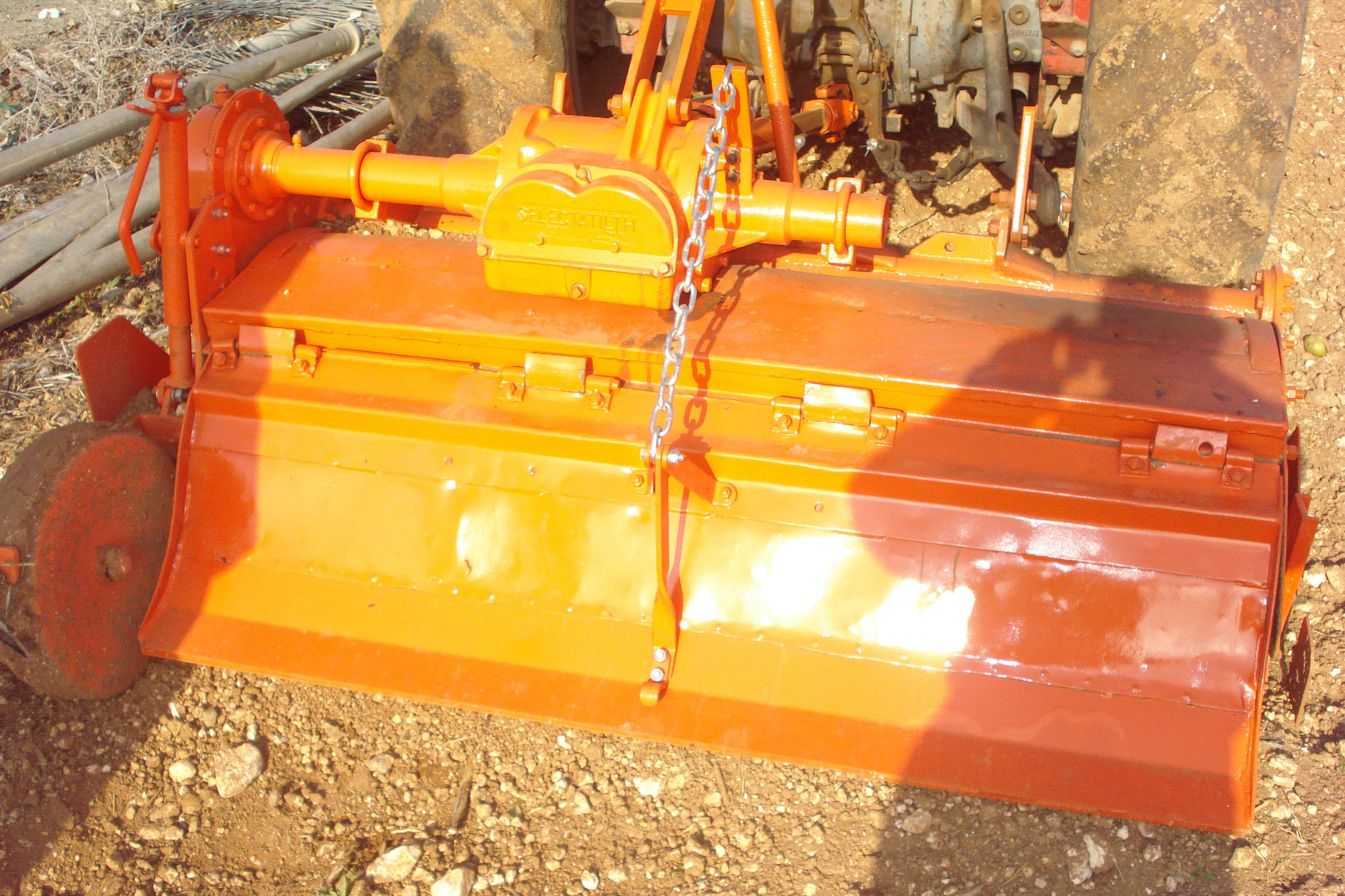

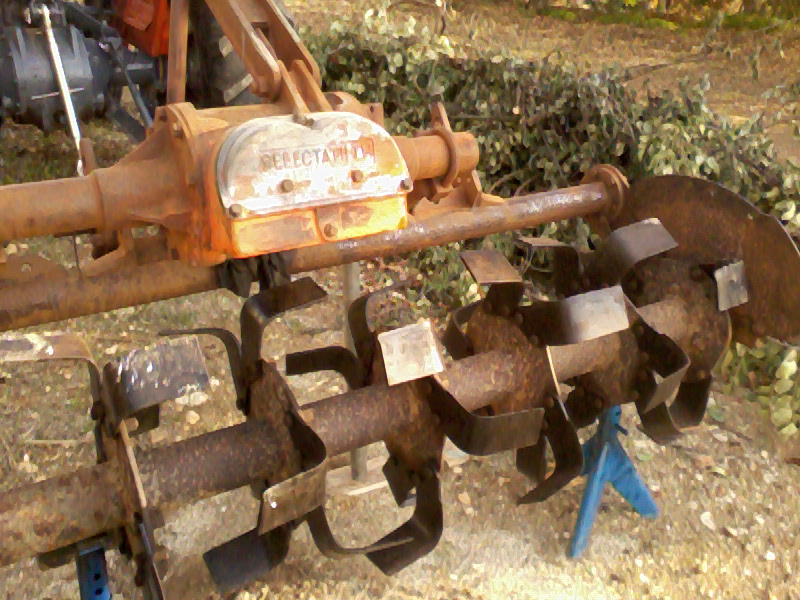

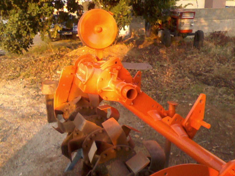

hOWARDCHAINCOVER.jpgHi all, just finished reconditioning a Howard tiller E60 (60" working width).

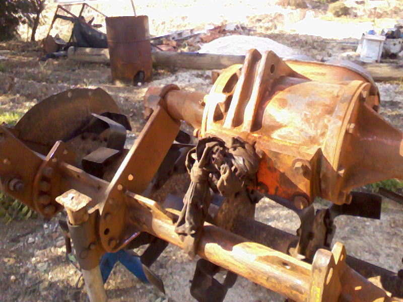

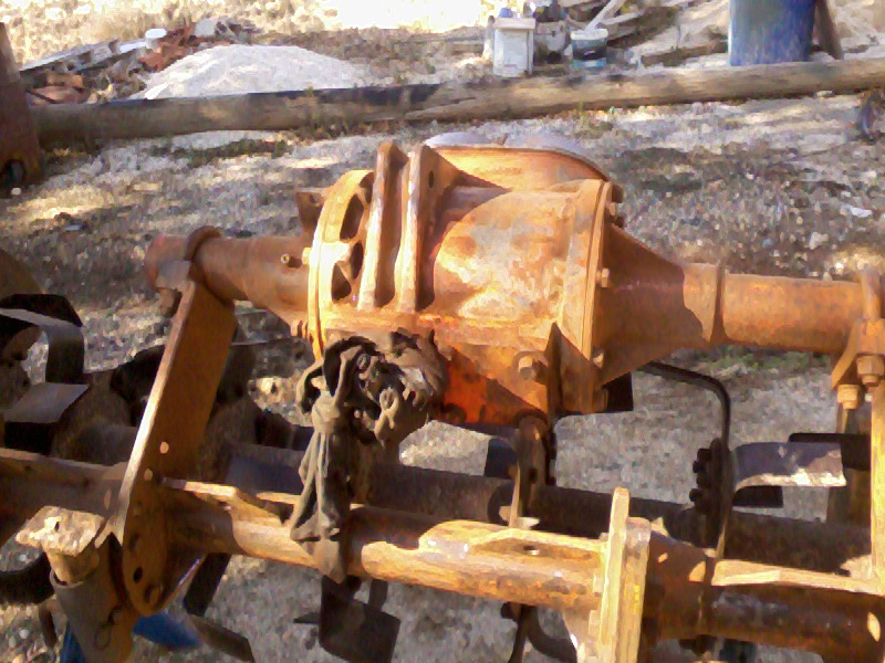

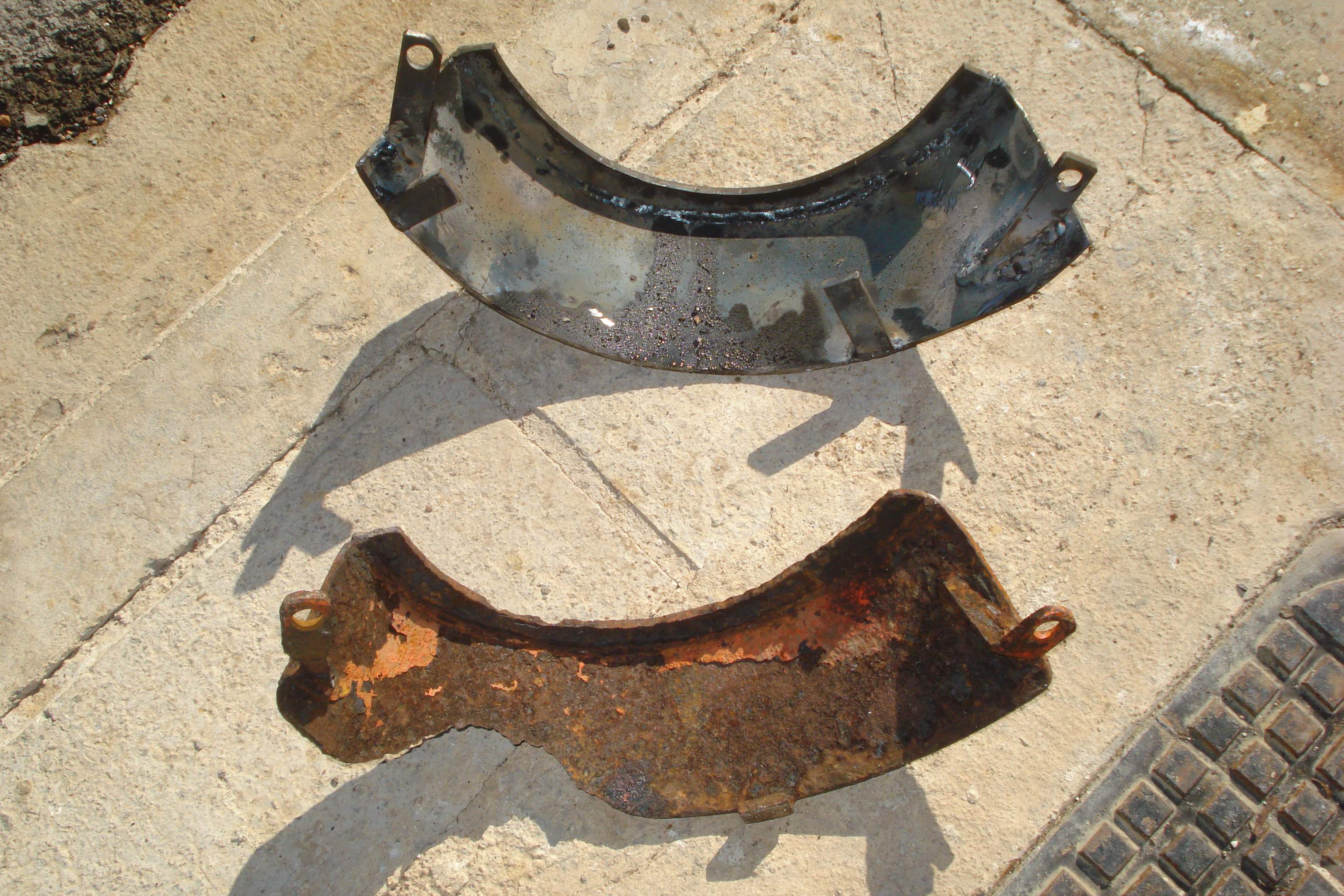

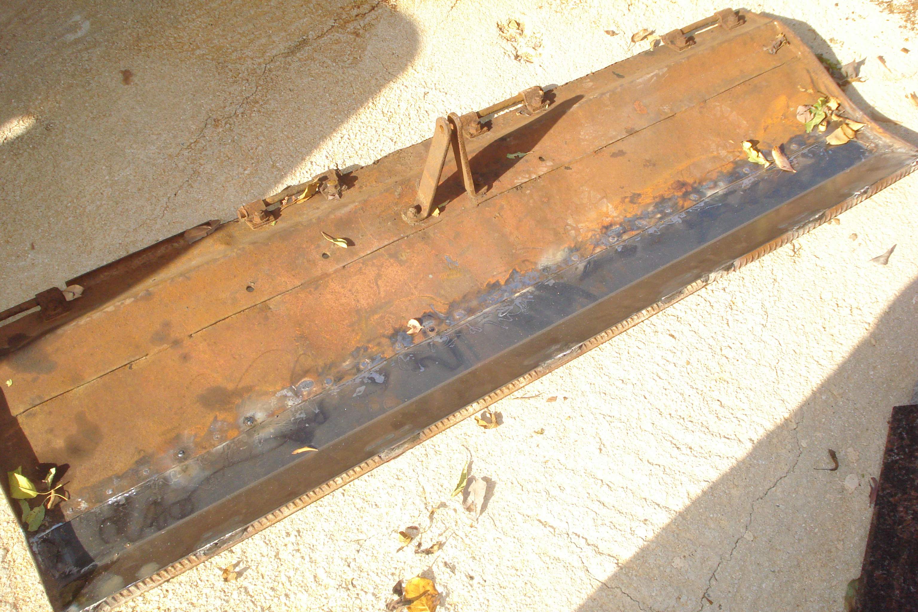

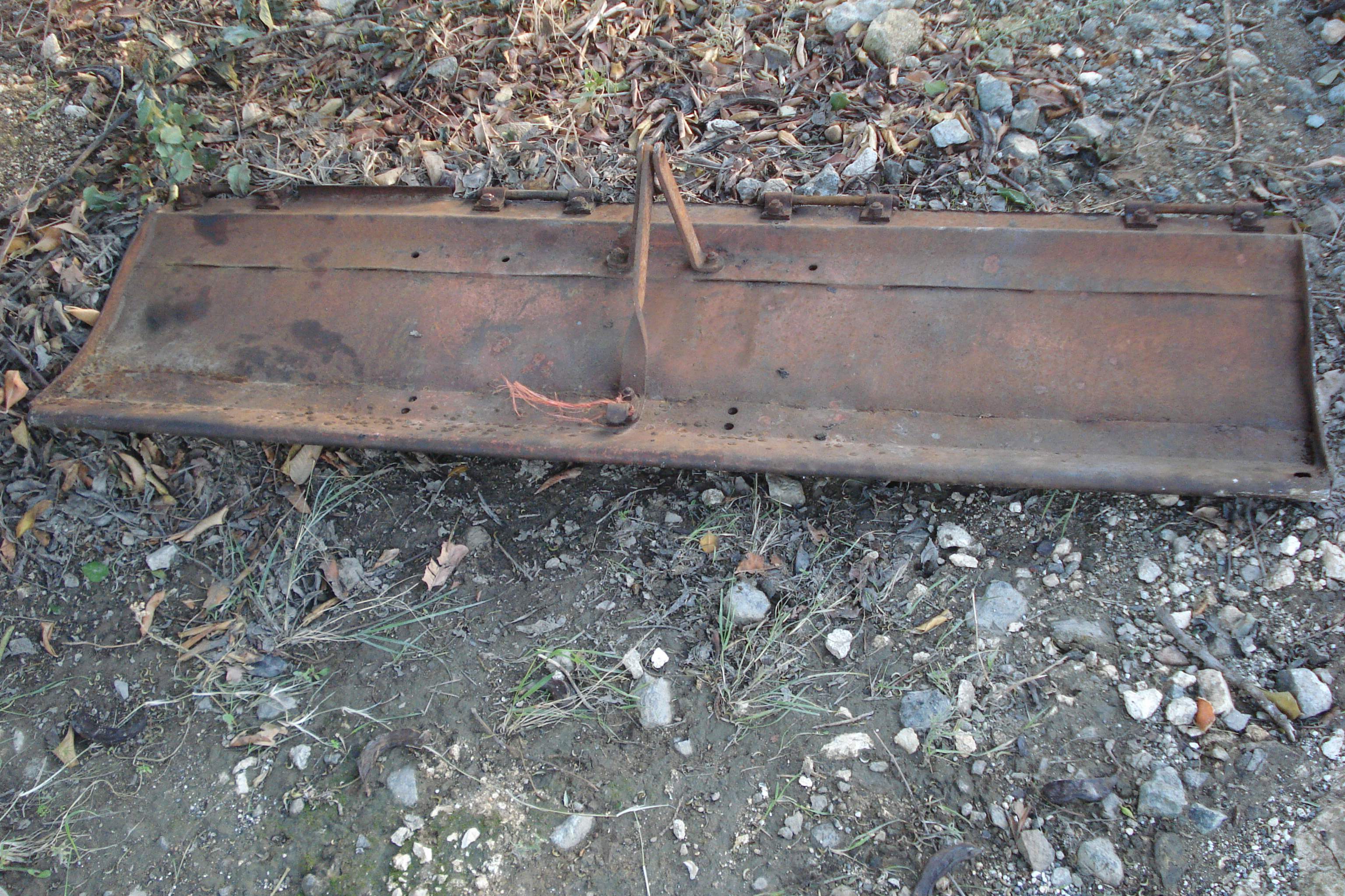

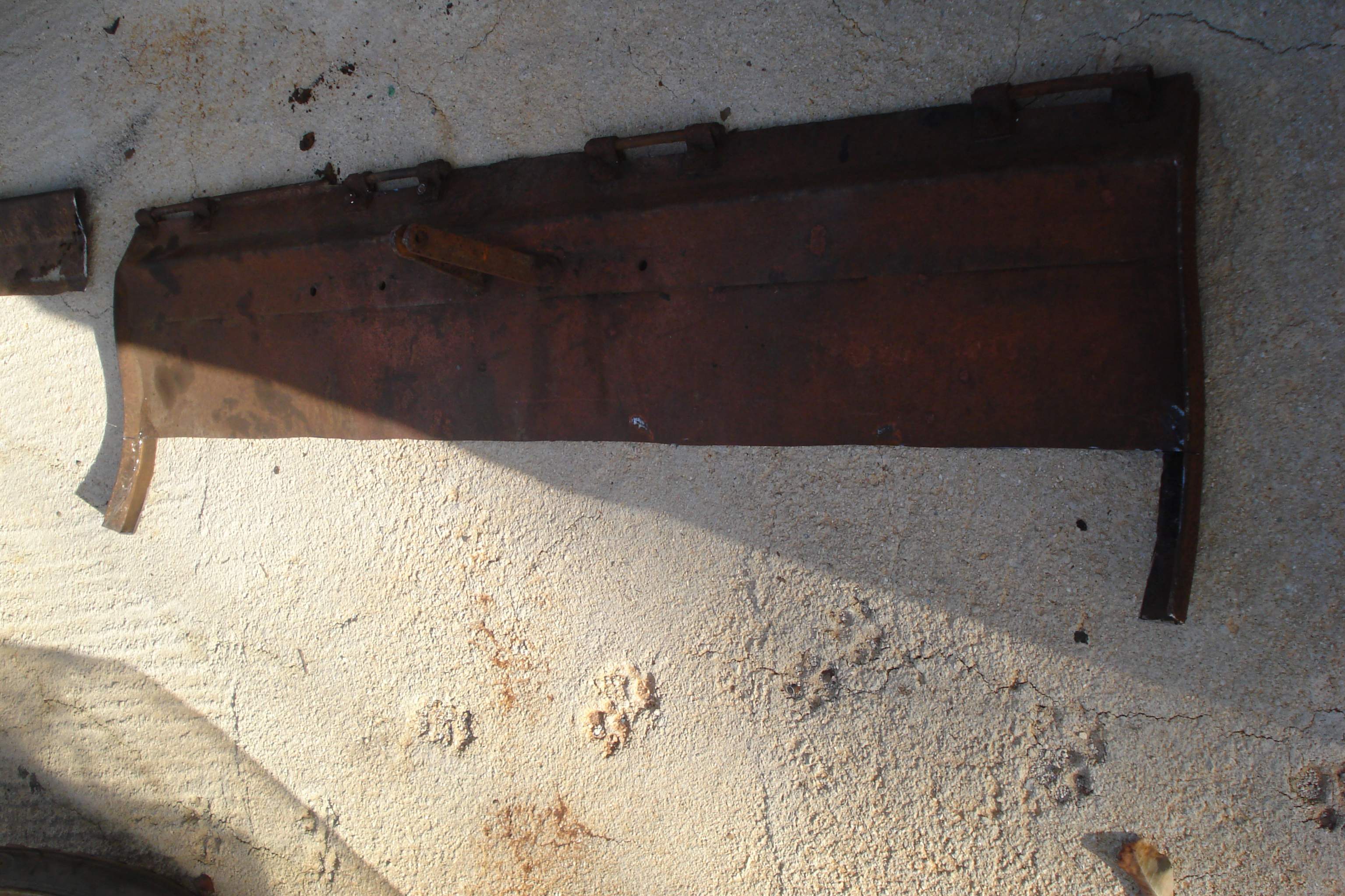

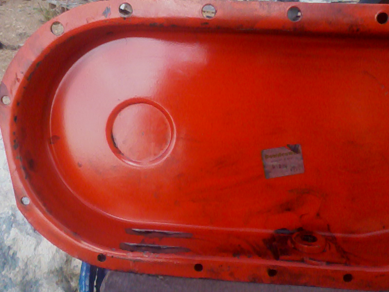

Tiller had part rusted cover which had to be replaced, also the flap door. chain side protector was reconstructed also the opposite side height adjuster. Chain was loose and caused some damage on the chain cover, gearbox bearings and gears fine without noise, chain side bearing was broken, so it was replaced (RMS18 code), other side bearing ok. Blades replaced, and after all this work done tiller was resprayed and looked like new.
Below relevant photos ...howard60.jpghoward60-2.jpghoward60-4.jpgHoward60-5.jpgHOWARD60-6.jpghoward601.jpghowardchaincase.jpghowardchaincasedamaged.jpghoward60-2.jpghowarde60.jpghowardE60-1.jpgHowardE60-2.jpgHowardE60-3.jpghoward60-4.jpgHoward60-5.jpgHowardE60-6.jpghoward601.jpgHowardsideheightadjust.jpgHowardtoppanel.jpghowardtoppanelweld.jpghowardtopbearing.jpghowardflapdoor.jpghowardlowerbearing1.jpghowardE60Finished.jpgHowardE60finished1.jpg
/ Reconditioning howard tiller E60... #2
Great job. Nice project tiller
