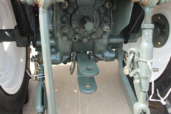

Right off the bat I see something that will have to be disassembled and put back together correctly before using the tractor.
In his listing for the YM1510 the upper 3-point pins are put in backwards, facing toward the centerline instead of outward.
What else is this thing going to need, to bring it up to the new-tractor reliability implied by the 18 hours he shows in the tach?

The stabilizer chains aren't hooked up right either. I also noticed that it says that tractors get the needed safety equipment like override clutch.
"All of our tractors are outfitted according to current safety standards including rollover protection, seat belt, PTO safety shield, safety decals, safety slip clutch, etc"
I think your YM186D has an internal override clutch but the 1510 doesn't so one would have to be added to the exterior and it isn't in the pictures.

Well to be fair to these guys, the pins aren't installed because the tractor is still in as-shipped configuration with peripheral parts strapped on so they won't get lost.
However - those upper pins pointing inward were put that way during 'factory reconditioning' and illustrate that whoever did that reconditioning step had no idea what he was doing. Replacing the pins indicates the original ones showed extreme wear, no? I wonder if the related hydraulic components got 'reconditioned'.
I think real reconditioning would include lubing the ball ends. All I see there is rust.
Am I correct that the bolted end of those pins is tapered and intended to be a press fit? If so, whoever turns them the right way is going to need a gear puller to get them out, and they might always be loose thereafter.

"Am I correct that the bolted end of those pins is tapered and intended to be a press fit? If so, whoever turns them the right way is going to need a gear puller to get them out, and they might always be loose thereafter."
This is a straight pin Hoye shows for the 1510. Yanmar Tractor Parts ADAPTER PIN - CAT. 1_ Just wondering if the pins could be turned that way for shipping or do the lift arms come loose in the crate?:confused3:
