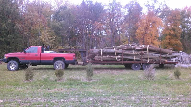

I've been researching tractors over the past few weeks, spent a little time at the JD dealer yesterday inquiring about used tractors. From what I've been reading I should be looking at a 40-50HP tractor, can you fine folks confirm or recommend something different?
I'm looking for a tractor to ultimately use a FEL, grapple, 72" belly mower, rear blade, backhoe and tiller, initial purchase budget of $20k-ish. I cut a lot of wood to feed my outside wood burner, about 6-10 cords per year depending upon winter conditions. I need a tractor that will be able to skid logs from the woods and load them onto my flatbed trailer. I also want to be able to move large diameter logs so I can mill them. I do occasionally run into big wood (48" dia) that no one else wants because it's difficult to deal with. I do not want a cab, as it needs to fit in a garage since I don't have a building yet. HST would be nice for the wife, but not required. I do have a long, wind-blown drive that I often need to borrow my neighbors Bobcat 863 to dig out because my atv quickly becomes overcome. I could go on and on listing how I'd use it but you all know already I'm sure :D
From what I've been researching, I'd like to find a 4-series tractor, finished weight of around 6k+ lbs (with loader, filled tires, etc...). Does this seem to fit my requirements or should I look bigger/smaller? I live 3 miles from a JD/Stihl dealer whom I deal with quite a bit for chainsaw stuff. They have a 4400 in their inventory with <700hrs, 430 FEL, 72" belly mower, backhoe (not sure which one), for $24k, package deal only. It's not on their lot so I haven't drove it. But at <40HP I'm not sure it would be enough tractor?
I obviously won't be trying to load this log-length, but to give you an idea of what I am looking to move around, here you go.
Thank you for any info/recommendations!

I think you're looking at a size that will work for you. My recommendation would be to pay attention to weight and loader capacity. Horsepower doesn't mean anything if you don't have the weight to make it count. Also, for moving logs, I wouldn't want a loader with less than 2400lbs lift at the pins. The loader on the 4400 is rated at a bit less than that. For that price, which seems pretty good, you could buy something like a Kubota mx4700, or a kioti ds4510 or dk40 to dk50 brand new. Either will have a bigger loader and a warranty, but no backhoe or mid mount mower. Kind of a toss up. Do you need the backhoe? Could you save some $ on the mmm and buy a used flail?

I agree with those saying you need something bigger than a 4xxx series. That won't handle something the size of what you have pictured. You need some weight under you to handle a log that size.

Thanks folks. The good thing about a chainsaw mill is the ability to take the mill to the log instead of the other way around. The log in my pic was bucked up into 24" long rounds then loaded onto my flatbed with a sub-30HP Massey Ferguson HST tractor for firewood. One of those rounds in the loader made that little tractor quite unstable. I usually handle logs 12-24" in diameter and if bigger I'll buck them shorter but I'd just hate to buy a tractor that ends up being too small for me. It's hard enough to convince my wife to let me buy one, let alone to sell it and buy a bigger one!
Here's what I usually handle.
