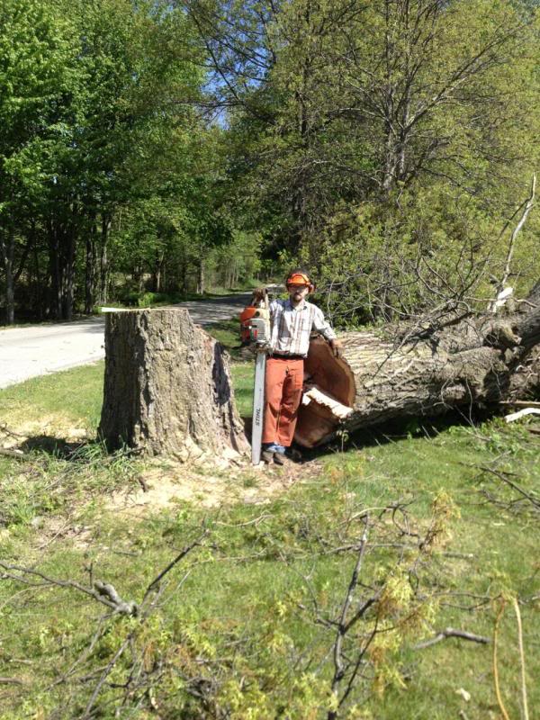

I've been researching tractors over the past few weeks, spent a little time at the JD dealer yesterday inquiring about used tractors. From what I've been reading I should be looking at a 40-50HP tractor, can you fine folks confirm or recommend something different?
I'm looking for a tractor to ultimately use a FEL, grapple, 72" belly mower, rear blade, backhoe and tiller, initial purchase budget of $20k-ish. I cut a lot of wood to feed my outside wood burner, about 6-10 cords per year depending upon winter conditions. I need a tractor that will be able to skid logs from the woods and load them onto my flatbed trailer. I also want to be able to move large diameter logs so I can mill them. I do occasionally run into big wood (48" dia) that no one else wants because it's difficult to deal with. I do not want a cab, as it needs to fit in a garage since I don't have a building yet. HST would be nice for the wife, but not required. I do have a long, wind-blown drive that I often need to borrow my neighbors Bobcat 863 to dig out because my atv quickly becomes overcome. I could go on and on listing how I'd use it but you all know already I'm sure :D
From what I've been researching, I'd like to find a 4-series tractor, finished weight of around 6k+ lbs (with loader, filled tires, etc...). Does this seem to fit my requirements or should I look bigger/smaller? I live 3 miles from a JD/Stihl dealer whom I deal with quite a bit for chainsaw stuff. They have a 4400 in their inventory with <700hrs, 430 FEL, 72" belly mower, backhoe (not sure which one), for $24k, package deal only. It's not on their lot so I haven't drove it. But at <40HP I'm not sure it would be enough tractor?
I obviously won't be trying to load this log-length, but to give you an idea of what I am looking to move around, here you go.
Thank you for any info/recommendations!
