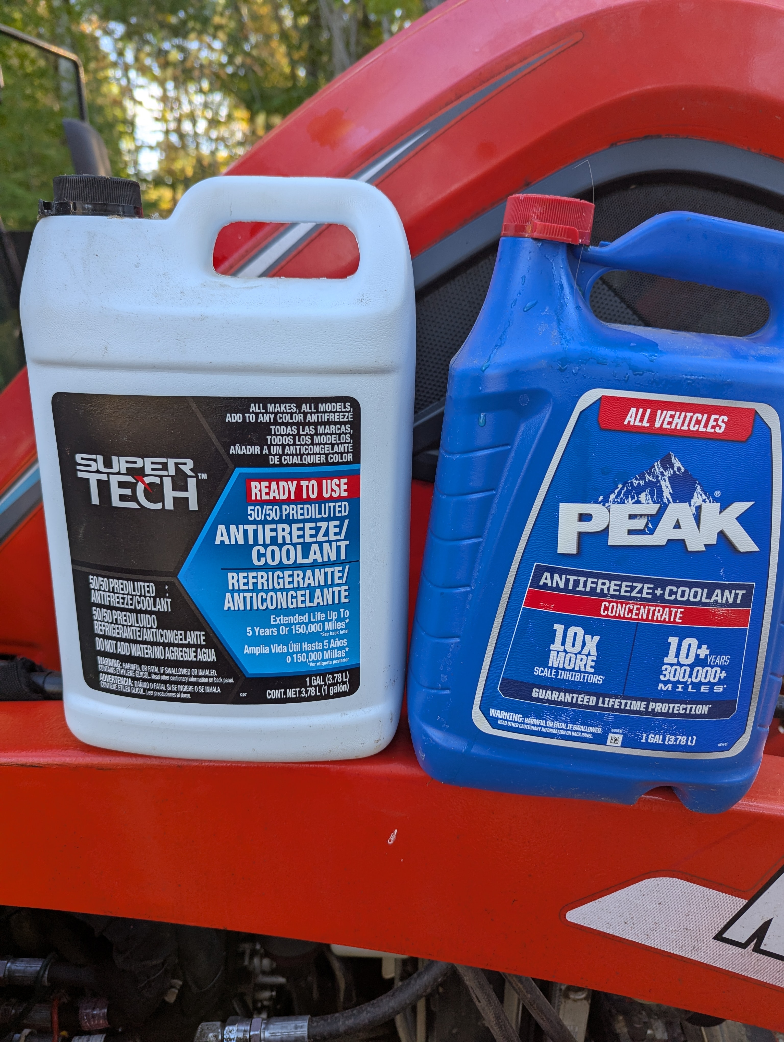

I'm trying to find a definitive answer as to what coolant to use in my Kioti. My dealer said 50/50 green or yellow. From what I've read color doesn't necessarily tell the whole story. I plan on asking the dealer a followup question but wanted to see what the community recommends.

Either of these work? They are yellow.

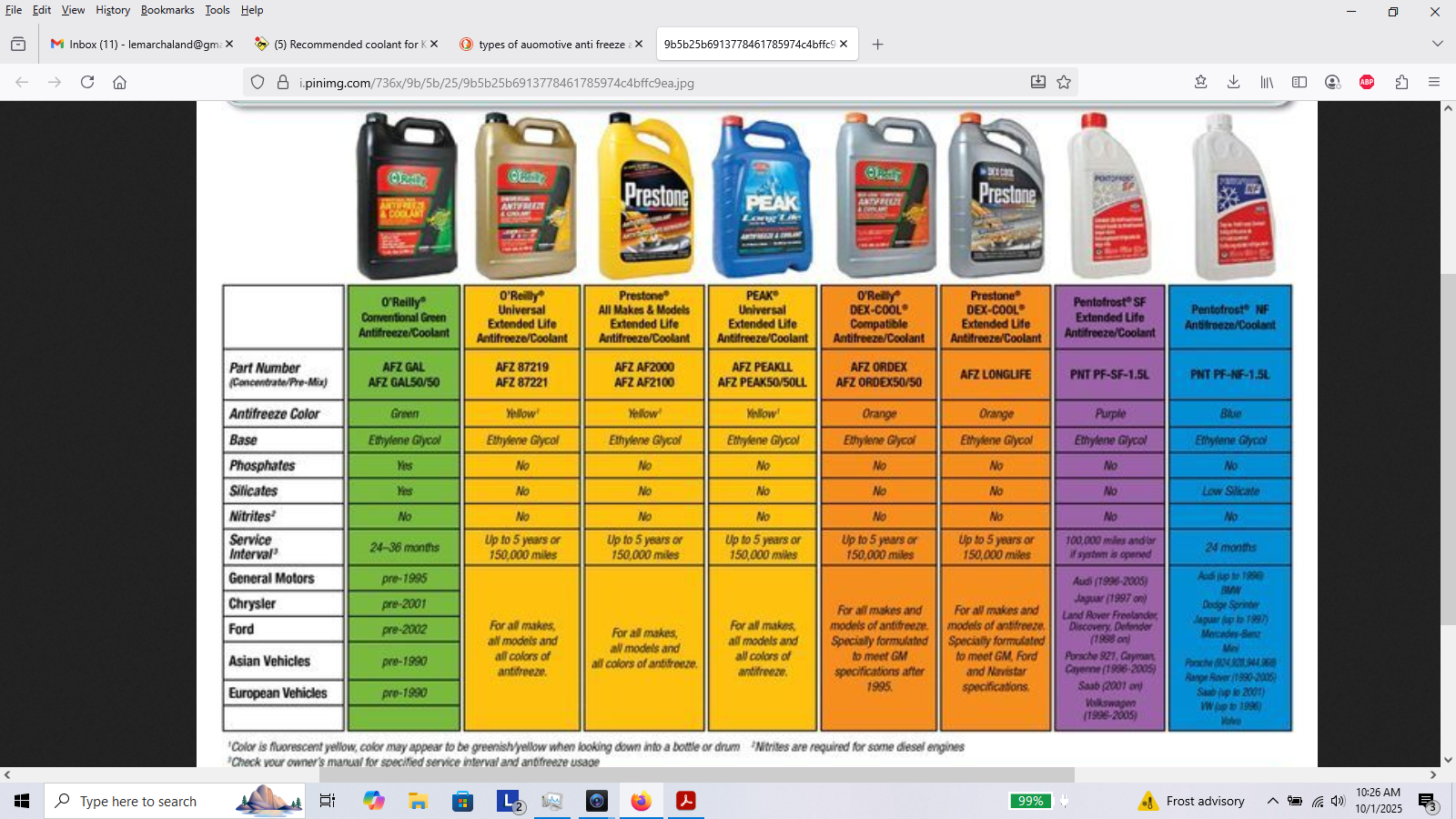

"There are three main types of automotive antifreeze: Inorganic Additive Technology (IAT), which is typically green and used in older vehicles; Organic Acid Technology (OAT), usually orange or yellow, designed for modern vehicles; and Hybrid Organic Acid Technology (HOAT), which combines features of both IAT and OAT and is common in many newer cars. Always refer to your vehicle's owner manual to determine the correct type of antifreeze to use."
I've been bit twice on mixing antifreezes, once with my daughter car a Pacifica (mopar) that had a small top of of Dex Cool which made jelly in the system which was a bear to get out. And once with my SXS which turned into wax and took some aggressive chemical flushs to clear out.
If you wise for longer life and compatibility a good through flush and blow out and then a refill with the desired product is the only way I'd go.
