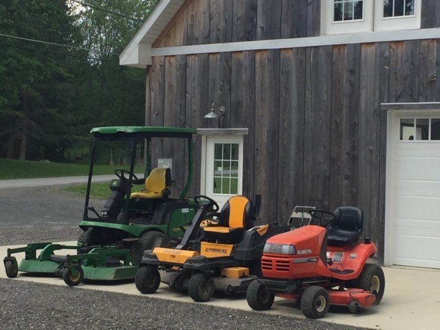

We bought a Cub Cadet Z force 54” with the Kawasaki engine. It has been a good machine. My wife loves running it because to handles all the slopes so well. You can do a 180 mid slope not problem on slope where we had to “hike“ out on lawn tractor to keep the uphill wheel engaged. The seat switch doesn’t allow you to even fidget in your seat, a modification was necessary. The steering effort was more than I thought it would be, power steering on the commercial models might be nice, but a wider deck would do a lot of scalping in our application. The steering got lot better when I raised the tire pressure. The original blades were soft and wore thin and cracked at the transition to the lift wing (I don’t know what to call that bit) after 2 years. We really like the mower for the lawn around the house, about 1.5 acres. Servicing it is straight forward with grease fittings on the deck spindles, and steering. The welded deck is solid. It is a well built unit, not available through any big box retailers. It was not inexpensive, that said, we are very satisfied and since we are septuagenarians it’s likely the last one we will be buying. We mow about 5 acres of very irregularly shaped ground around ponds and lots of trees. I do the “back 40” with a JD 1545 72” rear discharge I bought at auction. It is a retired municipal machine 1600 hours. When we team mow it takes about 2.5 hours give or take.
