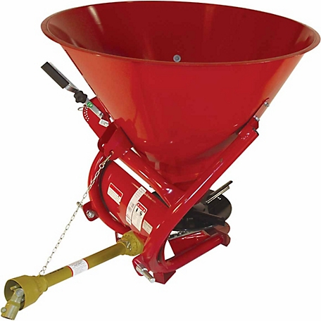

I have one of these I use.
The good. You can raise and lower the 3 point to control how wide the pattern is. You can also throttle up or down to throw the fertilizer wider. You can vary your ground speed to vary the density of the fertilizer. It also hold a lot, maybe a couple hundred pounds or more. The gates have a lot of adjustment also to control the rate.
The bad. All those different ways to control things make it hard if you are after the perfect rate. I usually apply a low rate and apply it lightly to get everything covered.
There is a better one out there. I used this for decades and finally wore it out...it worked but no game changer.
In visiting my local primarily used equipment dealer he had a different brand with no manufacturer tag to be found. Difference was SS slinger, slide distribution selector under the front of the unit...easy to select, and convenient hold/dump adjustable lever.
The cone was light weight high tensile steel making the moving and mounting much easier. I bought it a couple of years ago, works great and was under $500 for 4-500# capacity...same as the one pictued.
