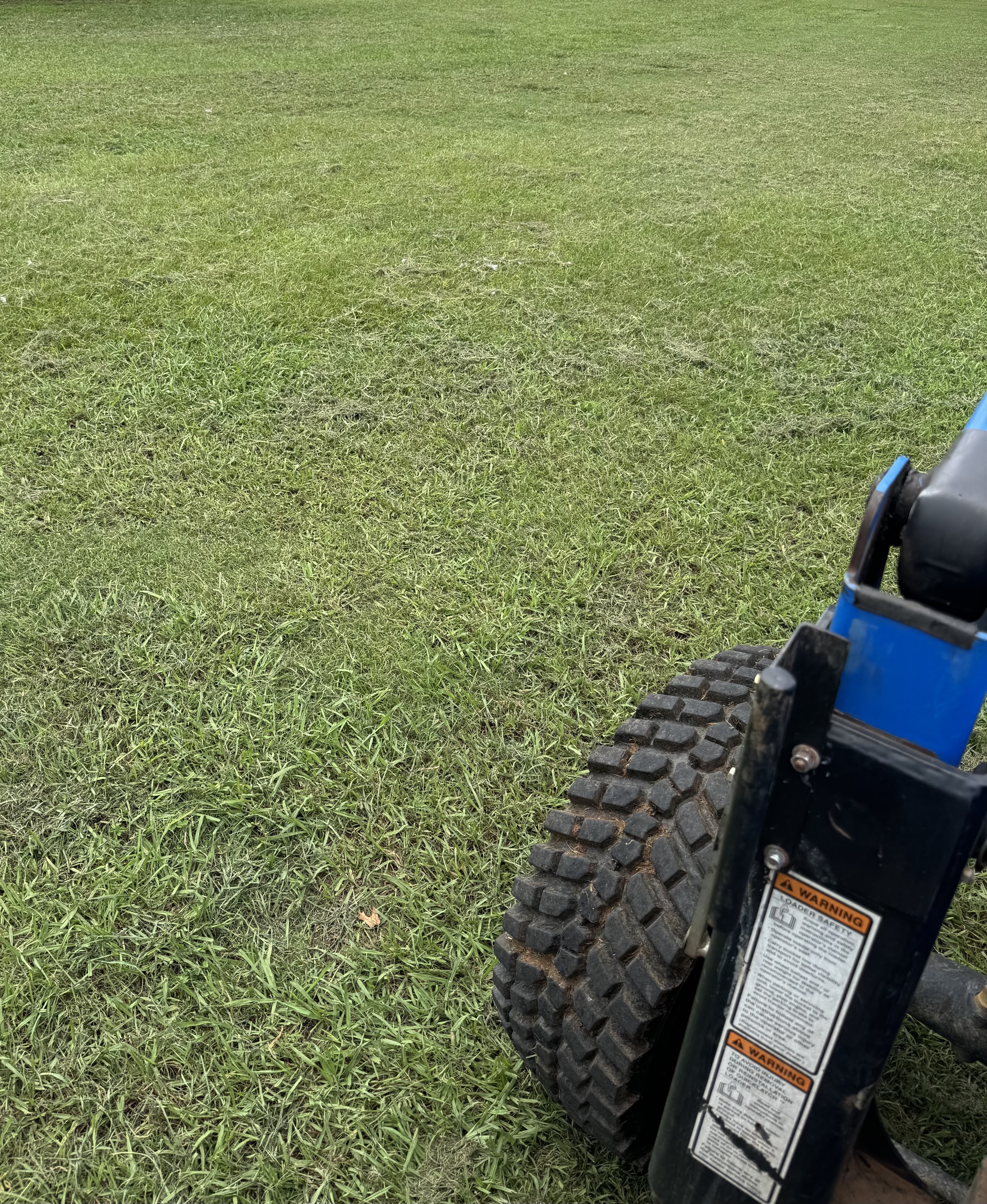

Here is a picture of yard mowing with the Y knives. I put my last two new Y knives on, so it won’t be too long before I need to switch them if I keep losing them.

The sod looks very good.
How fast were you traveling?
what is your cutting height measured at the tip of the side slicer knife and the solid sod ground?
Have you considered mowing in an slightly overlapping spiral pattern to shred the clippings further?

I don’t know for sure but I mow in low range with the electric shifter in high which maxes out at 5.95 mph and I try to cut with the hydro pedal all the way down.
I am trying to to match my lawnmower height settings of 1.75. We typically cut this area with the lawnmower beyond that I don’t have an exact measurement.
I have too much to mow any a second time.
