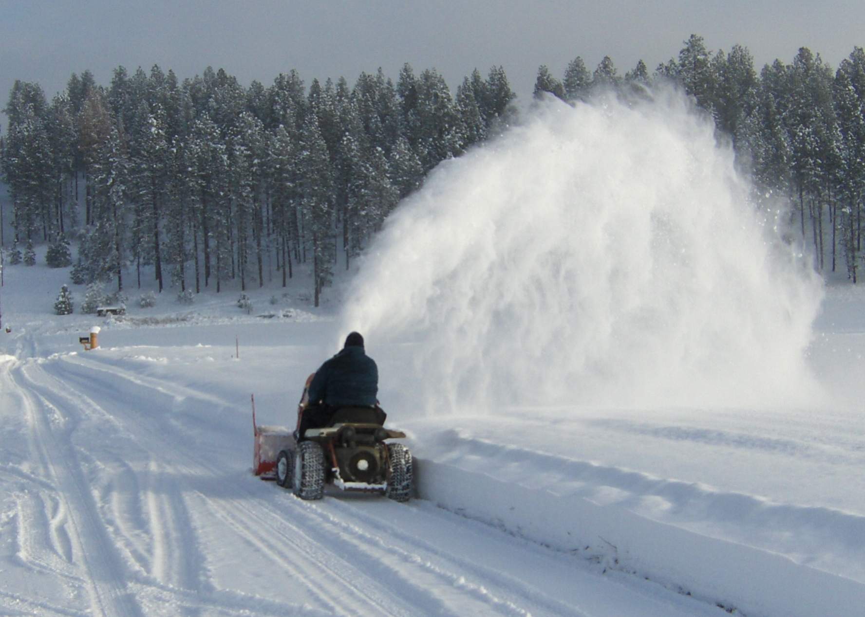

+1 for Gravely.
   / Recomendation for Garden Tractor w/ Snow Blower #7
Beautiful picture, 816??? Looks like an Onan. Nothing like seeing the Gravely doing the job. Thanks for sharing that.
John M
   / Recomendation for Garden Tractor w/ Snow Blower #8
John M
Yep, 816, Onan twin P18 (repowered about 10 years ago). thanks for the compliment. The neighbors all seem to like the Gravelys too...
