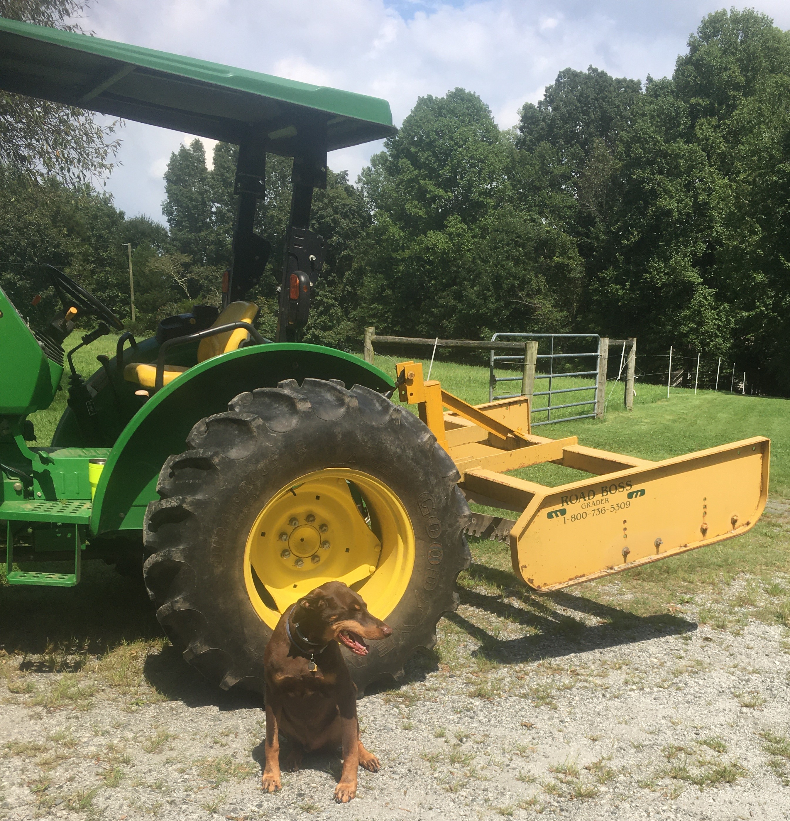

I have a 1/4 mile of gravel driveway. I used neighbor's 8 foot heavy back blade for a few years. I made dips and humps every time I used it. And each time I used it, I had to make multiple passes to smooth the dips & humps I made. Then I got a land plane. One pass up and back did the job. Crown the drive by adjusting the 3 point. Angled blades reclaim the gravel from the sides.
It does pull hard when full though... likely no more than a equal sized box blade.
I like this brand (Roadboss). Front blade is slotted so no need for rippers. Replaceable skid shoes and most important ... Adjustable blades to compensate for wear.
