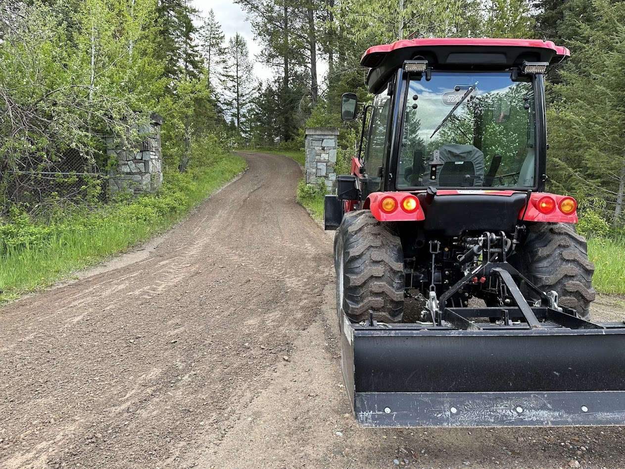

I have about a 1 mile gravel driveway. My maintenance plan, which has worked pretty well, is:
1 - Make multiple passes with an angled landscape rake to bring gravel back onto drive.
2 - Make a few passes with LPGS to smooth the drive.
I find that the landscape rake is just "OK" on pulling gravel back onto the road. I've thought of trying to construct some type of clamp on blade but have not found anything I think will work.
I have a scrape blade that is very heavy and, while it Cuts ditches well, brings too much dirt along with the gravel if I try to use it to reclaim gravel.
I'm thinking a light blade might just do a good job of reclaiming gravel without reshaping the dirt underneath.
Anyone ever used a lightweight scrape blade for reclaiming gravel? TSC has a 6' one that only weighs 213 lbs. They also have a 6' "Professional" that will offset one foot and weighs 256 lbs.

Don’t think blade weight is the only problem. Every scrape blade I have seen is curved. When facing forward it wants to dig unto the road bed. Not so much if you reverse the blade so the curve is pointing backwards. Does more smoothing than digging in.
Current blade is too long to turn around when on my tractor (I inherited it when I bought the farm).
Current blade is so heavy duty that my welding friend said "Don't ever get rid of that".
Perhaps I should try shortening the top link to make mine less aggressive?

I have run my somewhat heavy (1,600 lbs.?) rear blade backwards if the driveway only needs a touchup, but for getting gravel back to the surface the 8' land plane is my weapon of choice.
And I don't necessarily run either one with the 3-point all the way down.

I do the same to get gravel "back to the surface"
This question, however is about getting it moved from the sides back onto the top.
If using the rear blade I run it angled so the gravel goes from the edges towards the center of the driveway.
With the land plane it ends up there automatically since its cutting edges are angled.
