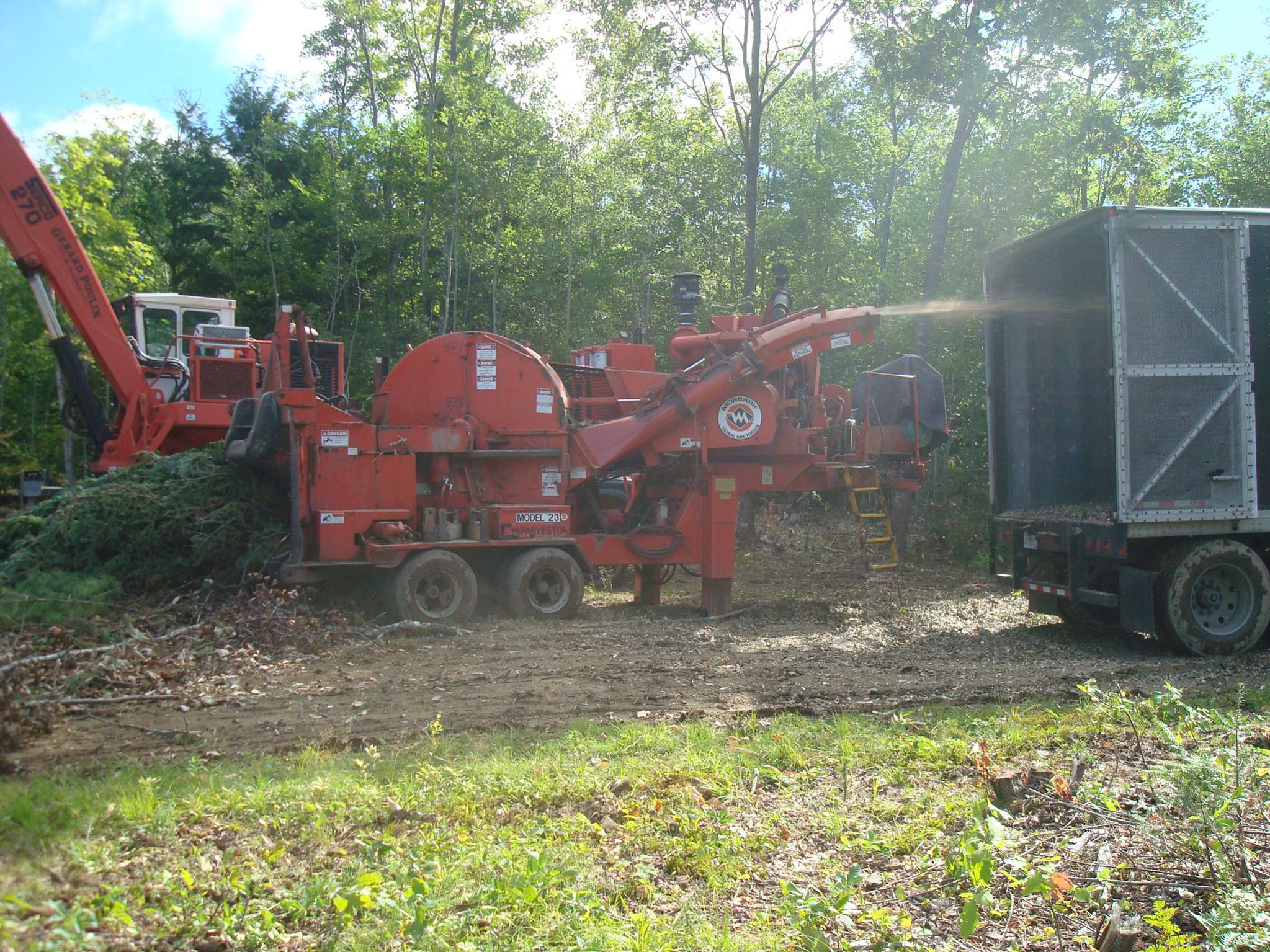

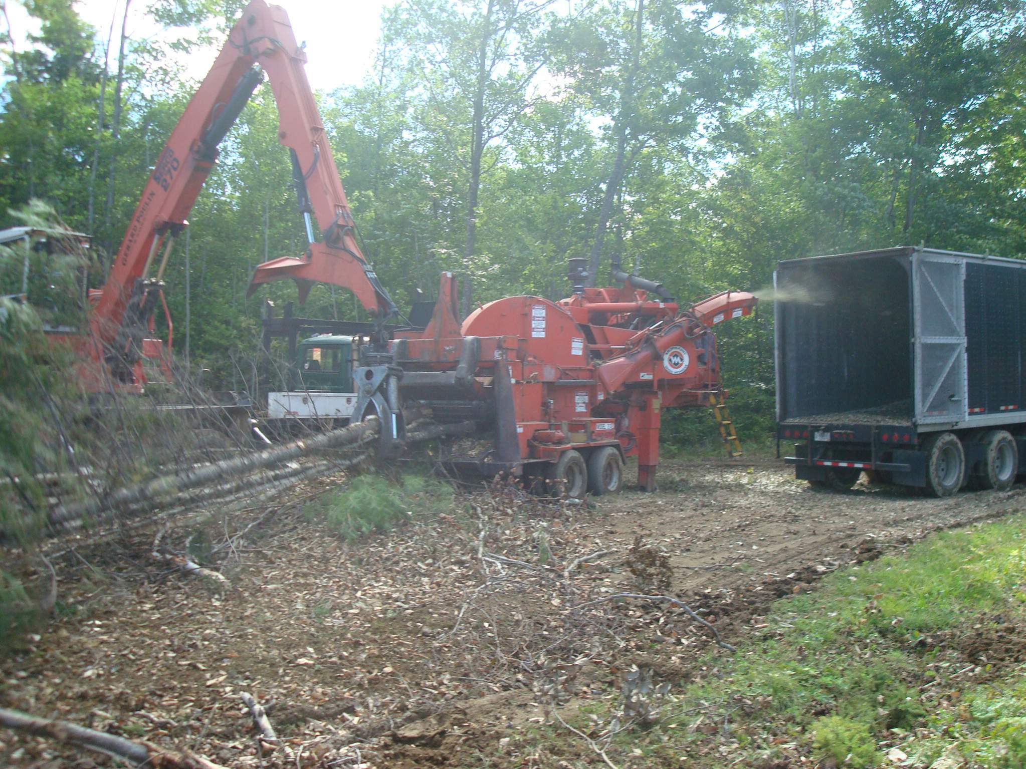

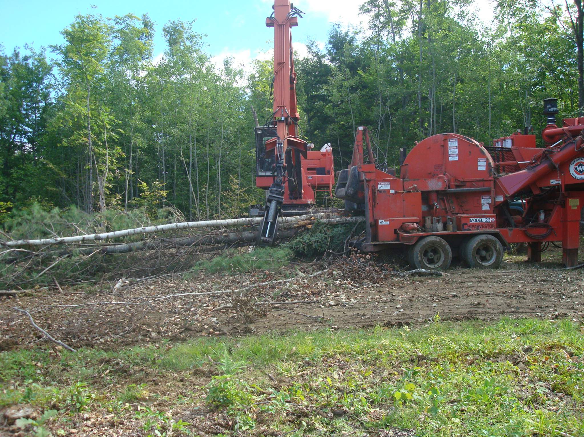

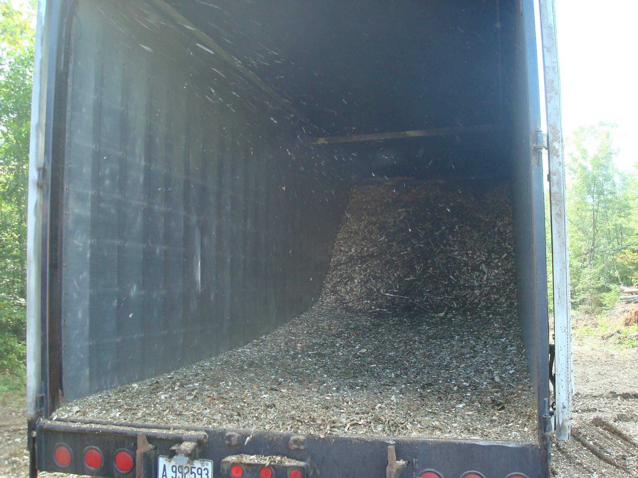

Here are some pics of the chipper in-use. The trees are picked up with the crane and pushed into the chipper's powered feed drums. The top drum rides up on the logs as they are pulled in. The chips are blown into a 53' van trailer for transport.

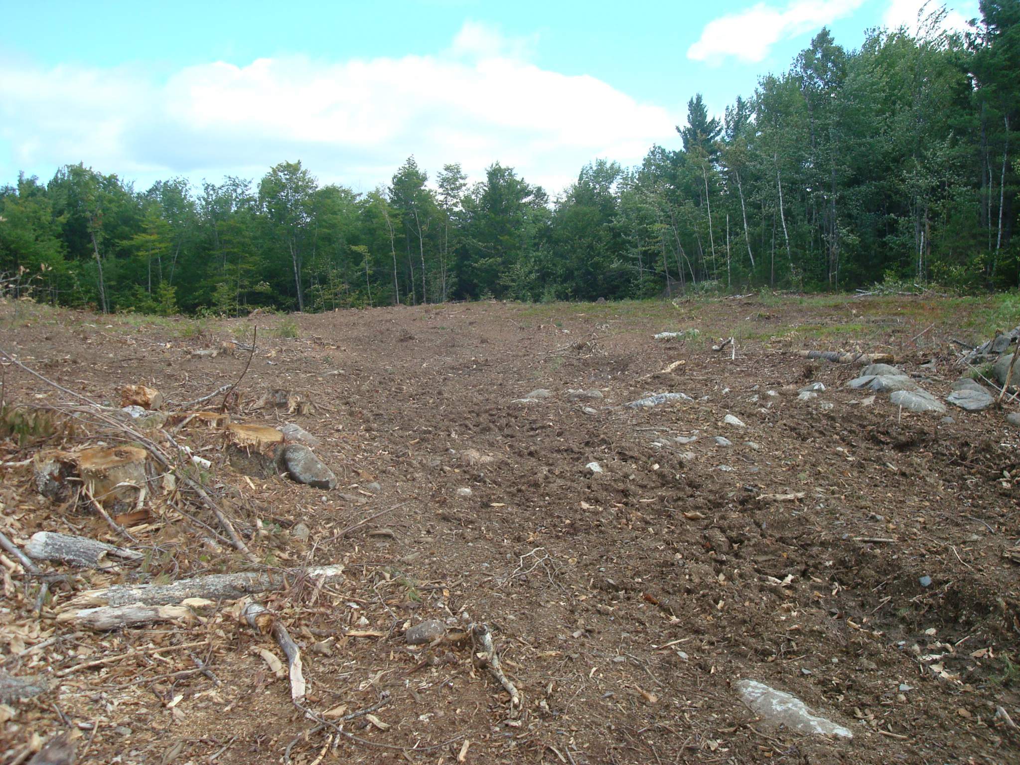

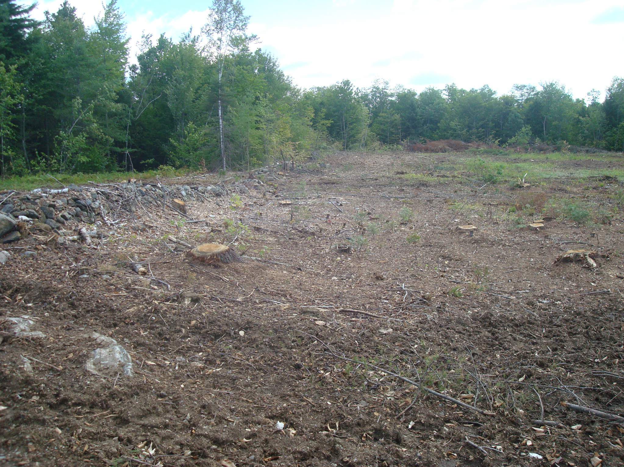

The last two pics are about typical for what needs to be cleared. Some areas are a bit thicker, some less.
The old rock walls are going to be fun. A few wall sections are still intact and worth keeping as historical remnants of the poor devils who settled this area back in the mid-1800's, but most of them have been skidded over or knocked down over the years to the point where they are just lumps of rocks. I think I would prefer to remove most of them. They are just extra work to keep the trees trimmed next to them and they eat up usable space, plus chopping the area up into odd shaped sections. Goats would probably enjoy them.

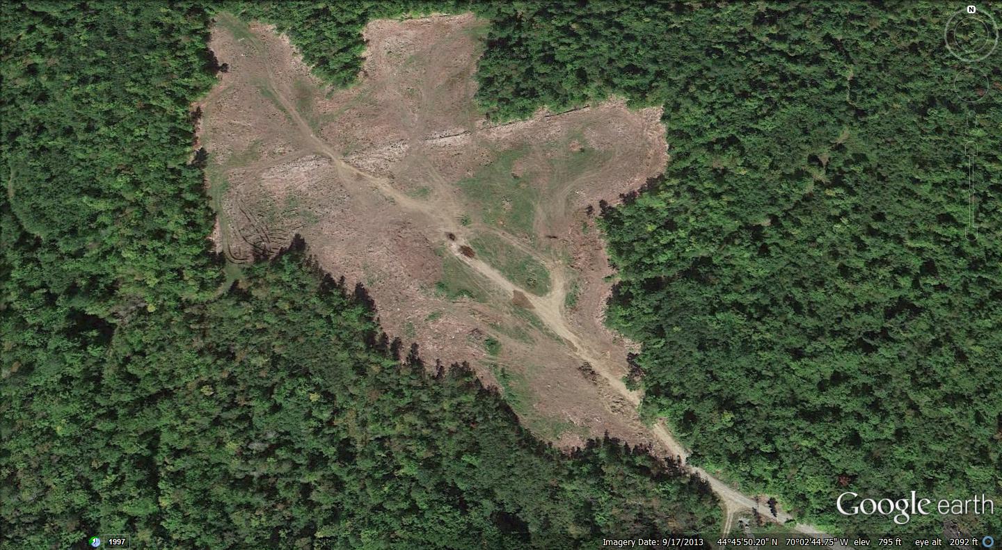

Getting back to some activity on this project. We finally joined civilization on Google Earth with a new, crisp image taken last September after the trees were all done.
This a view of the clearing:
A closer view:
I dithered all winter about buying or hiring equipment. Asked a few questions in the Construction Equipment Forum here on TBN. Shopped around various equipment looking up specs etc. In the end I decided it is better to hire the job out. Work should begin sometime this month. The guy doing it has done other work for me and I've always been pleased with the results. He has a large Volvo tracked excavator, a Deere dozer with a root rake blade, a front-end loader and dump truck. His son works with him the business too. His estimate is $20K +/-. Probably the better part of three weeks work. That's about what I expected. The forester I consulted with told me she paid $2K/acre for a field clearing. I think the main clearing is about 12 acres and there are another ~2 acres nearer the house and along the access road.
He suggested a way to deal with the stumps. There are two areas with steep slopes that he says would make good stump "bunkers." He will take what dirt he can out first, then pack the slope with stumps. Finish by covering the rebuilt, smoothed-out slope with a layer of dirt. That sounds good to me and a lot more fun than burning them and working around piles of stumps while waiting for them dry enough to burn well. I know eventually there will be some uneven subsidence, but those slopes are not usable now as they are anyways. I'll post some pics of those and as the work progresses.
