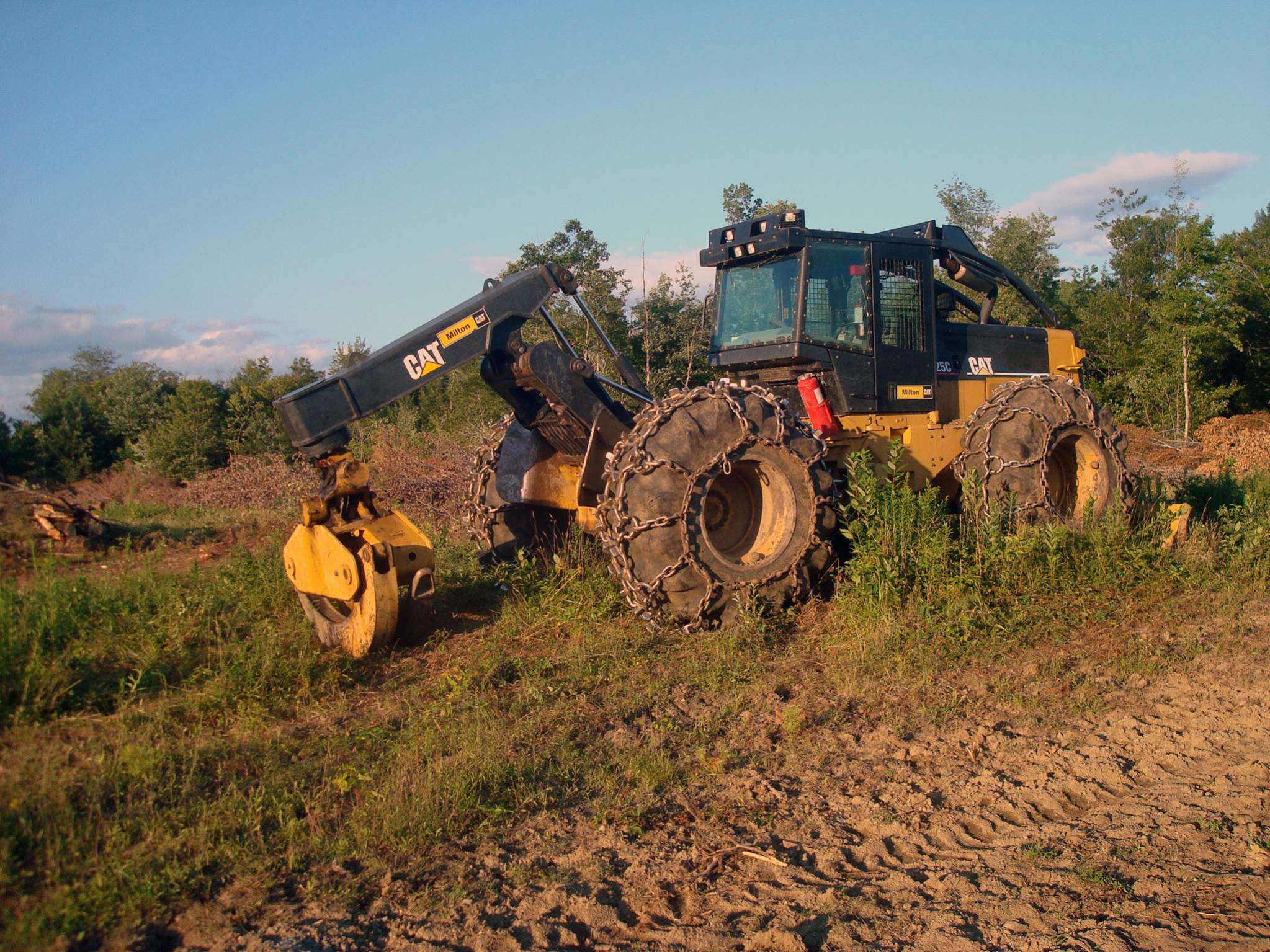

I've thought about creating some (about 15 acres) pasture land for several years and this summer I started on that project. The area used to be a pasture or hay field 50 or 60 years ago, but had reverted to woods since.
The trees are a major obstacle of course and the area had been logged a couple times over the years. None of them are good for saw logs, lots of small stuff and "pasture" pines that have grown in all directions from having their leaders killed off by pine weevils.

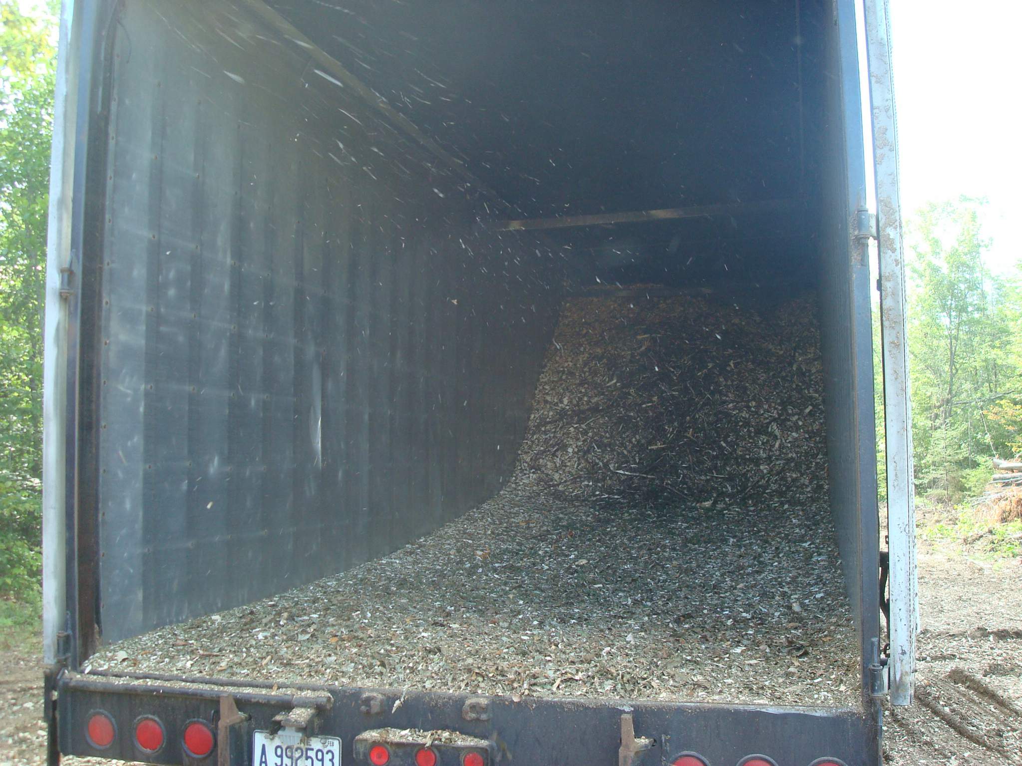

I asked our district state forester to look it over and give advice. She said there was enough wood to get someone in for a whole tree, clear-cut, chip harvest. The chips are burned to drive steam turbine electric generators at the Sappi paper plant in Skowhegan, Maine which is not far away.

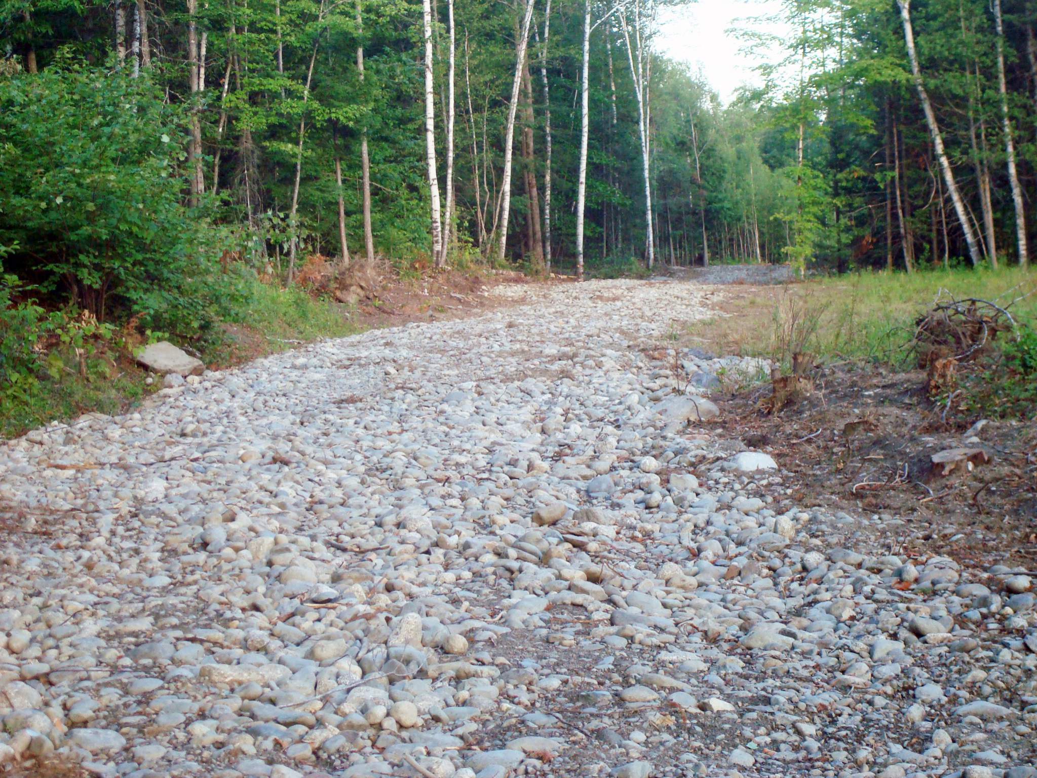

The first step was to open up a 1/4 mile long narrow lane and make it able to support 80-90 thousand pounds (when loaded) tractor-trailers. I didn't really want to tackle the road job using my NH TC40 with backhoe, but there is no budget for hiring it out. So, I commenced digging stumps and doing some grading of the lane. Then spread 464 yards of 6" gravel. It's river rock/cobble with some fines in it.
It doesn't lock-up very well, but it's what was available and affordable. The trucks beat it into the ground so it does stabilize eventually. I've had to pull it back together a couple times, especially after the skidder hauled the trees that where cut along side the road, and some trees I had them take near the house. That was unavoidable given the timing of things, but no fun.
The wet weather has been the biggest challenge. We had a very wet June and July, and it continues that way in August. We have been lucky to get 2-3 good drying days in a row here and there.

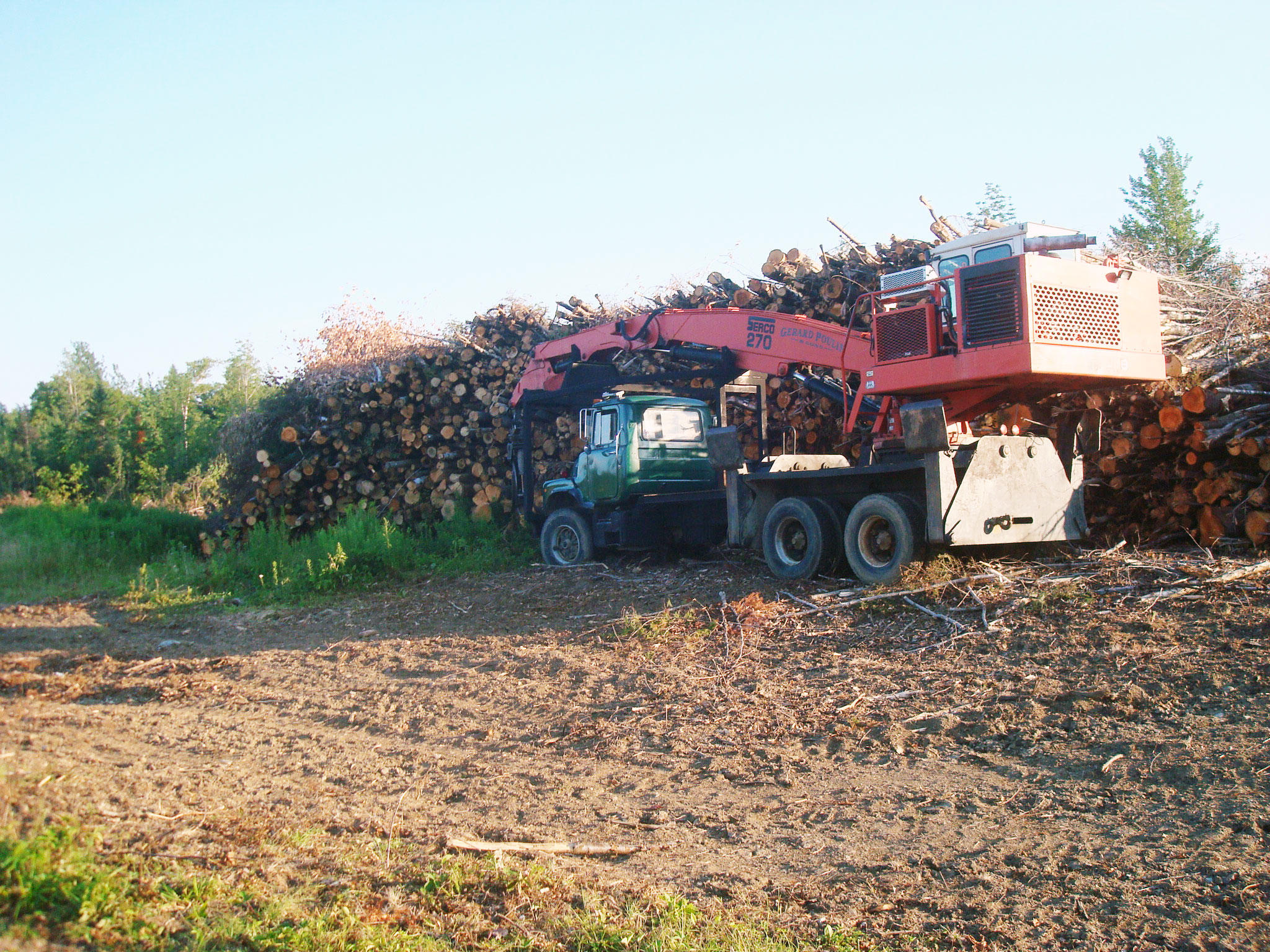

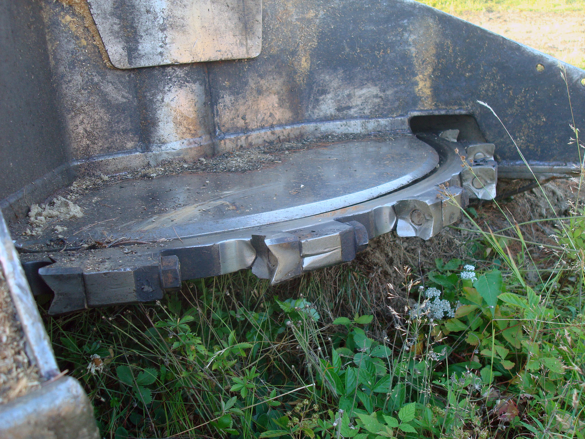

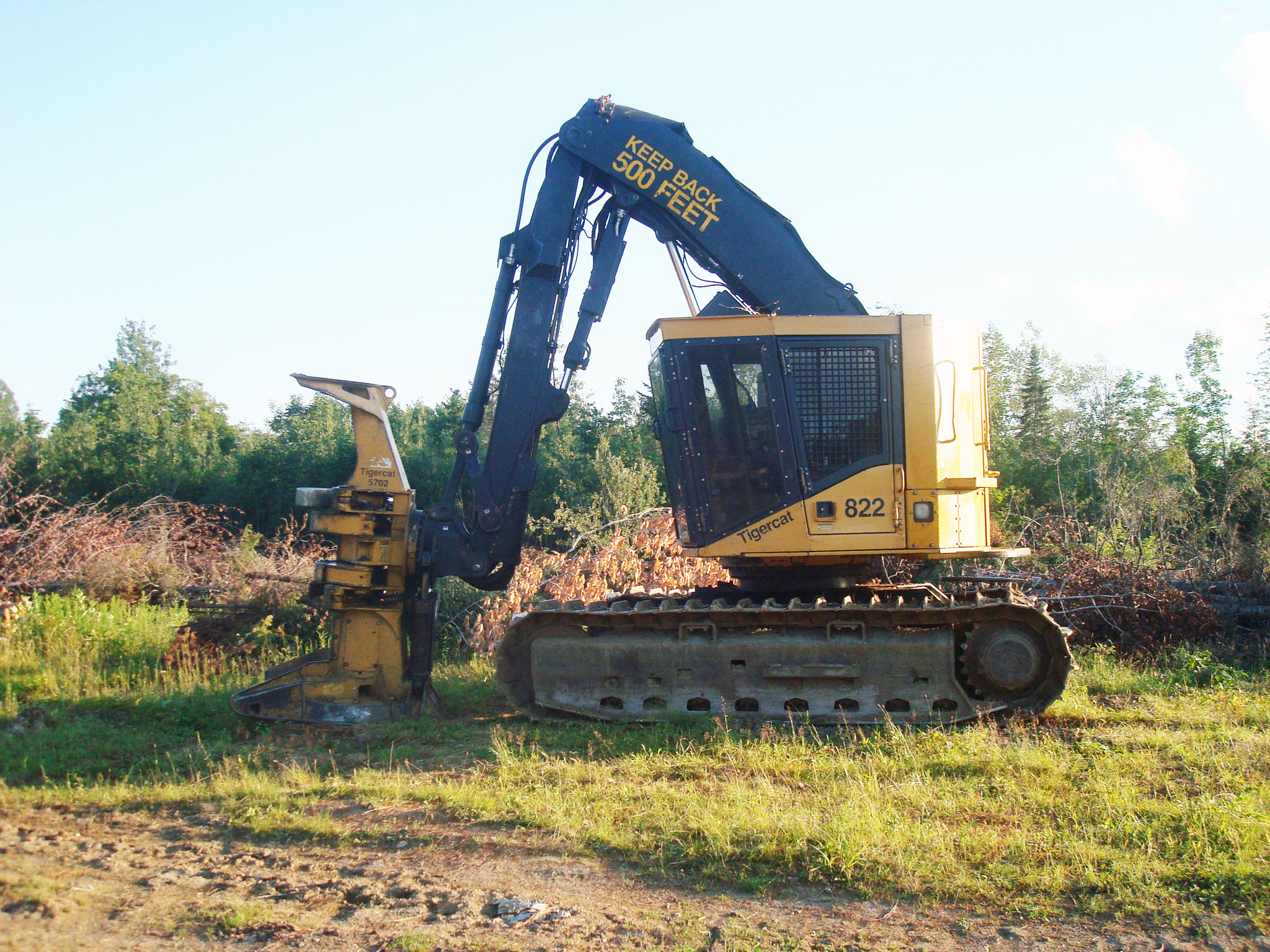

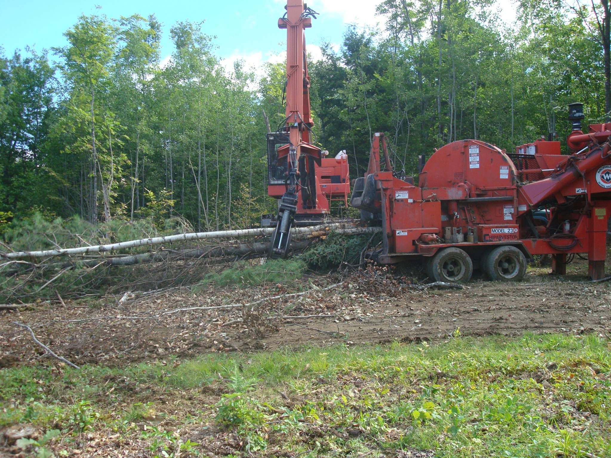

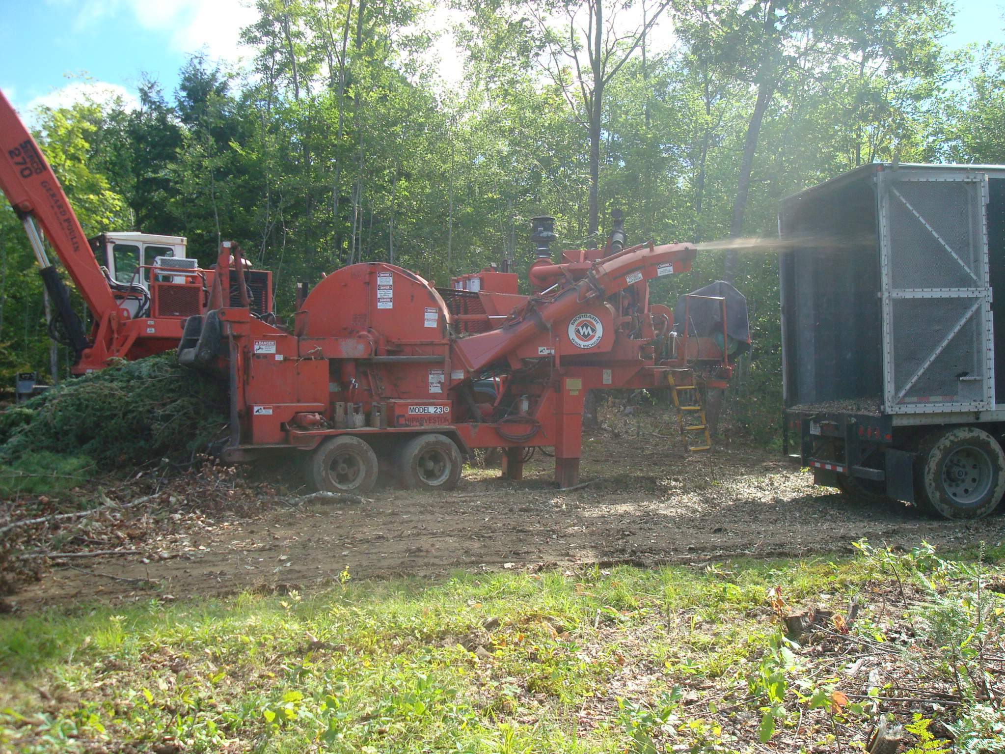

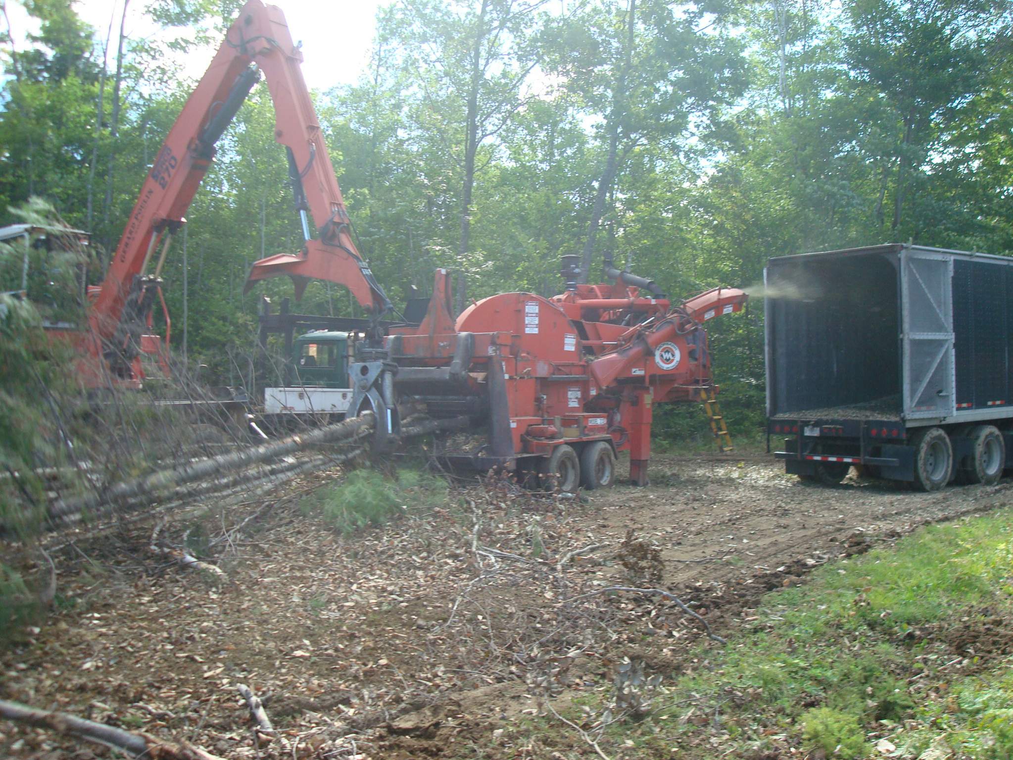

Some pics. The Tigercat harvestor, road, yarded logs and crane. I'll get some pics of the chipper when it stops raining. :p They have taken out 14 or 15 loads of chips so far. There are another 12-15 loads to chip yet.

Thanks. The logger was finishing up a job in the next town, so it happened more quickly that I had anticipated. It works out well for the logger to not have to move the 60 ton harvester very far between jobs.

Thats a very aggressive project, my hat is off to you ! Just the work on the lane into the property was a huge job.

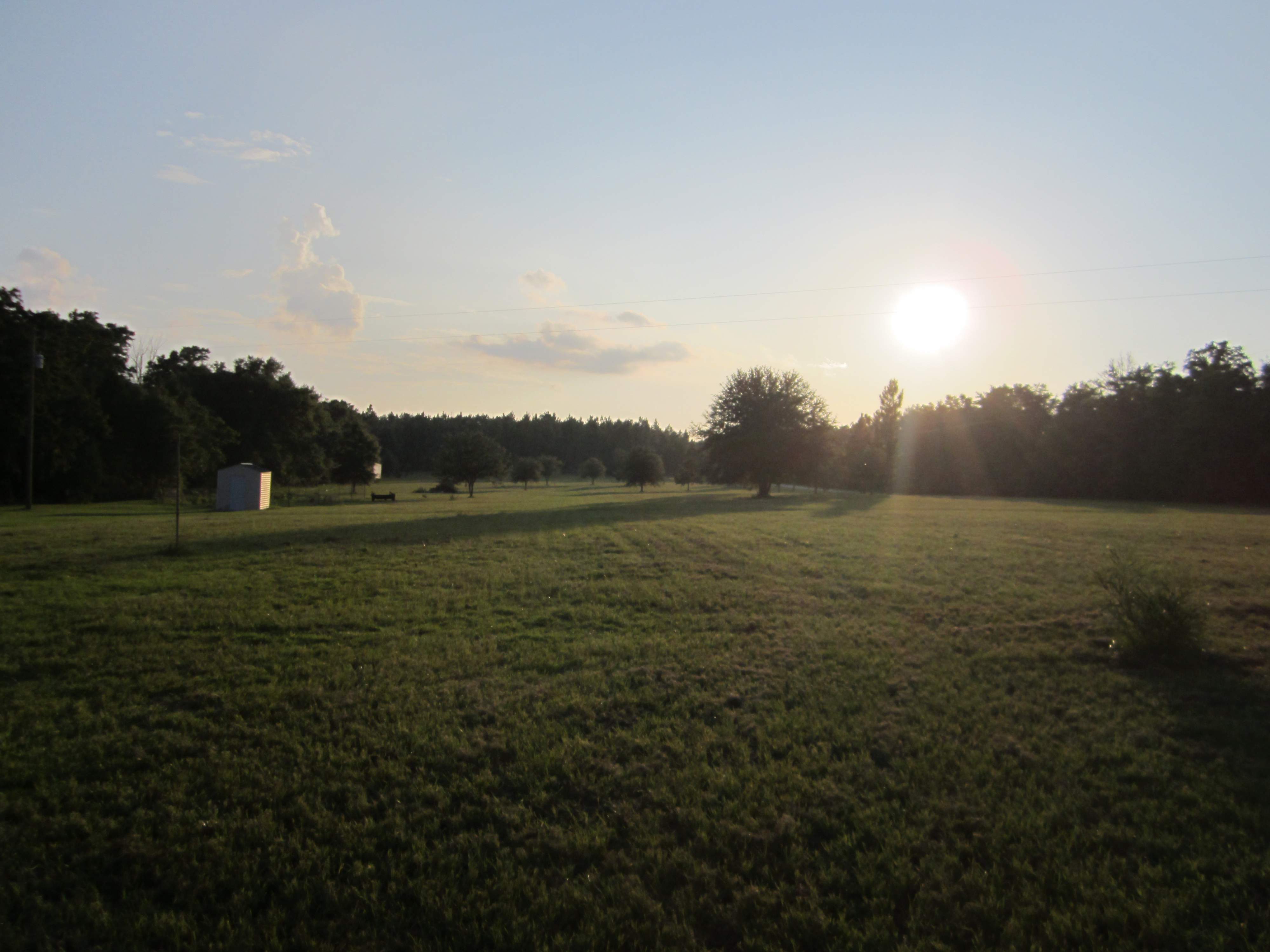

I have sold all my livestock, and let a few trees grow up in the old pasture. Now it is just an extension of the yard. At the end of the day, it is good to have a long view.

That is a nice looking field. Just like you and Scotty, I like to see the open sky and some field too.

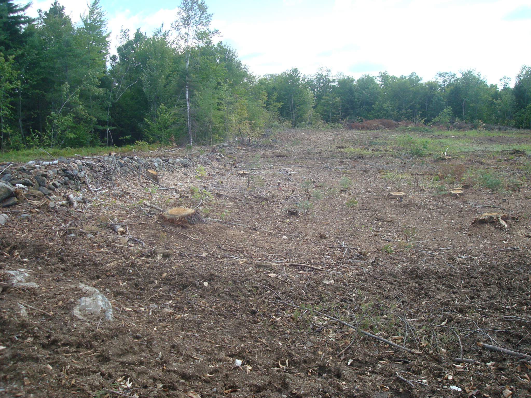

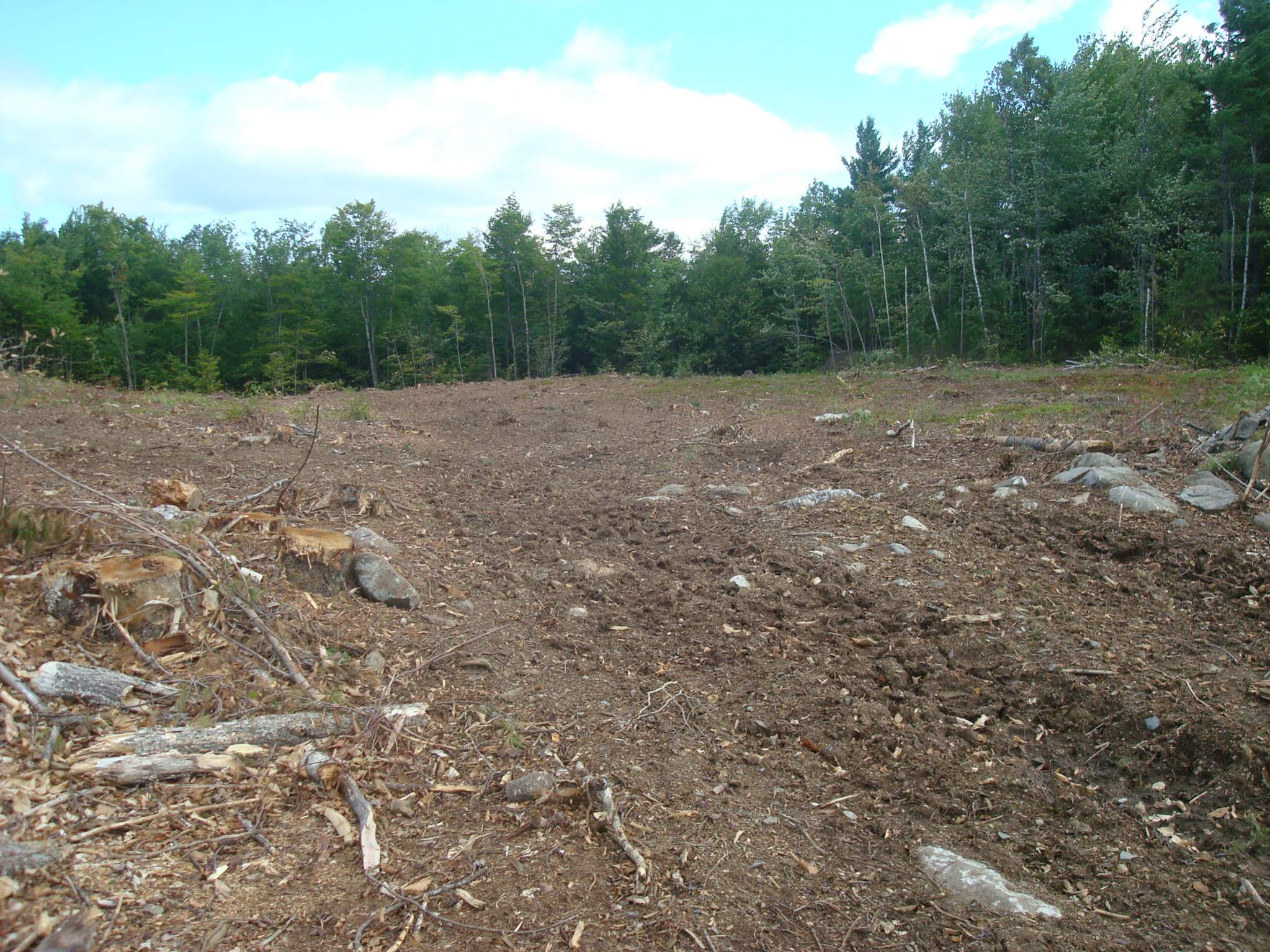

Not going to get rich from the chips. My portion is $4/ton, so the chips won't pay for the stone in the lane. But, I end up with an all-weather lane to the field and the trees are out of the way at least at a fairly low cost overall.
I have been thinking about how to proceed with the stumps and roots. It's true, they will soften up after 5-6 years or so, and goats or sheep would keep the regenerating growth down. I've also thought about buying a used TLB like a Deere 310/410 or Case 580. The stumps are numerous enough and close together that trying to mow around them would be difficult.
This fall I will pull some of the small stumps with the TC40 and make some burn piles for a start.
