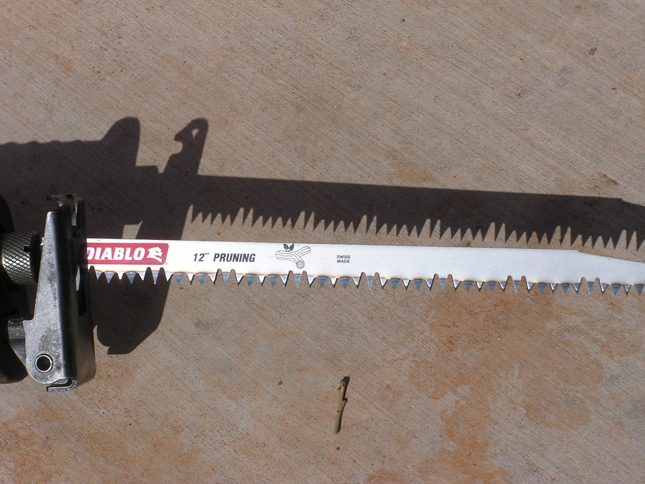

Those Diablo carbide pruning reciprocating saw blades are great IMHO and I use them in both a corded saw and Ridged 18 volt saw.
I also use pruning blades with my Ryobi reciprocating saw for trimming smaller limbs. They are especially good for cutting roots. Way better than stick your chainsaw in the dirt or swinging an axe.

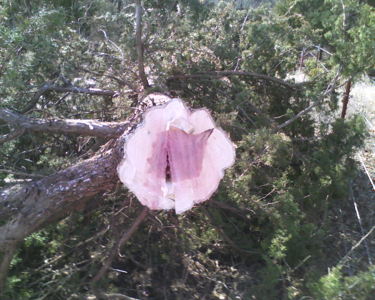

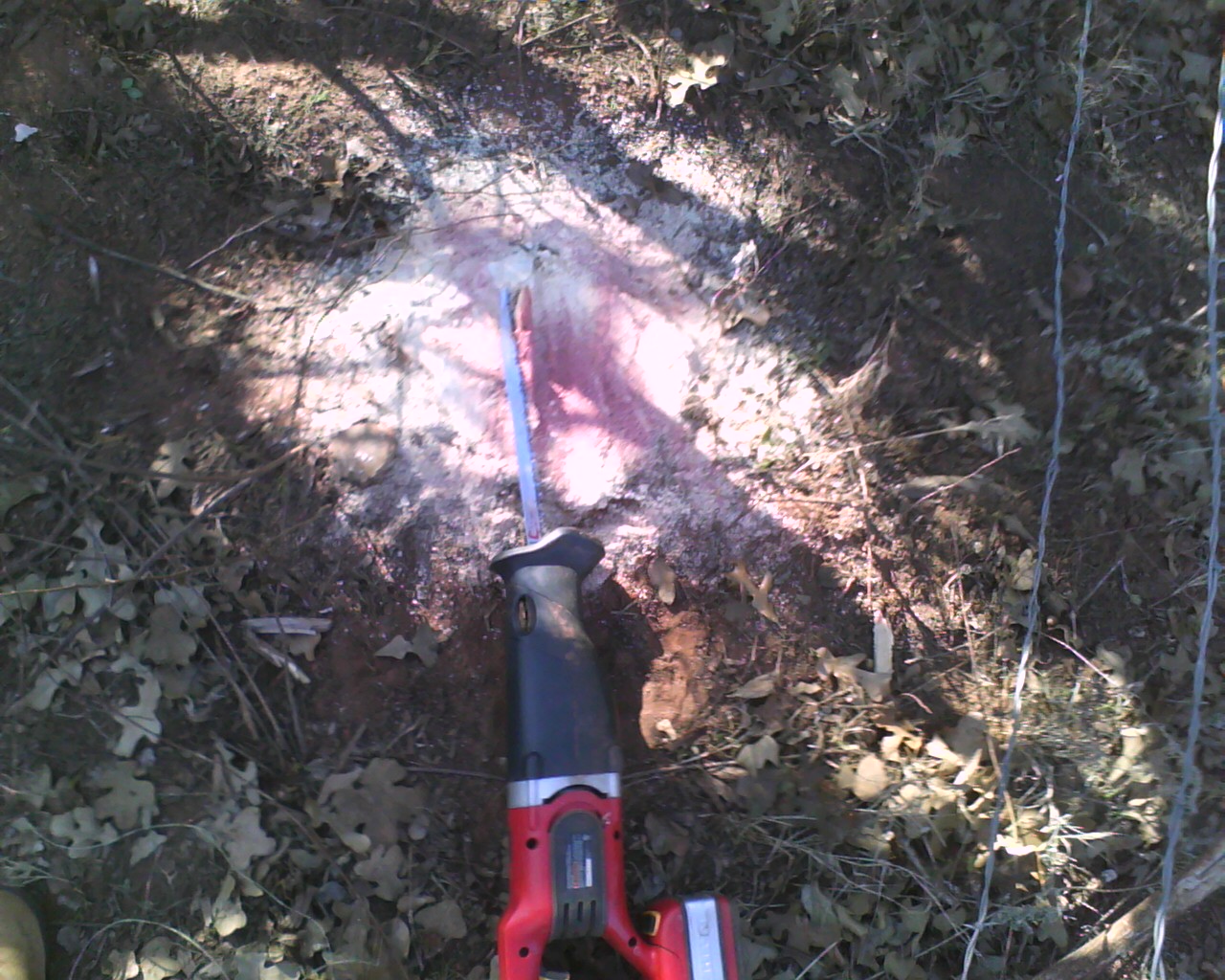

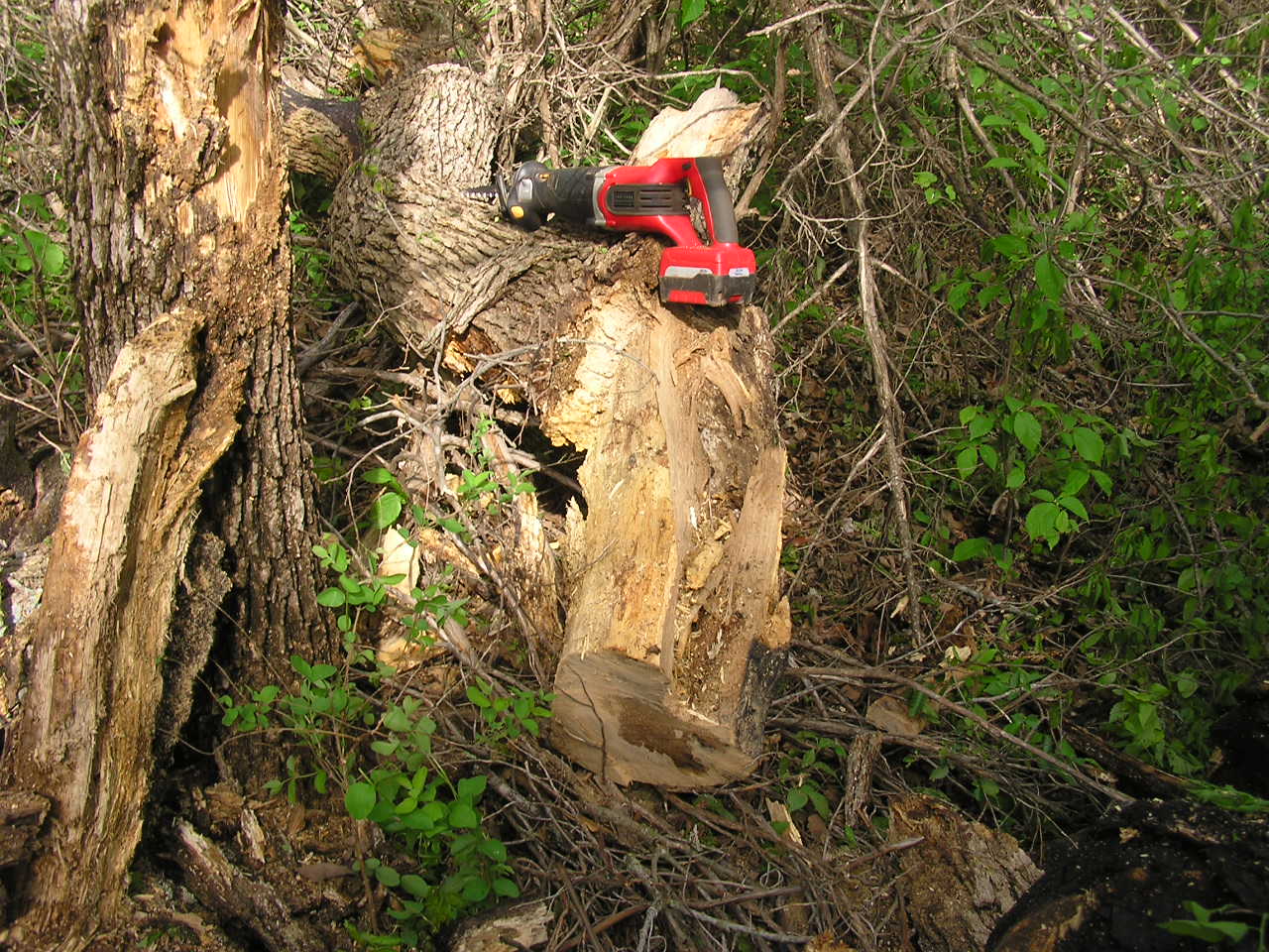

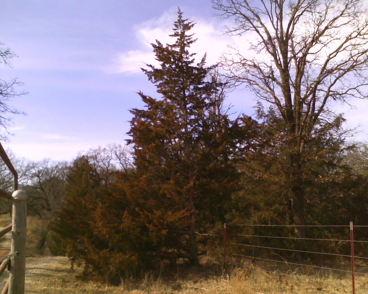

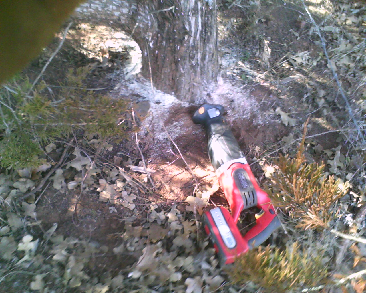

I also use a recip for taking off small stumps. Chainsaw takes the trees off 3-4 feet above ground. Longer flexible blades make it easier to take the remainder off at or just below ground level. Better than digging them out on slopes prone to runoff and washout. As far as binding, I rig up a come-a-long or winch to pull them over, away from the blade. The 3-4 foot 'stump' makes that possible.
