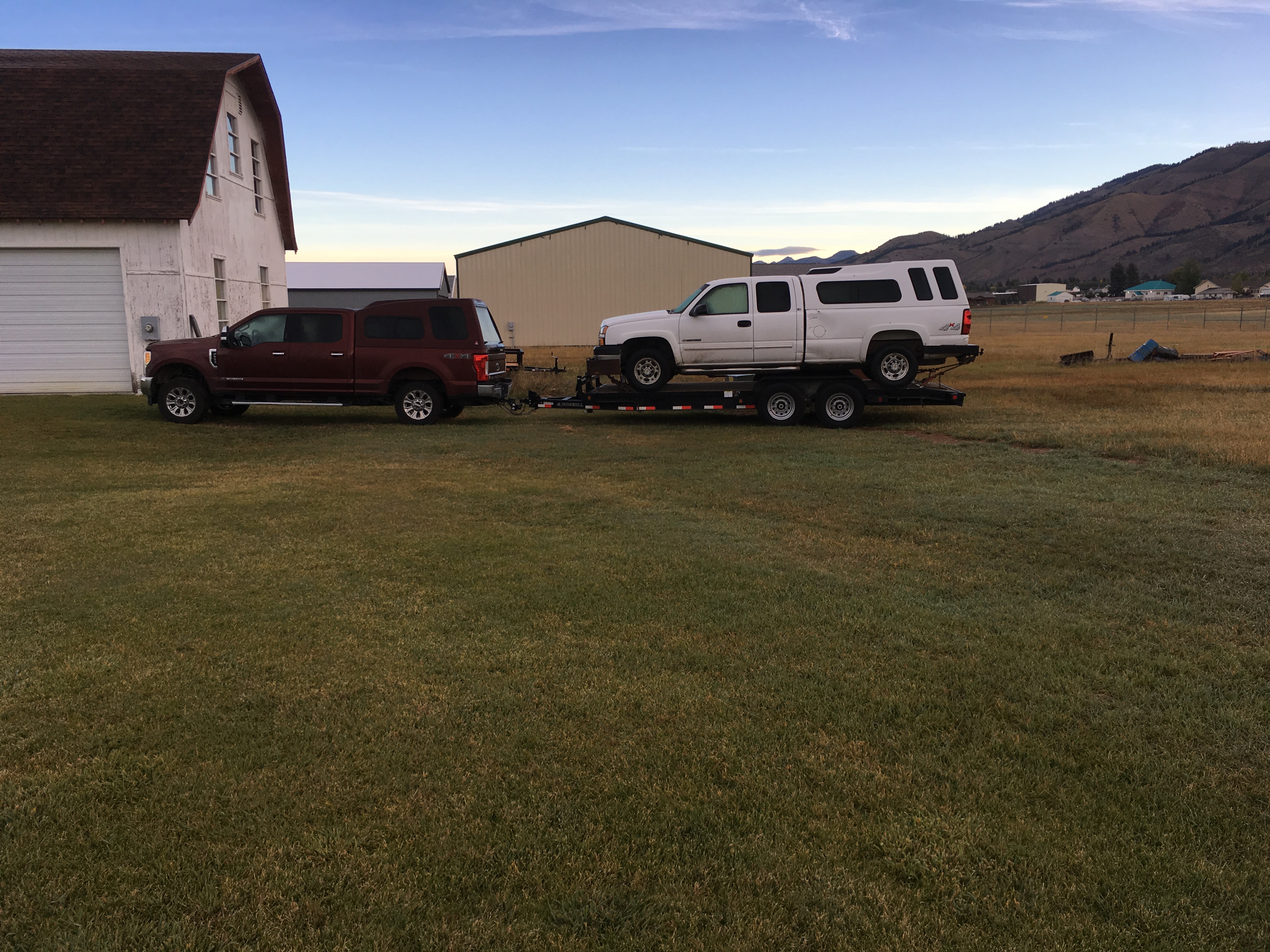

Permanently mounted winches do have some advantages. For myself I wanted a self contained portable winch that could be moved from vehicle to vehicle without any extra wiring needed. If needed I can even haul mine out in the woods on the ATV, tie it off to a tree for winching something I can't get the pickup or trailer too.
At times I have just chained the winch to the front of a trailer that didn't have a receiver on it. The following picture shows a pickup I had to recover a few weeks ago, before the trailer was setup with a receiver. I just chained the winch to the front of the deck, winched the pickup as far forward as I could but the load didn't balance out so I moved the winch up on the tongue and pulled the pickup the rest of the way forward.

IT's all about if winch is rated for load you are trying to pull aboard.... And Battery and/or electrical hookups (Anderson connectors) ... The receiver mount is very viable system...They make complete winch mounts for receiver "hitches"....
