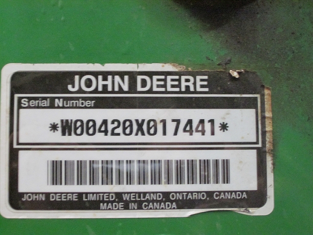

OK, my 420 loader on Deere 4400 would not stay up. Not just not stay up, it would drop six inches in two minutes. It did't happen with my snow plow, so I figured it was not the valve on the tractor, but internal leaking of the cylinder. This is loader serial number 017441. For that serial number the right part is AH176273. There are only two different kits for this loader, this is the later one.

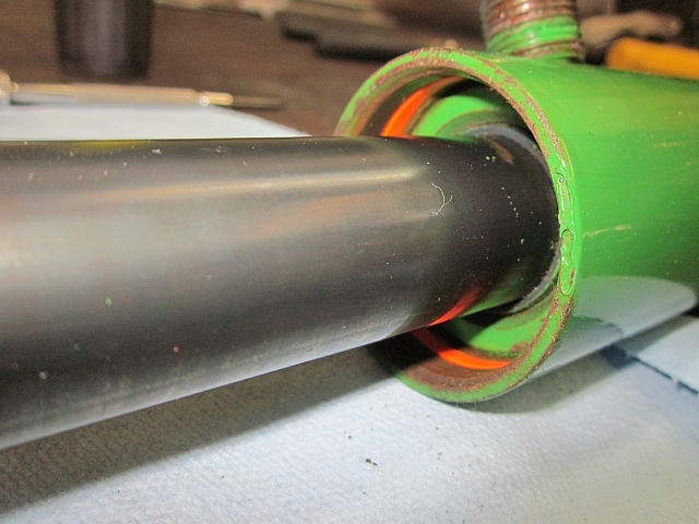

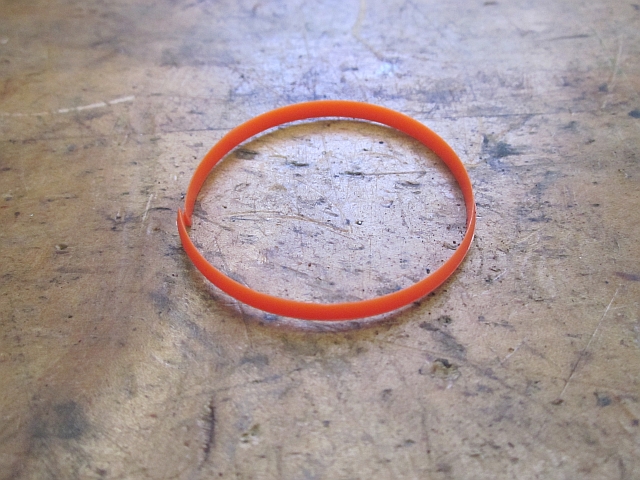

Now inside the kit is this orange split thing. That is the tool you need to take the cylinder apart. You take off the "C" clip on the cylinder and push that part inside the cylinder until you see the machined slot. That orange thing goes into that slot and lets you pull the cylinder apart. Without that, good luck.

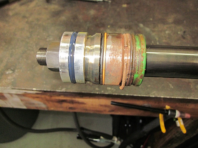

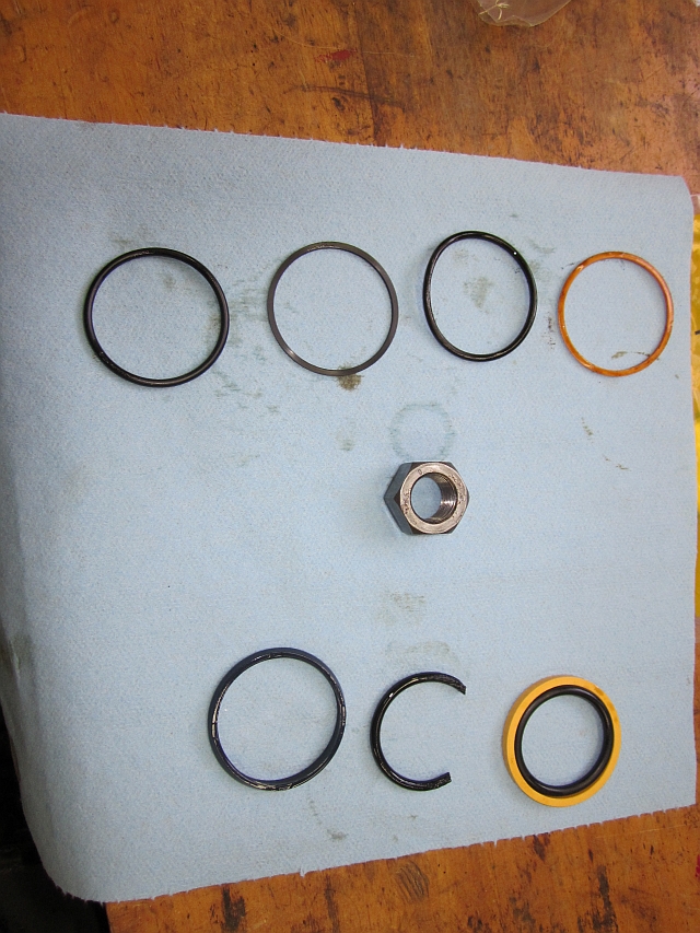

When it comes out, it looks like this. The last pic is of the O rings. The yellow one in the lower right with the O ring inside is what actually goes on the aluminum piston. The inner O ring keeps that yellow thing against the wall of the cylinder. If you look at the O ring with a chunck out of it... That chunk was missing, so this cylinder really had no chance of working right.. God knows where that chunk went.
There are also two seals that get replaced, no pics of them, but they are a PITA to get the old ones out, and an equal PITA to get the new ones in..

They sent me the wrong kit Thursday. Deere still has the truck that leaves the distribution warehouse in Canada every night after COB and drops parts off on the East Coast the next day, so they had the right parts in Saturday AM.
Bison, yes it fixed the problem. Good as new now.

I think he did find the problem...
From the original post:
