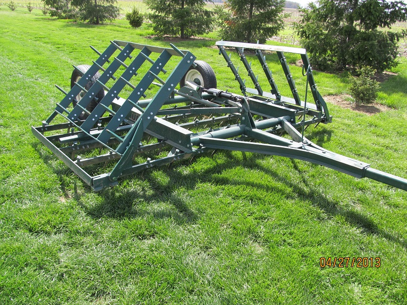

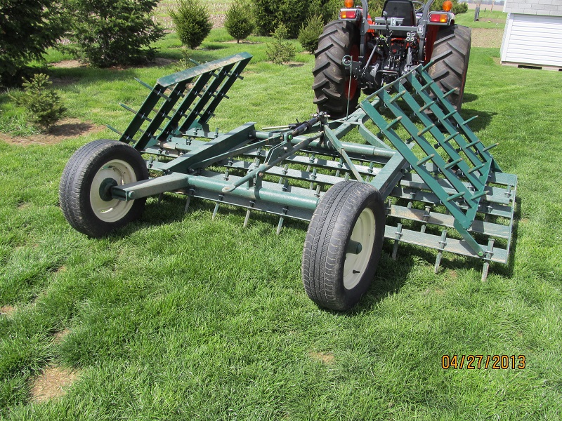

Stick a fork in it; it's done. I put the wings on today. It really is beautiful and works like a champ. So, for your examination...
and second photo...
Now what? the chase is over and a new one is out there. Probably time to put it out by the road with a "for sale" sign on it. We all know the feeling...

   / Rebuilding harragator "spike harrow" project #43
Looks good I could have used that last week.
   / Rebuilding harragator "spike harrow" project #44
Sixdogs..................I'll take two.;) Awesome job!:):thumbsup::licking::drool::2cents::dance1::cool2::drink:
hugs, Brandi
   / Rebuilding harragator "spike harrow" project #45
Sixdogs,
You did all of us that enjoy rebuilding and restoring equipment proud.
Job well done!

This is a pretty old post - hope somebody is looking at it... I have this exact machine. One would think that using it would be as simple as dropping it and running with it. Mine gets significant amounts of earth and stuff in it, make a big mess really. Anybody ever use one of these to any degree?
   / Rebuilding harragator "spike harrow" project #47
How and under what field conditions are you having this problem? If you have a lot of loose debris that is long or stringy it will choke up.
#48
I use these a lot. The ground has to be totally dry or it's a mess. I use almost exclusively in July and August for fields and vast expanse of lawn. First I chisel plow, then cultivate, and then use the Brillion mentioned in this thread. I actually have a couple of them. Then I seed and wait for rain. It is perfect this way and rarely get into damp soil so no issues.
These are not for a damp climate or damp ground or they'll make mess.
   / Rebuilding harragator "spike harrow" project #49
My field was low in organic matter content, and I don't have access to manure... I decided to plow down 2 crops of oats. I actually disc'ed the last crop of oats in and then used the Harrowgator. If it doesn't like stringy debris then I put it in the worst possible field condition. The problem was clearly between the Tractor's seat and steering wheel. Thanks
