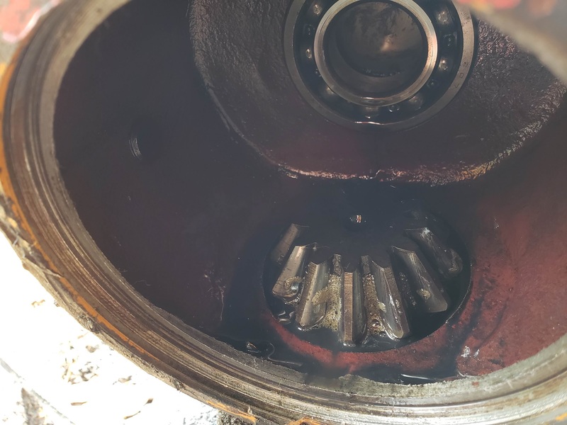

You need to find out what is loose.
I'm not being clear enough. The bearing is just fine and is not loose in the face plate. When you put the o-ring into the housing and slide the plate in after, there should be a bit of pressure needed to be able to get that 5" circlip to lock in. No pressure is needed, and in fact, you can slide the plate back and forth in the housing. So either the plate is too thin, the o-ring is too thin or there's damage to the inside of the case. The last scenario seems to be the case and you can see it in this pic.

I know the gear in your picture has oil foam on it, but does it also have some debris too?
Check all the mechanicals for play, slop, etc. Debur the edges the oring has to go over. Make sure the oring protrudes a bit out of it's groove. Check closely the surface it is supposed to seal upon. At the edge of the photo, it looks like someone about destroyed the case trying to get the cover off???
Both gears are quite clean with no wear spots or nicks.
op6rodmqowhffwb1sb3nchoocs9reuw3vs9xrs6u6xlhon62jhnd4lb2n2ndh9yc8g9vm2vj45nfaz43h-w2440-h1830-no-jpg.462993
OK. Now I understand, and agree with you're diagnosis. The gearbox housing looks rough. I think I'd make a shim to go between the snap ring and the plate.

Could there be a shim to set the gear contact that's missing?
   / Rebuilding a Woods Finish Mower
#19
I thought of that, but the play in the front plate is there with or without the input shaft in place. There is a shim on the input shaft.

Alrighty then... I got in the seal and the oversized o-rings. I went to assemble the plate on the transmission and found it a bit "snug". I couldn't get the large circlip in. So I took a couple of c-clamps and put a good amount of pressure on until I could get it to pop in. I filled her with 90 wt and look ma: no leaks! I'm going to pressure wash the beast before I put the new belt on.
