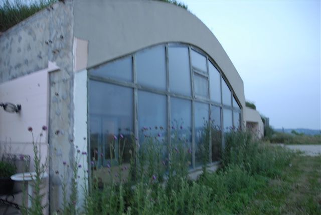

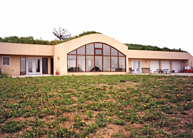

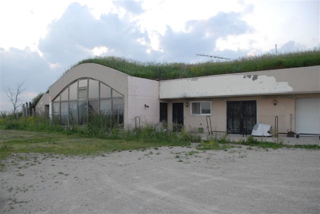

The first picture is what the house looked like when built from the Terra-Dome website, the other pictures are what it looks like today. The water proofing process the original home owners used did not work. When asked they told us it was a single rolled on layer of Eco line with Benoite sheeting (Paraseal) all over the dome and that there was drain tile in the valleys. The pictures show some of the dozen leaks that are everywhere, both from the walls and ceiling.
Before anyone asks yes that is algae growing on in the corner, and interesting enough this leaking crack has a pencil mark around it and is marked leak under the plaster that has fallen off. It appears they also injected some sort of foam into the crack.
The exposed surfaces of the house are covered with an EFIS type stucco over 2 inches of rigid foam. Obviously water got behind this and it failed as the entire EFIS surface is separated and loose from the house.
Here is our initial plan to return our Terra-Dome to the snug dry condition it deserves. First we are excavating the entire roof and walls to the footing, injecting the cracks Hilti's CI 060 ep epoxy, spray foaming the exterior with closed cell poly urethane foam, and capping it with a sprayed layer of poly urea (bed liner material) then replacing the drain tile and dirt. We will move onto other parts of the house, however we expect the roof process to take most of the summer as we are doing almost all the work ourselves.
On a positive note, the house stayed work in t-shirt warm (50+ degrees) through this years Wisconsin winter with just 2 portable base board heaters since the furnace was junk, so when we get done we look forward to the low heating bills when we are done.
