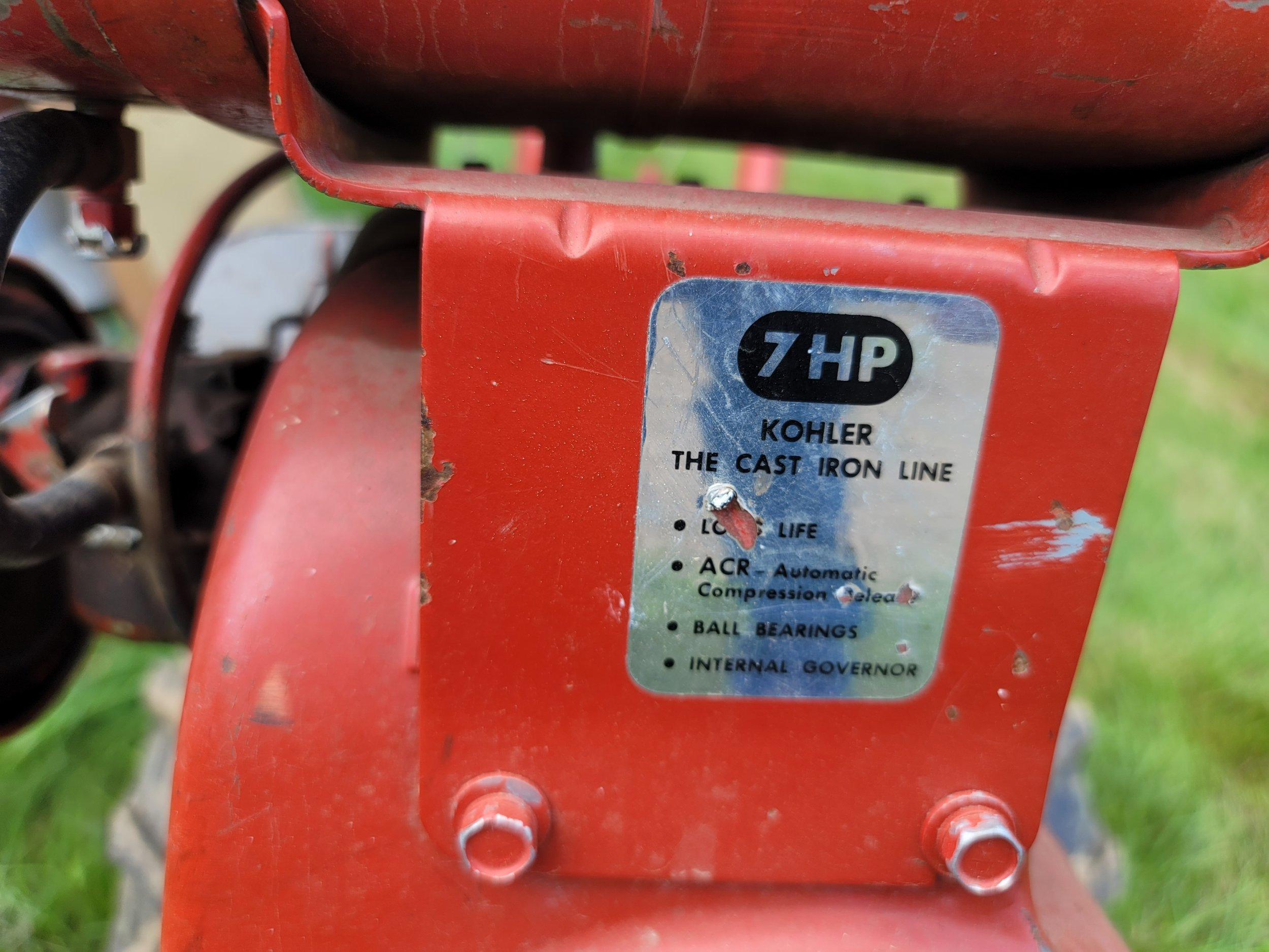

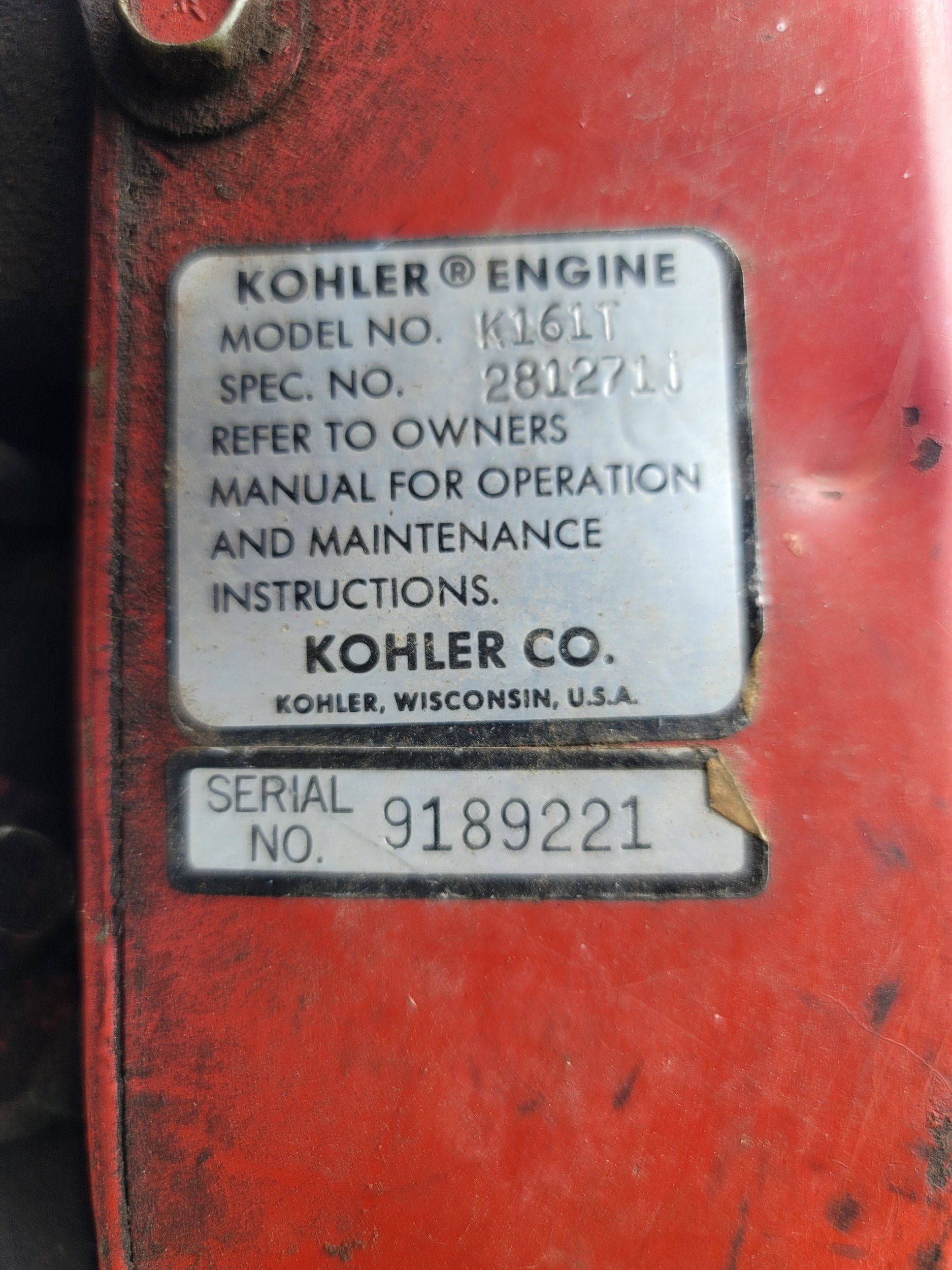

   / Rebuild or Replace Troybilt Horse #15
I have a dilemma. I inherited by father-in-laws Troy Bilt horse tiller that was bought sometime in the late 70s. It starts easy and runs smooth but has lots of issues. The transmission slips really bad unless I wire View attachment 707191View attachment 707192down the lever. I have to keep constant pressure on the throttle. I live in Maine and have been unable to find anyone to do a complete restore job. Do you know of anyone in the western maine area who would take on such a project.
Is it worth it to spend a lot of time and effort to get this rebuilt or should I just replace with a new Big Red Tiller or other recommendation you may have.
Thanks
I think you are saying that it's jumping out of forward gear and you wire the lever down to keep it in forward. If that's the case, Troybilt made an upgrade kit that includes a modified Adjustment Block and Friction Wheel. Search online for
Troy-Bilt Adjustment Block & Reverse Disc for 4 speed.​
This kit fixed the problem on the tiller I inherited from my dad. He fought the problem for years never knowing they made a kit to correct the problem. The kit runs $70-$80 and is simple to install. It is absolutely worth the money since your motor runs well.
