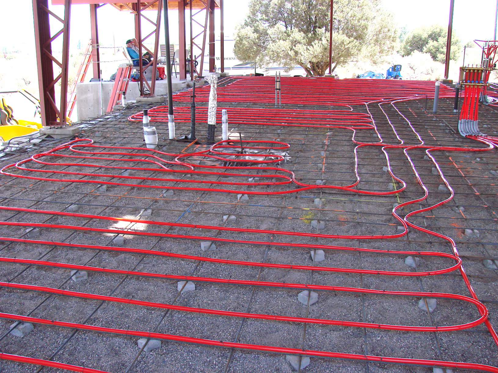

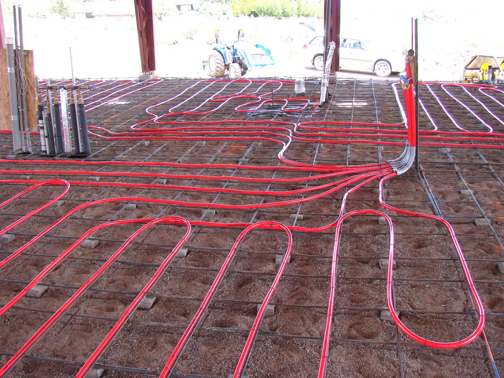

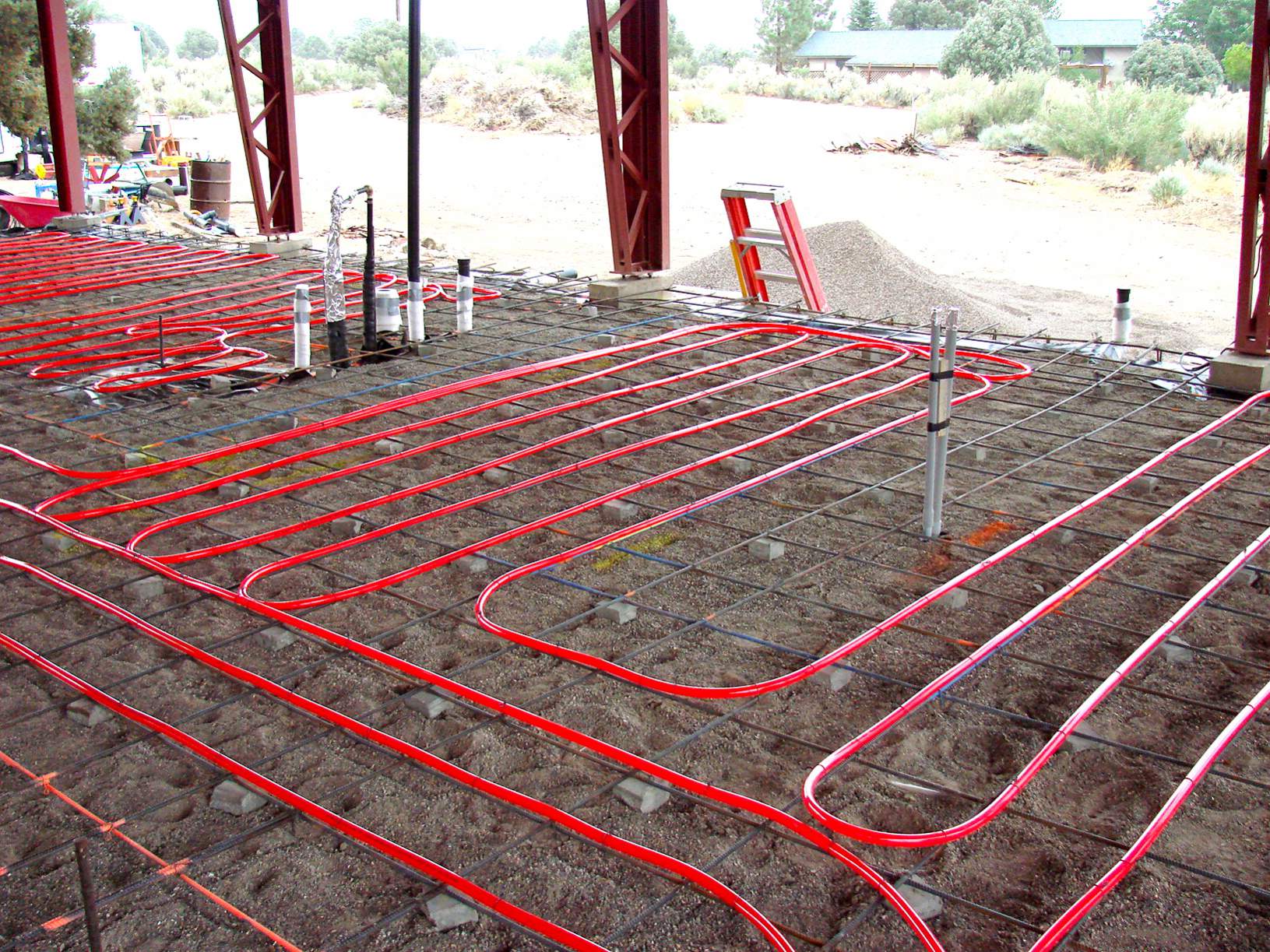

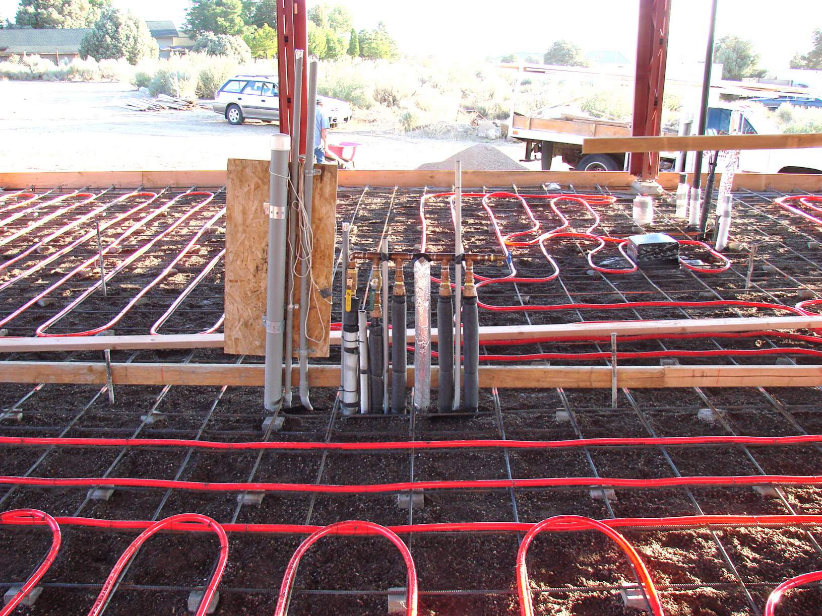

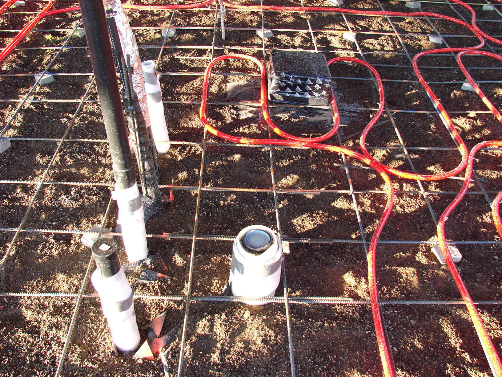

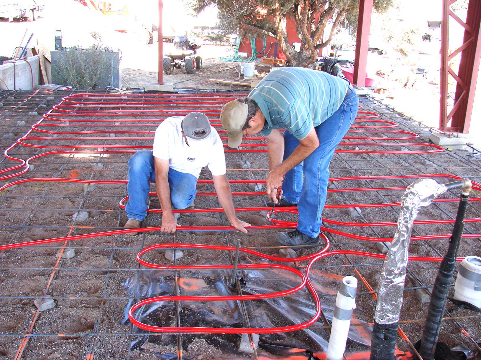

Ya dont use too many or the concrete flowing into the slab will just knock them out of position and float them away cause there is not enough weight on them to hold them in place.
That is my opinion too. If I do it next time I would use cement bricks.

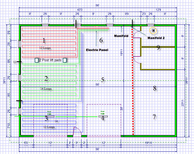

I do plan on having two thermostats, but none in the cement. I redid the order with 3/4" pex and the pex alone was only $275 more. Not sure if it's worth extra expense.
