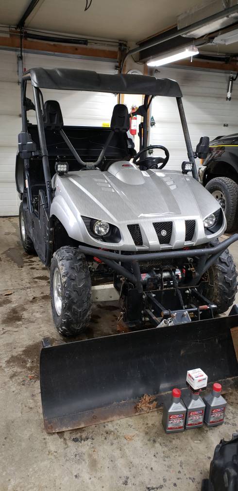

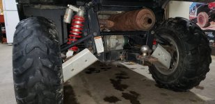

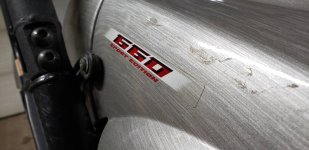

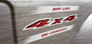

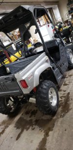

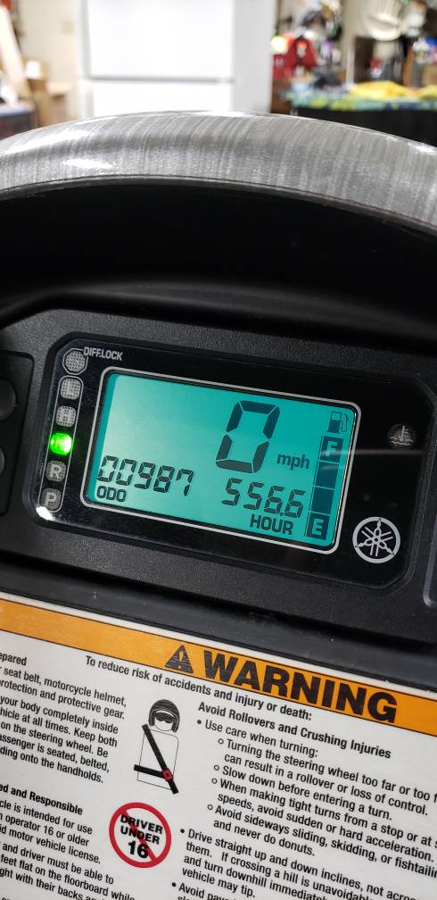

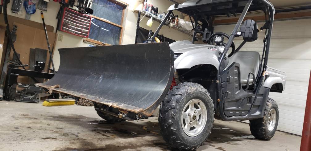

It's getting picked up this week to start a new life as a commercial plow vehicle. I'm getting $5,500 for it. 20190113_145620.jpeg20190113_145715.jpeg20190113_145640.jpeg20190113_145730.jpeg

Yep. Twin to yours.
Ultramatic is a $100 word for sure.
If you don't work your Mulecany harder than you worked the Rhino you'll get along fine.

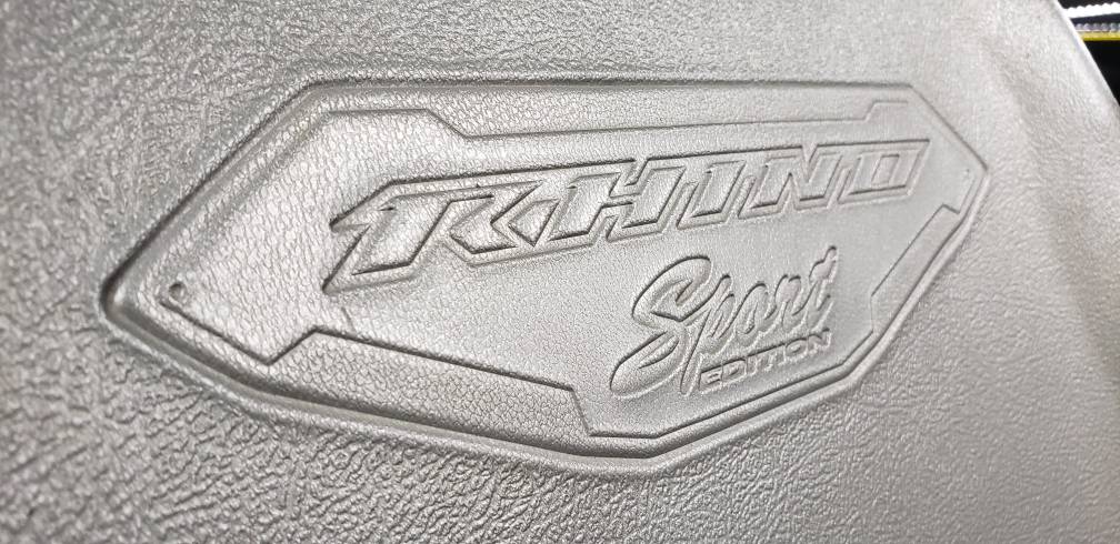

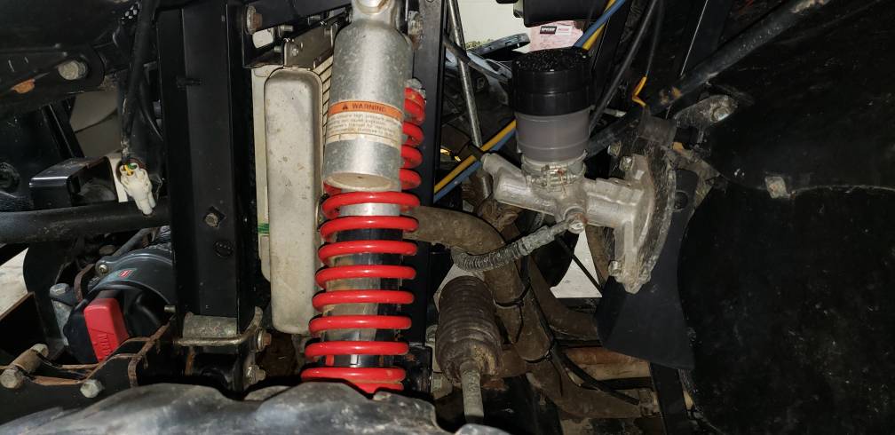

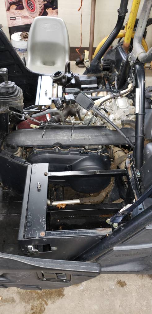

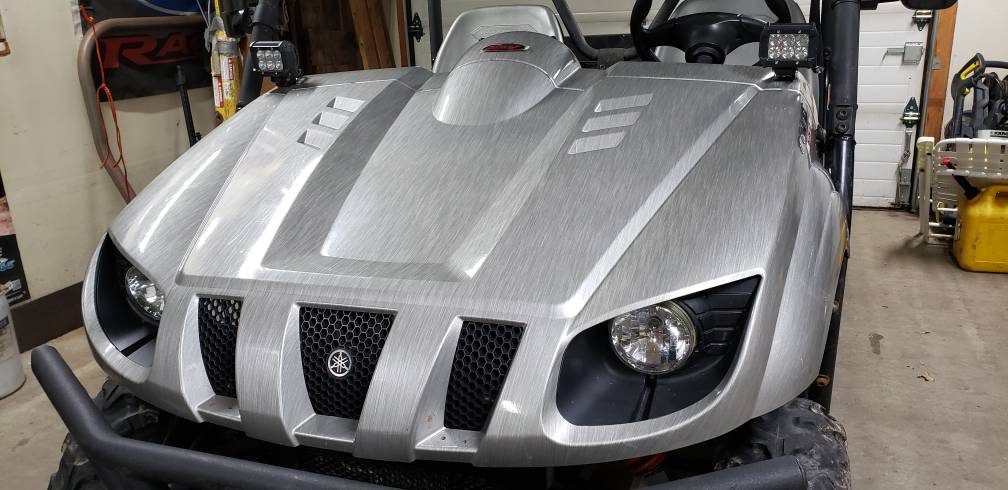

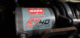

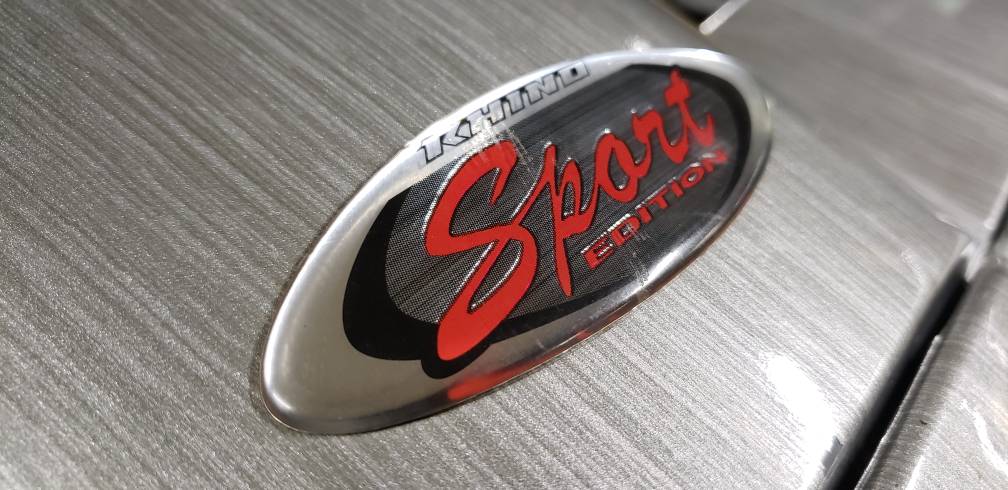

The Rhino is being picked up Tuesday... Our 13 years together has come to an end.20190113_173440.jpeg20190113_173409.jpeg20190113_173456.jpeg20190113_173517.jpeg20190113_173617.jpeg20190113_173526.jpeg20190113_173551.jpeg20190113_173803.jpeg20190113_173844.jpeg20190113_145730.jpeg

You know... It kind of hurts me that I didn't buy a "pretty" one with the metallic painted body, aluminum mag wheels and fancy stickers.... I always like to buy social editions, limited edition, limited runs... My Truck is a Mojave Sand limited edition Rebel, my Wrangler is a Willys Wheeler Special Edition and my Rhino was the Liquid Metal Sport Edition.
Now I'm going to have steel wheels, a dull plastic body and nothing... Special.
