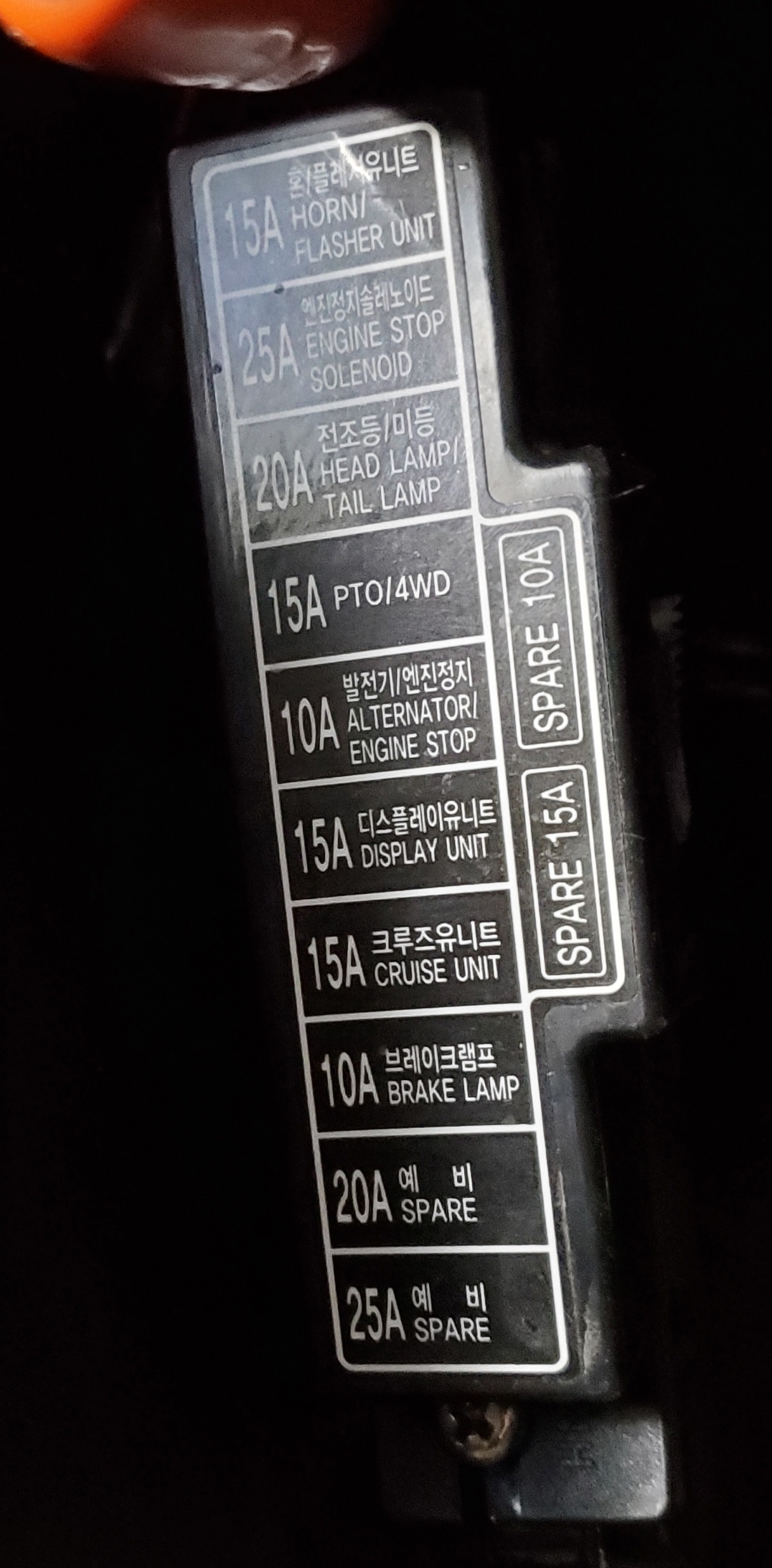

I changed out all the bulbs on my DK40SE (only one headlamp was left working). When done, I found that the two rear work lights won't work. I replaced them (and the fronts) with NAPA BP1235/H3-N. Since the front work lights work fine, my guess is that the cab switch is bad. However, the cab switch lights up - does this indicate anything? I haven't tested voltage anywhere as it's late and a pain to take the work light covers off again in the snow.
In terms of troubleshooting, I presume you'd check voltage to the rear work lamps first? Presuming there is none, what would be your method of troubleshooting to make sure it really is the switch? Any other possibilities?
I noticed that when I pulled out the rear bulbs, they came out fairly easily. However the fronts required pushing in through a hole in the connector (using an awl) to release some kind of catch which prevents the connector on the bulb from slipping out. I doubt there is a connection issue, but mention it to give all the info.
Another oddity:
I tried to check fuses (before the fronts were changed), and according to the shop manual, fuse 7 should be the work lights. But when I look at the fuse box, that one doesn't exist (all the others do). Have they included the work lamps with the headlamps fuse?

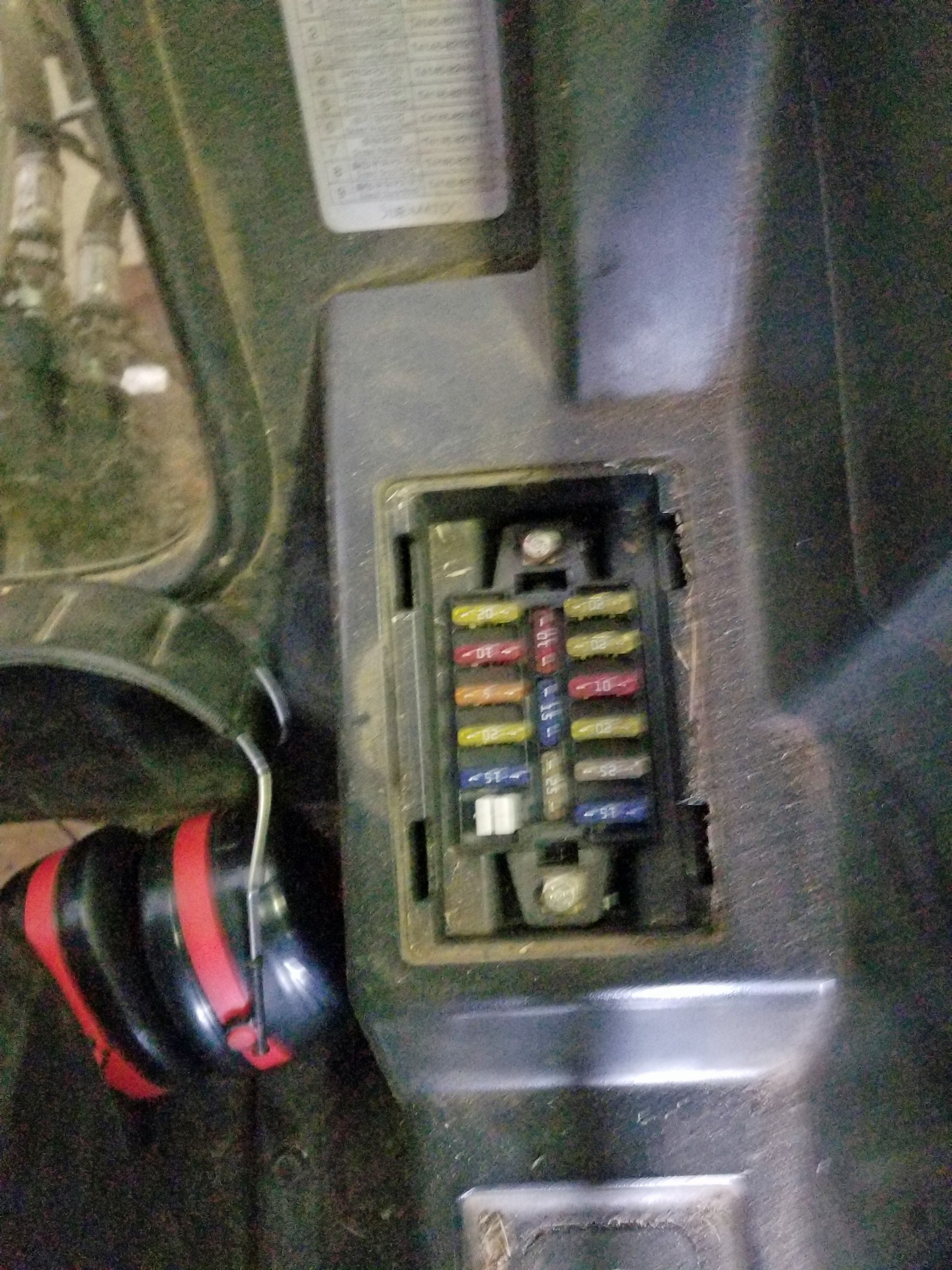

The kioti cab tractors have a separate fuse box on the left side rear by back window and near seat. Did you check those fuses
That's what I was hoping to hear. The shop manual doesn't show it. :banghead:
If it turns out there is a blown fuse in that box, you've saved me a lot of aggregation. Thanks.

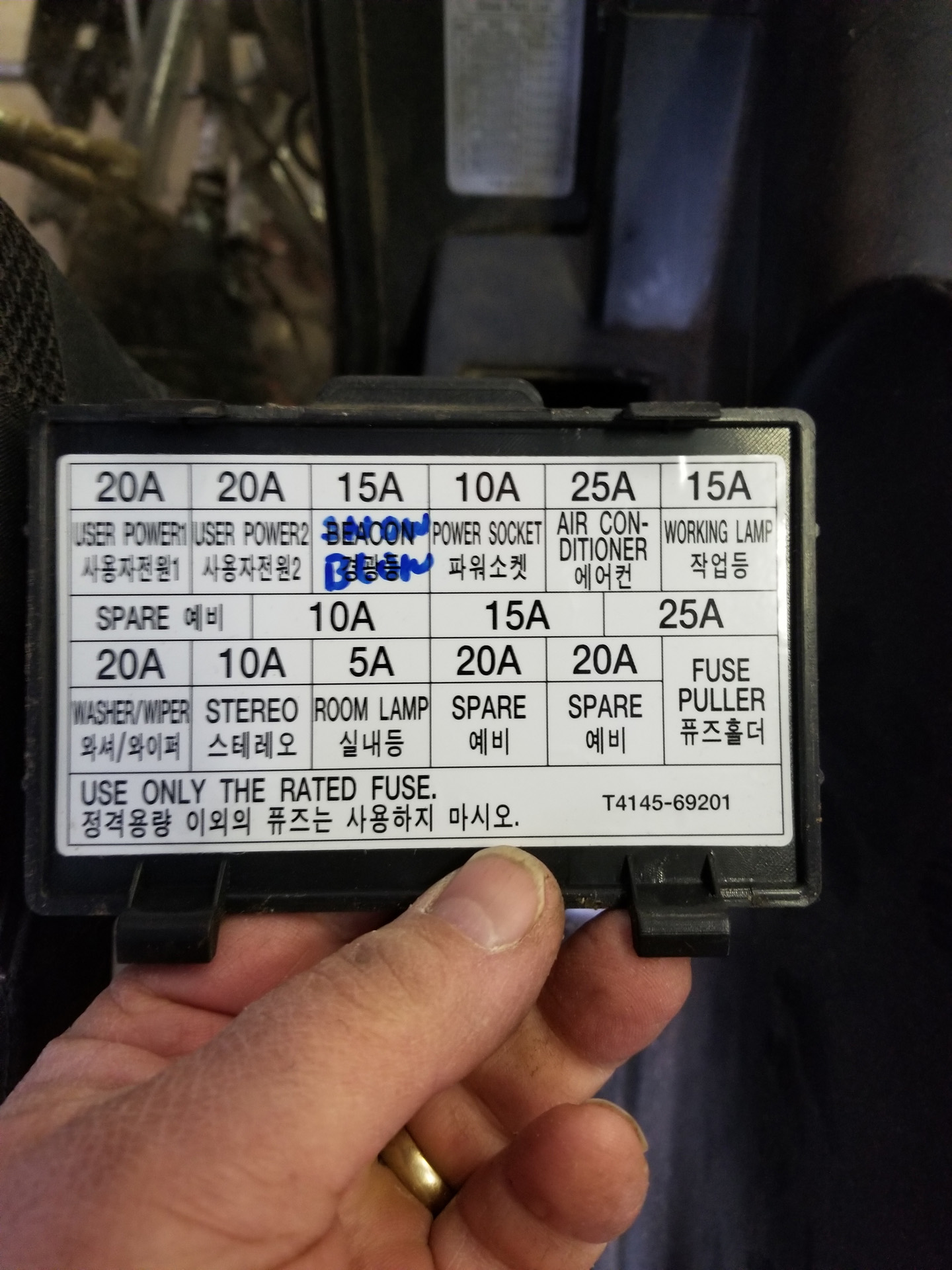

Not in my manual. My wife verified it's there. The fuse looks intact, she says. I will try a new one anyway. It's a 15A, different than the 10A shown in the shop manual.
**Update** It has one called "working lamp". Not sure if that's it for both front and rears. Replacing it did nothing.

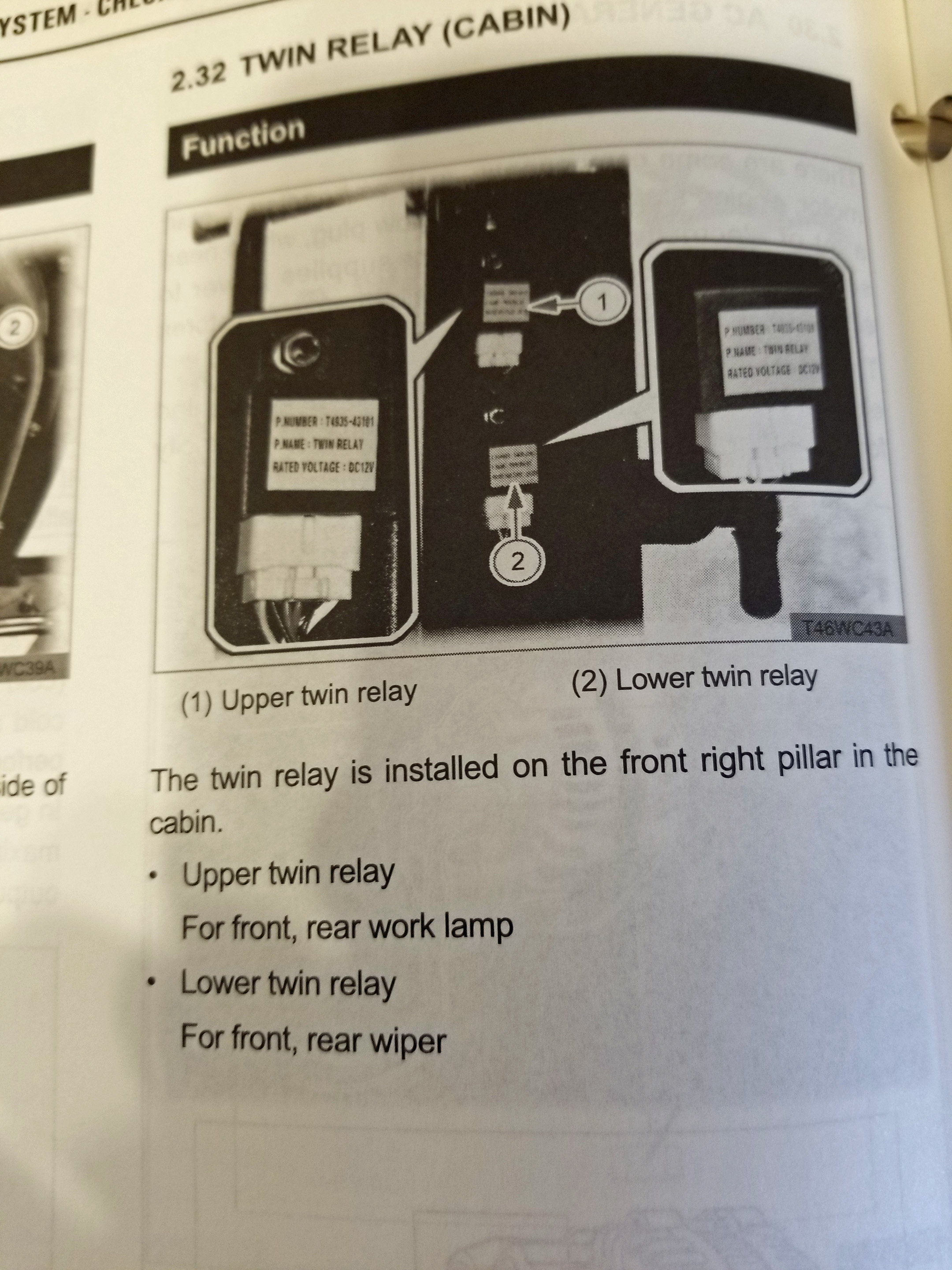

ok. after looking at my tractor and my shop manual, i can tell you some things on my 2010 DK45 cab. first, pulling the working lamp 15 amp fuse kills the rear lights. second, there are 2 relays located on the right hand cabin pillar that control the lights. i have included some pics. so the switch controls power to the relays, and the relays power lights. 1.jpg this is the fuse label. working lights is the lower right 2.jpg when i pulled lower right fuse lights went out. 3.jpg heres the line drawing from shop manual that shows switches, relays and cabin lighting. 4.jpg this is the cover on the right piller that has to be removed. im not sure, but i think its the piller cover with the cigarette lighter socket that is the one needing removal, but the book is vague about which one to remove. 5.jpg these are the 2 relays. 6.jpg these are the relays detailed
there twin relays, so if 1 part has failed (rear lights) the front part can still be working.

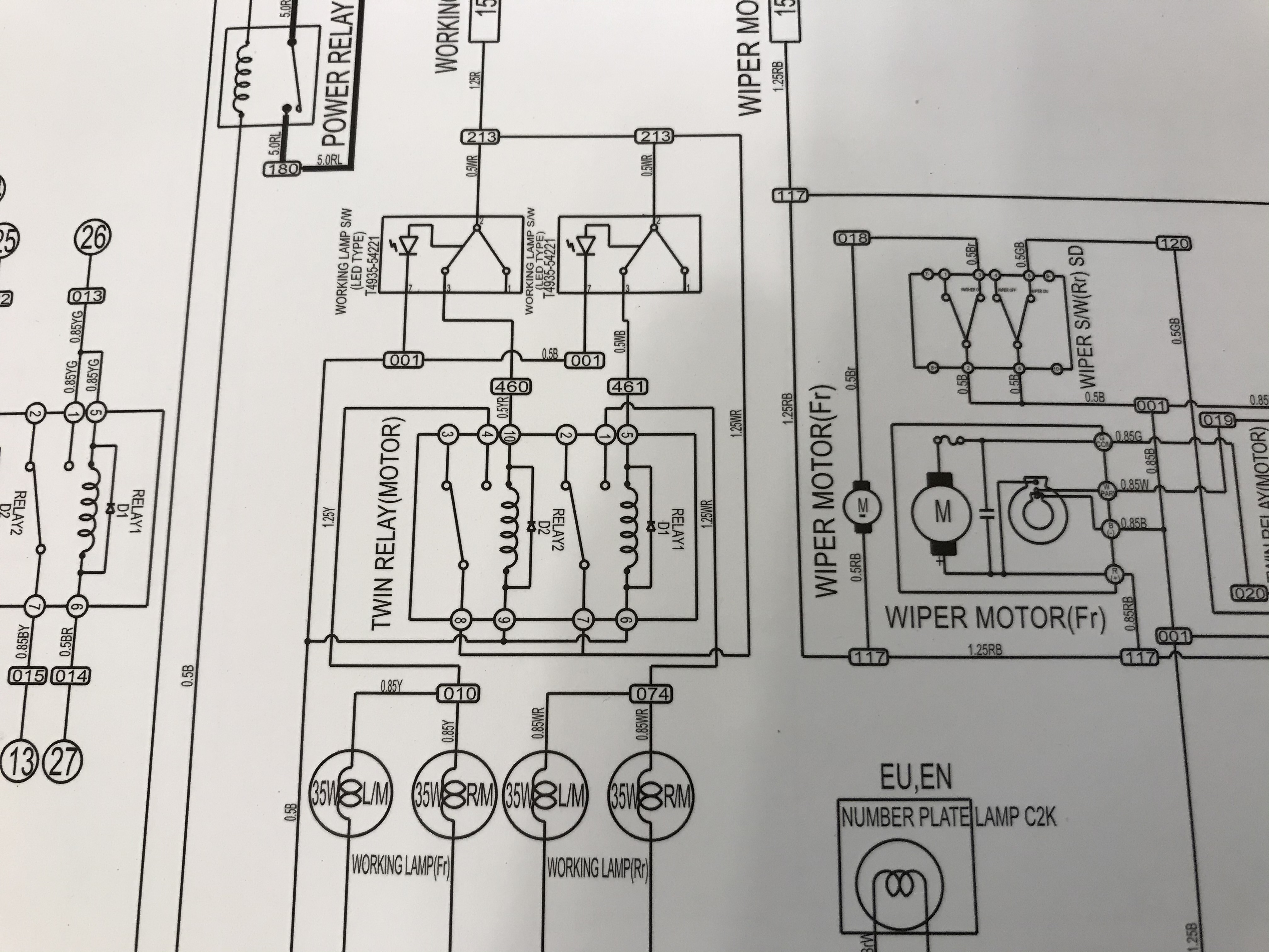

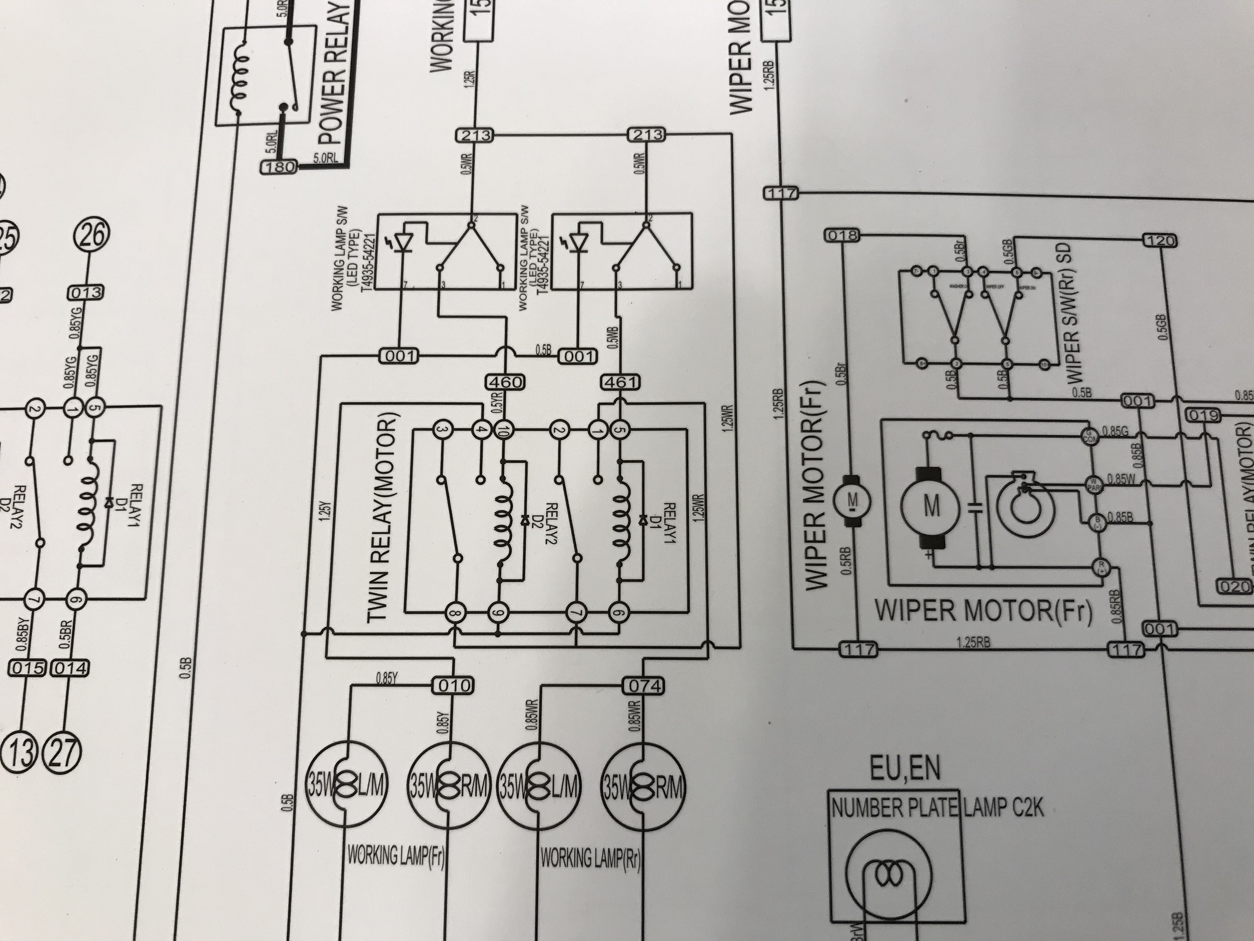

I tested at the rear work light and there is no power, as I suspected.
I took off the pillar and found the work lights twin relay. This is where I realized that I don't really know what I should be testing.:D
Looking head-on at the white connector, there are two rows of pins. The wires behind the pins are as follows:
YBRRBW
Y****W
With the front work light switch on (ones that are working), Yellow to Yellow has power and the Black and Red on the right side show power.
With the rear work light switch on (ones not working), the Black and Red on the left side show power.
I didn't test all combinations and didn't know what to test on the relay itself. Any advice on what to look for?
If not the relay (and how can I tell) ... what can I test next?
Thanks in advance for your help.

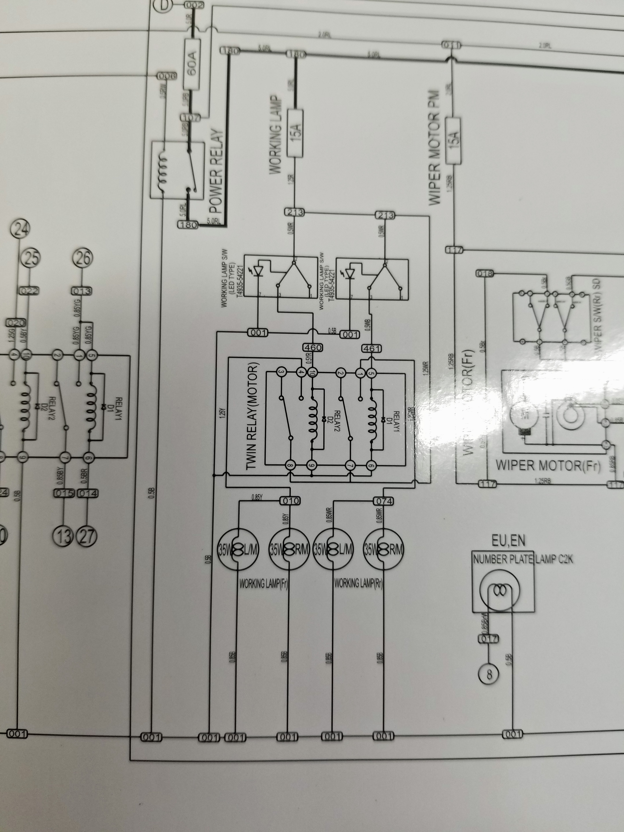

3D0F4E4A-EB1F-45ED-B728-5A44CD1D17E4.jpeg going by this diagram, there should be 6 wires on one side of relay and 4 on the other. Either wire #4 or #1 go feed the lights. It looks like the use the same twin relay for the wiper motor, so i think you could just swap the 2 to see if thats the issue. Your wiring looks different from the schematic. The book is for a 2010, not sure what year yours is. Im not really sure how to test a relay except for slightly pulling connector out so pins still touch, then testing wire #4 and #1 for 12 vdc ( with black test lean on a known good ground and red test lead touching pin #4 or pin #1) as you flip switches.

View attachment 676488 going by this diagram, there should be 6 wires on one side of relay and 4 on the other. Either wire #4 or #1 go feed the lights. It looks like the use the same twin relay for the wiper motor, so i think you could just swap the 2 to see if thats the issue. Your wiring looks different from the schematic. The book is for a 2010, not sure what year yours is. Im not really sure how to test a relay except for slightly pulling connector out so pins still touch, then testing wire #4 and #1 for 12 vdc ( with black test lean on a known good ground and red test lead touching pin #4 or pin #1) as you flip switches.
Actually, the schematic is correct and I found the same one in my manual. Since there's only 2 wires fed to one side of the relay (the side with 4 in the schematic), I didn't show the two empty slots. Anyway, your idea of using the wiper relay to test with was brilliant. Front and rear lights worked just fine with the wiper relay, so I'll be ordering a replacement from Tractor Joe. Their price isn't bad for the relay ($30), but shipping is a killer ($18). Couldn't find a better site, though.
Typical, I dropped one nut while trying to replace the working relay on its post and it went straight down the opening the pillar made. I should know better - and set up a towel to catch nuts. Anyway, now trying to figure out what size nut - looks to be an M6.
Thanks again.

No problem. Michigan iron is also a good site for kioti parts. By the way, there are like 4 or 5 of those double relays on the tractor. One or two under the hood, and some under dash cover. I had to replace one that runs the pto.
Maybe i should order one to keep as a spare.
Glad it worked out.
