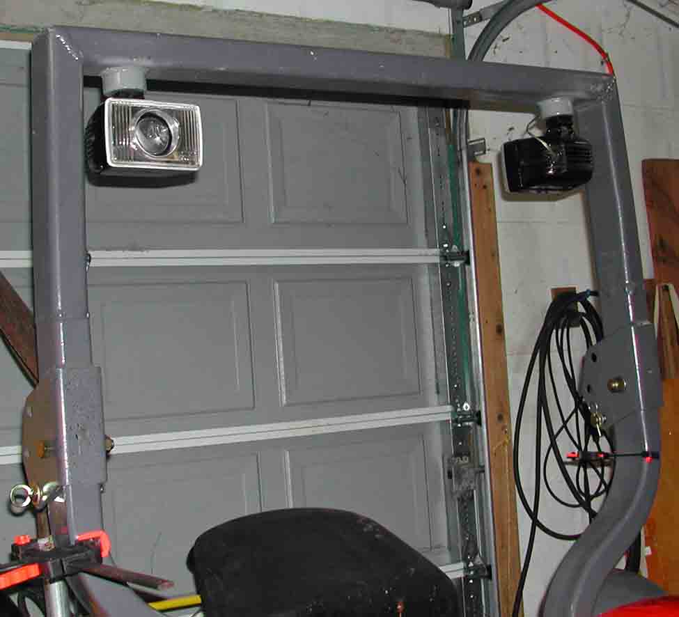

now how about someone that has some mounted up on the ROPS?
   / Rear work light #9
Check my post in the Customization thread. Alos in the Kioti owning/operating thread with the title "Width of Rops".
Marc
   / Rear work light #10
now how about someone who has some mounted up on the ROPS?
I have one pointed fwd, and one to the rear. I did not use the small
wires accessible at the rear of the tractor; I used a connection at the
fuse block, relays, and 14 guage stranded wires. I used the turn
signal switch to control them, and the key has to be 'ON'.
One of the reasons that I opted for a squared-off ROPS is so the lights
could be mounted on the inside corners.
