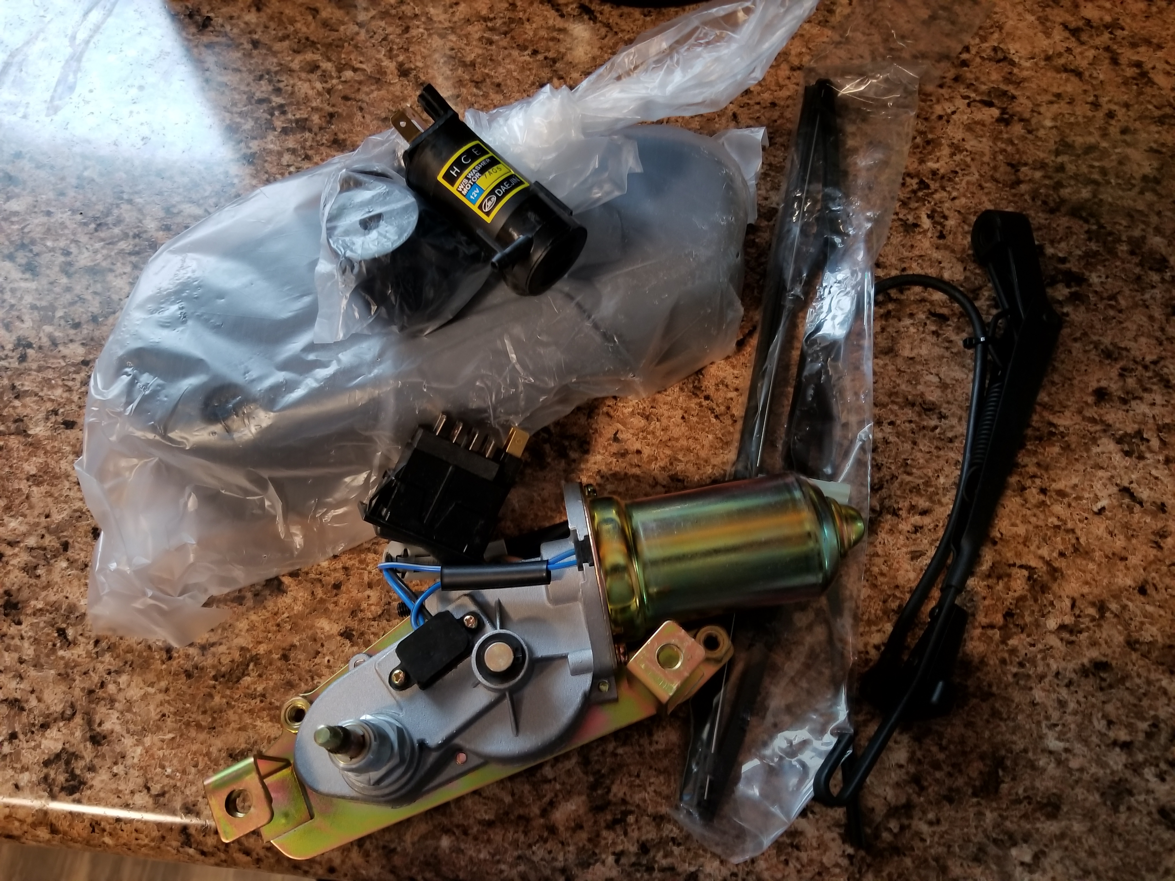

Notice after install that it was time to replace the two year old wiper blade found two replacement blade Trico 14-1 or a better TRICO Onyx*Beam Wiper Blade, 14" available at my local auto supply...when buying a blade this short be sure it's a front blade standard J hook...
/ Rear Wiper install
#27
Just replaced front wiper blade after two year ..it from day one squeaked and chattered...New Trico Onyx*Beam is very smooth running ....rear wiper making noise (chattering) on first use ..picking up a replacement blade for new rear wiper ...the blades that come with the kit are junk don't know if that are just old from long term storage or just cheap or both...for $176. At least they should send a a good blade just sayng.

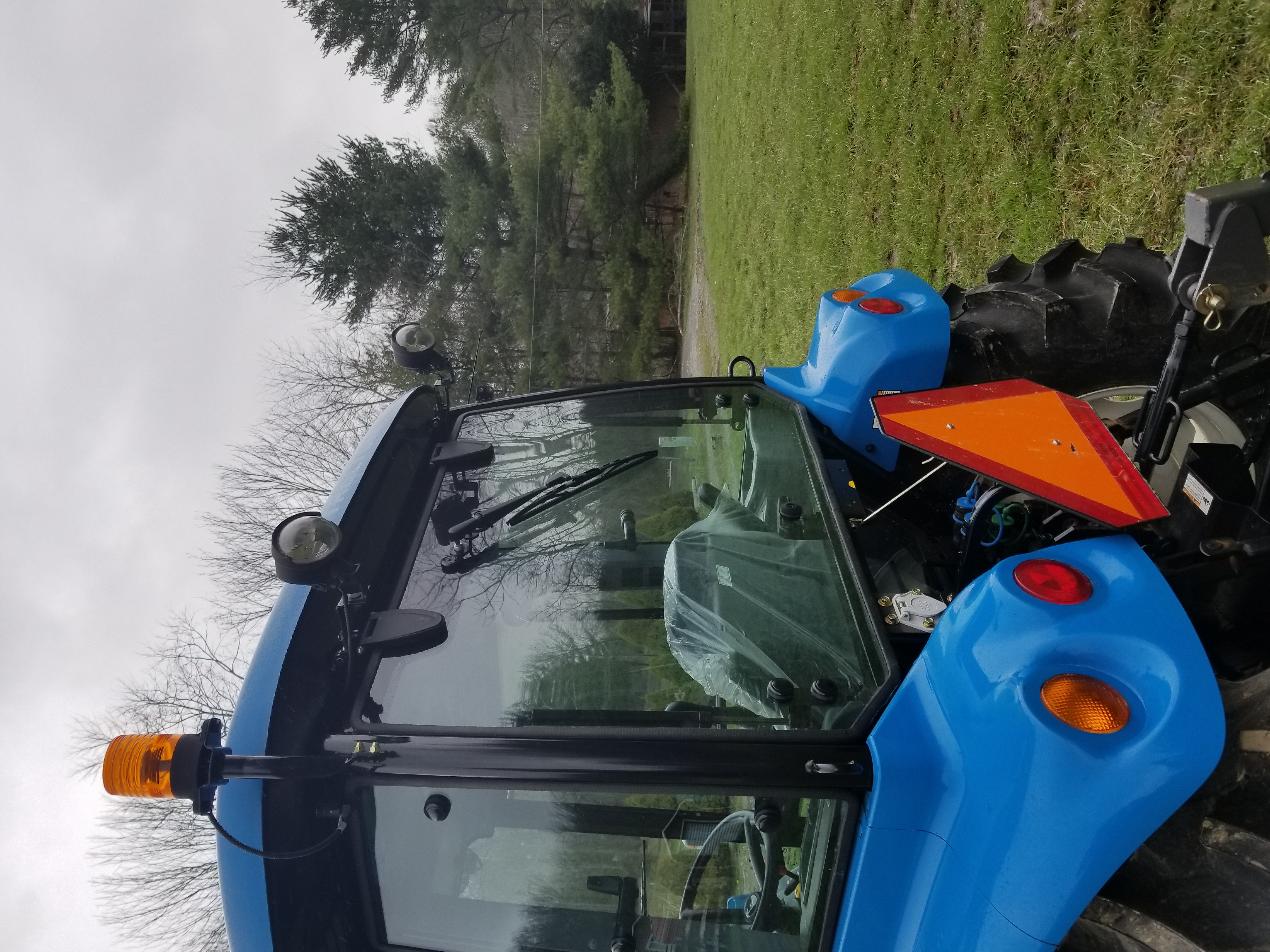

/ Rear Wiper install #28
Trying to find harness in roof. Didn't take totally down. Should harness be in roof by front set of switches or side switches?
/ Rear Wiper install #29
Take the 4 bolts that hold the roof off. Lift the roof up and prop it with a 2x4. You will see towards the back that everything is there and is zip tied to the tractor.
/ Rear Wiper install #30
