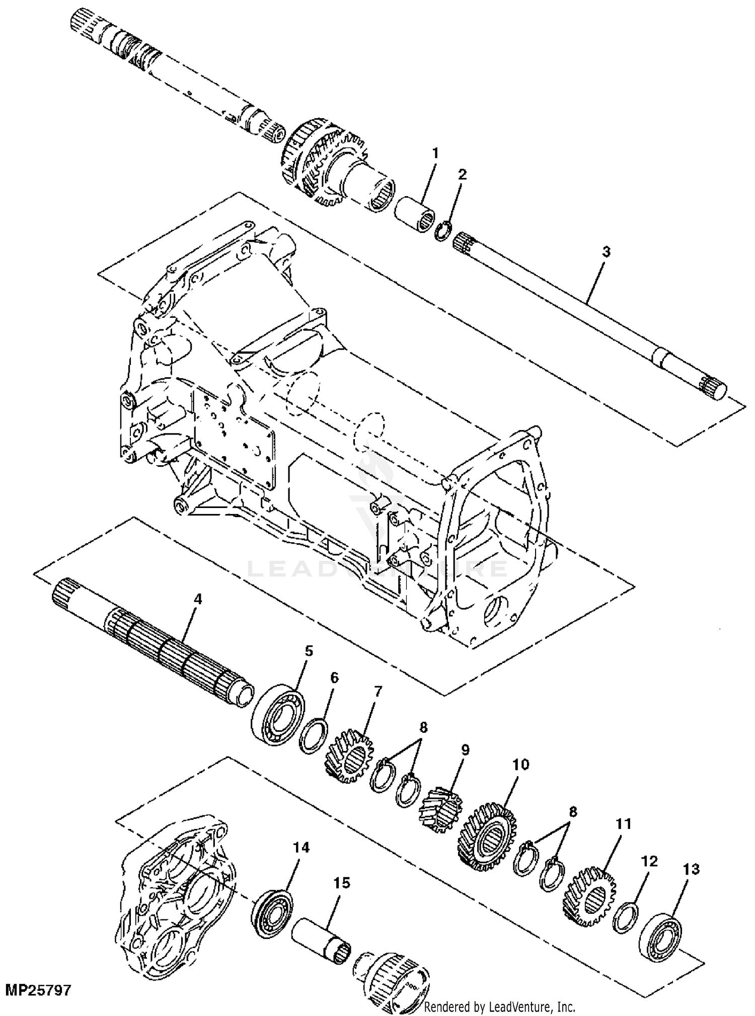

I'm wondering if maybe the coupling between the front & rear shafts slipped forward enough to drop the rear shaft, or lock ring (2) broke, letting the rear shaft slip out.

Not sure which is easier for you to access an internal look at on that tractor, but from the symptoms described, your rear drive shaft is disconnected. Either at one of the internal couplings in the tranny or in the differential. You'll need to open her up & take a look. the Weingartz web link above will give you decent schematics of the internals so you know where to look. A borescope may help you avoid unnecessary work if you can thread it in to see what you need.

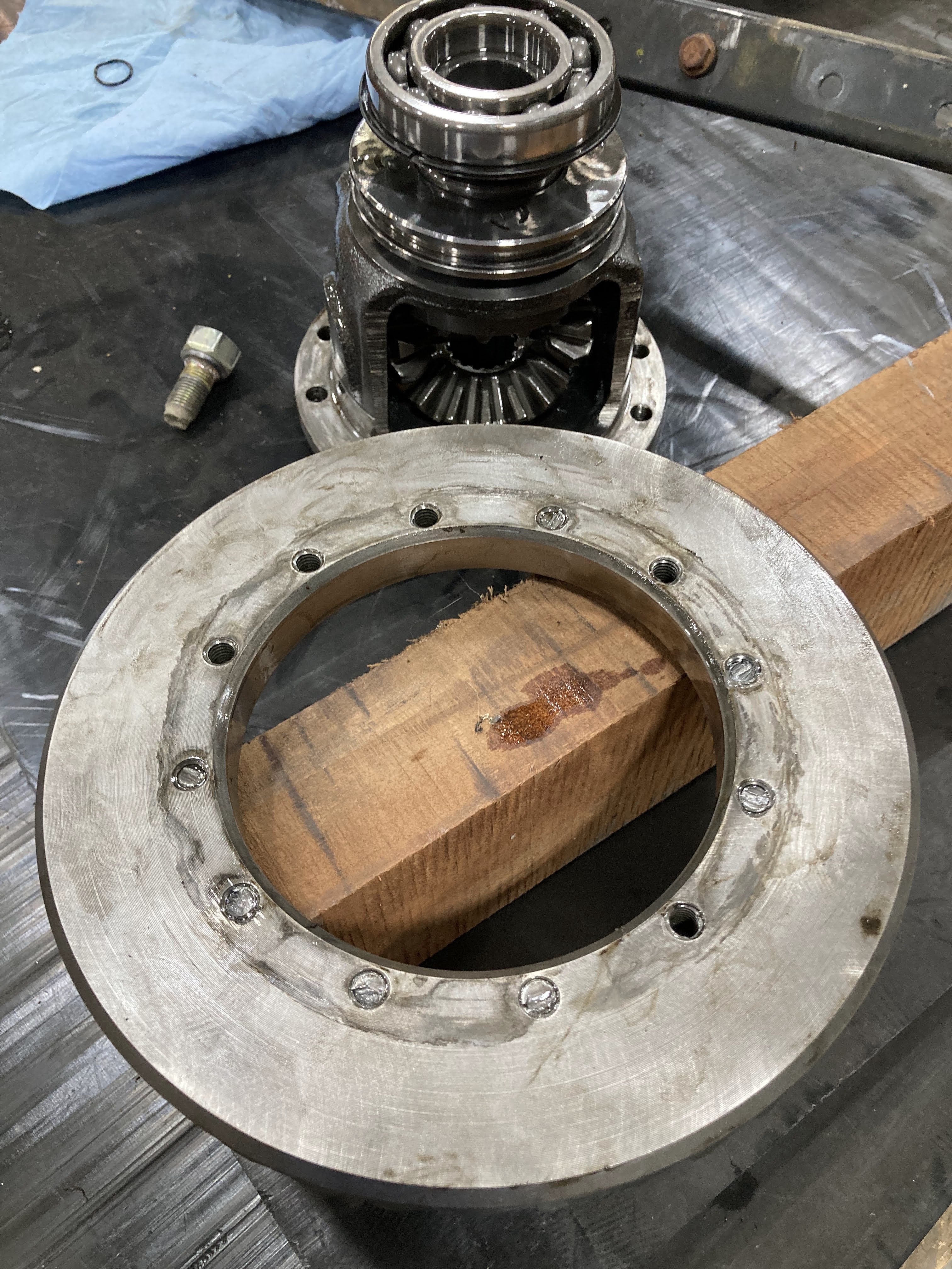

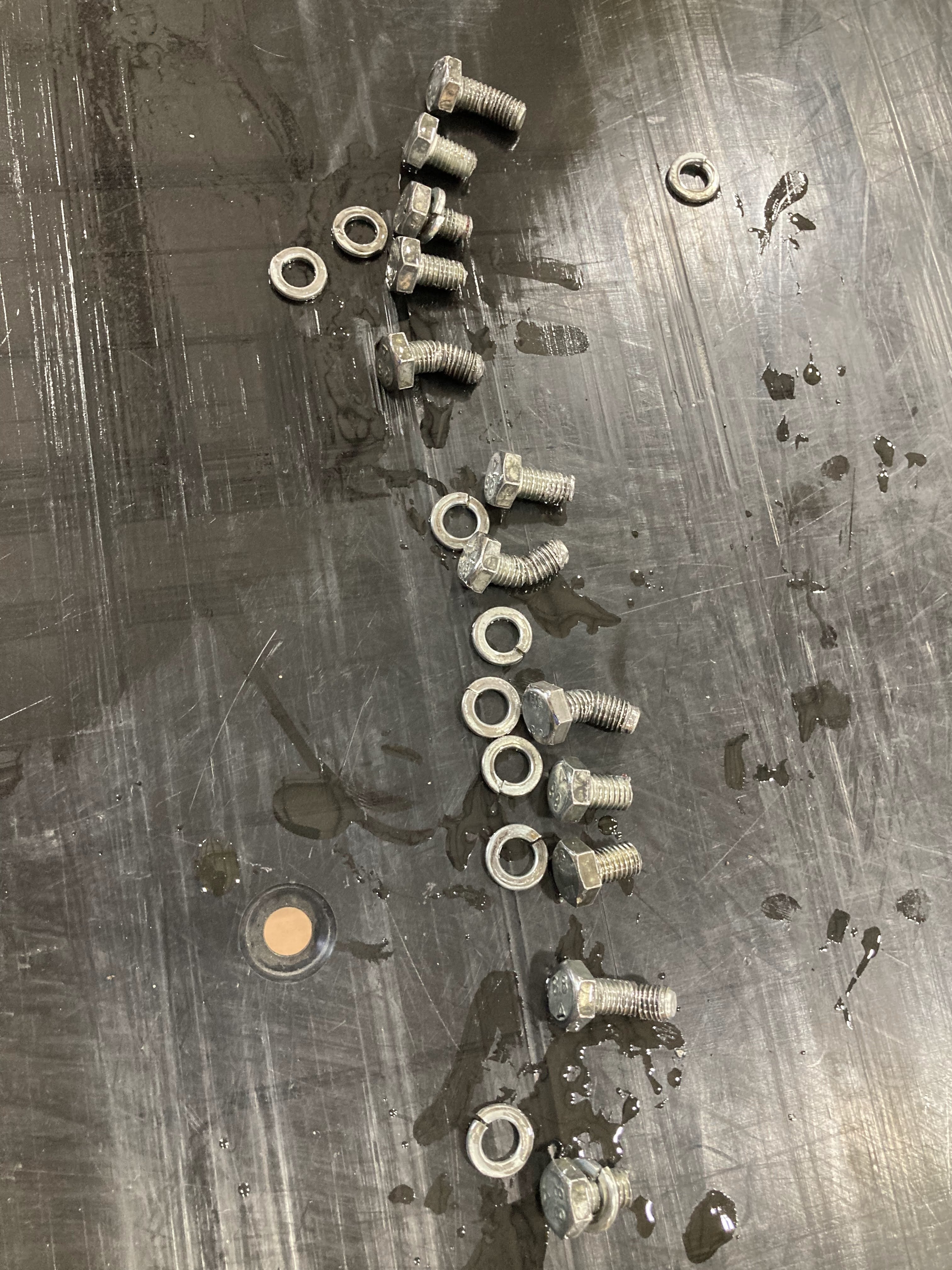

   / Rear wheels no longer have power to them? #17
And the final answer is... sheered ring/pinion bolts! The hope is that they were never properly torqued by JD, the fear is this will happen again.

   / Rear wheels no longer have power to them? #20
It's mostly back together now, blue Loctite was indeed used on the new bolts. I just noticed in the parts catalog that the original 8.8 screws have been superseded by M8-1.25 X 20 10.9 Metric C.S. I'd also expect the torque spec increased, but have no idea where to find that... Looks like JD knows about this problem.
