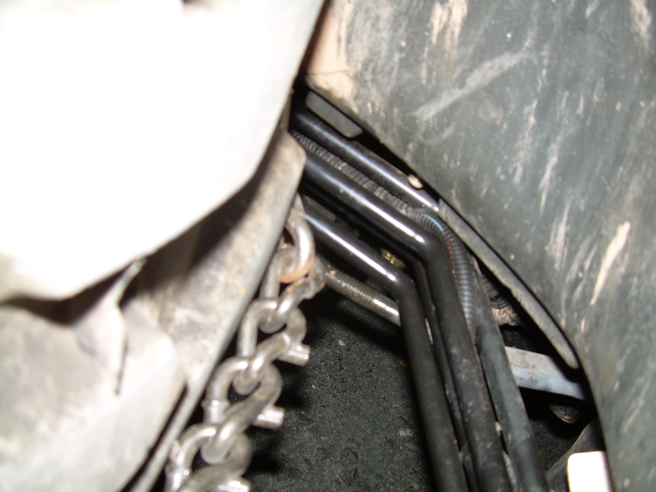

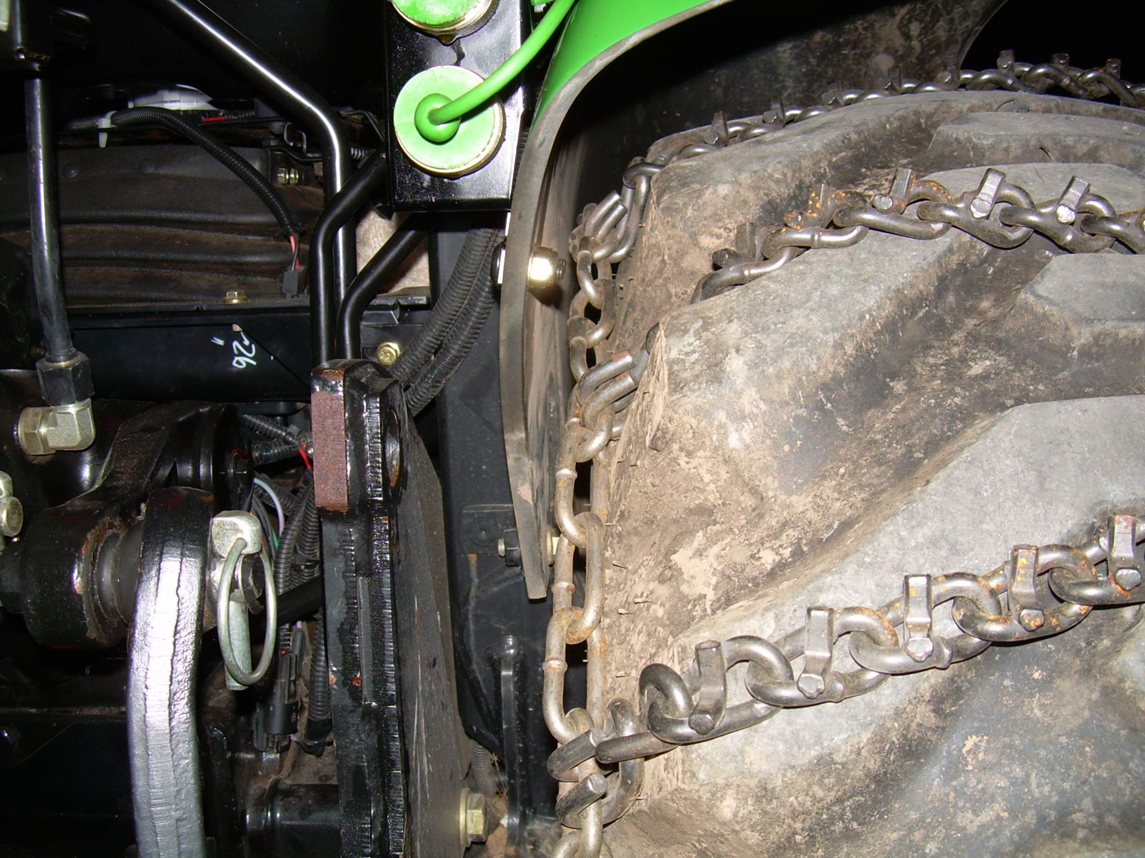

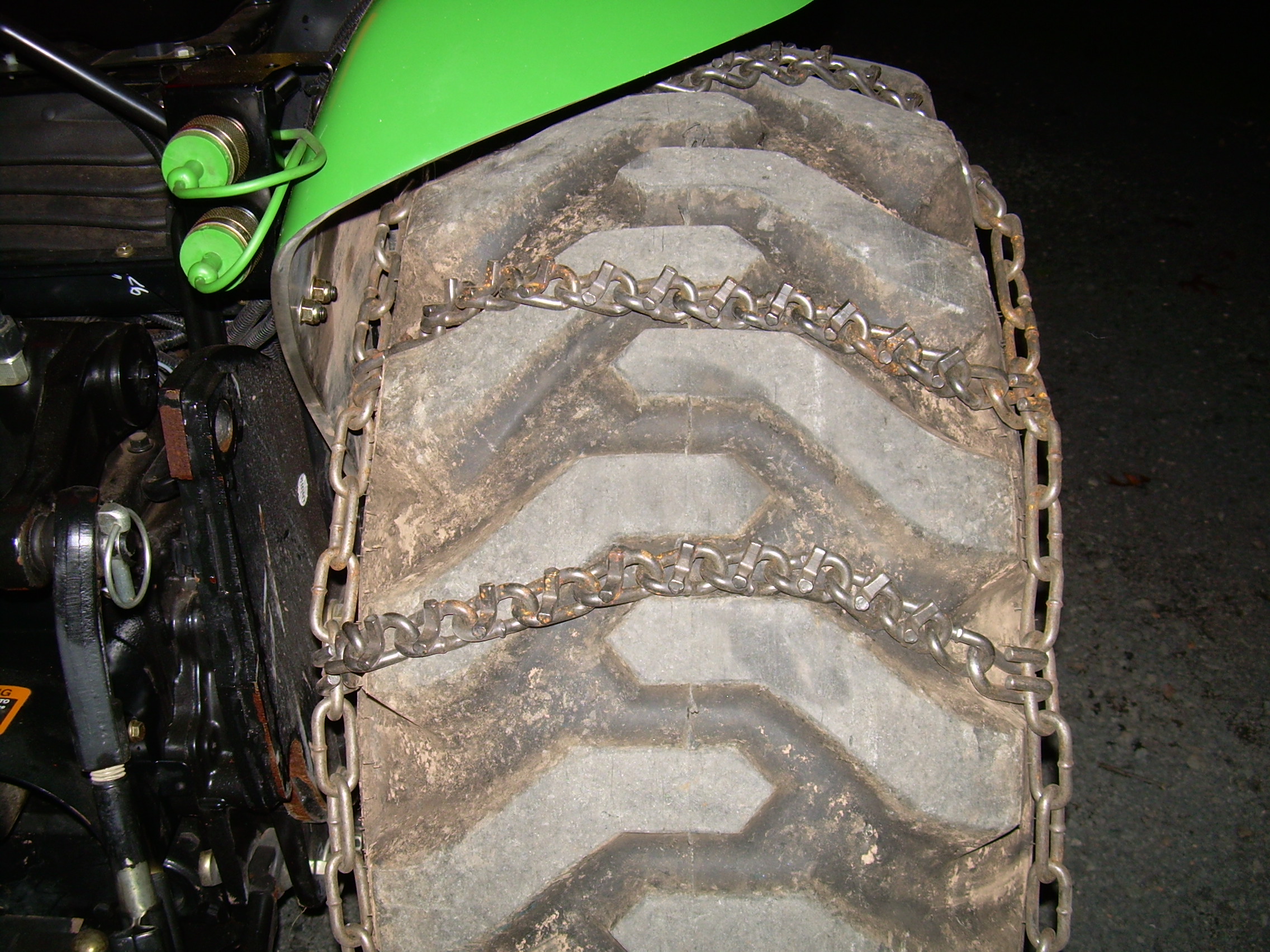

I did exactly what Chuck4310 did and for the same reason, Tire chains, even though this year I did not put them on the rear, only the front. I got a set of rear chains and wanted to be able to install them when needed. only down side on the swap is the rim is a little less pretty on the inside (outside now) but I'm gonna leave them like this all the time.
Did the same with the fronts, actually only took 1 off and flipped it around to see what it would look like and it was way to far out there, looked crazy, so I never switched them just put it back on the reg way.
I think the 4300 is very close to the 4310.
here are before and after pics, you have to look closely to see the difference, the 3rd pic is of the hydraulic lines that are threatened by chains on stock positioned wheels.
Good luck, JB
Good luck, JB

I switched them from side to side today and only gained 1 1/8 inch.
That wasn't much gain but enough to use chains if needed, and i should call my old dealer and tell him they can be switched on a 4300.
Picture 1 was before.
