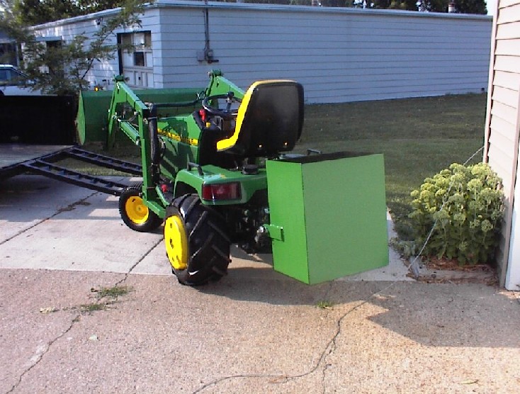

Here is a rear weight box I built for my JD425. The box weighs in at 100 lbs. and then I put 4 bags of 80 lb Quikcrete in it for a total of 420 lbs. Box was less than $40.00 to build and the weight was less than $16.00.

Another Picture

Great looking ballast box. It looks as good, if not better than my factory JD box. And a heck of a lot cheaper.
I have my dads mig welder here, but can't weld to save my life.
   / Rear Weight Box with real cheap ballast #4
With today's MiG welders and auto dimming helmets, there is no better time to learn how to weld. I learned how to weld on a big Miller MiG unit and then bought a second hand 110v stick welder to use at home. That was a real culture shock. I have since bought a Lincoln Weldpak wirefeed welder and while the welding purests out there would laugh at it, it has done everything I have ask of it. I have wleded up equipment to use behind my tractor and I have welded sheetmetal on tractors and it works great. You need to get to pieces of scrap metal and fire up your dad's MiG welder and practice. It really isn't that hard.

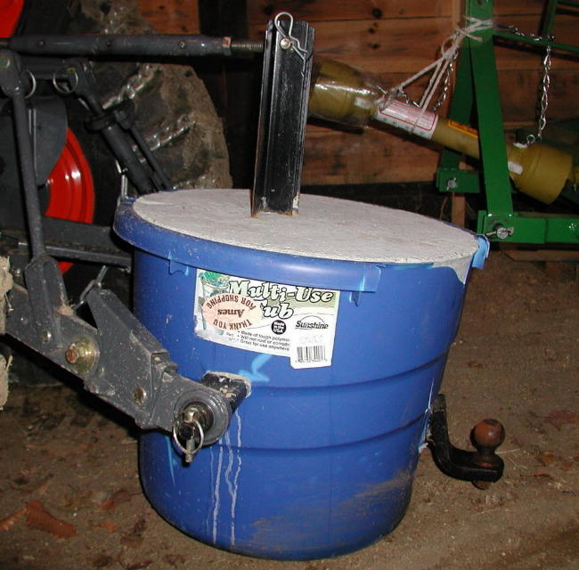

Here is a picture of the ballast I made for my B2910. I took a 25 gallon muck bucket and put a draw bar through it. To that I bolted 2 vertical sections of angle iron with holes for the top link. I took an old rusted T-section of a tow hitch and stuck it through the back. I duct taped around any openings and filled the whole thing with cement and stones. It’s gotten pretty beat up, but works great. I can’t remember what it weighs, but I think it's about 400 pounds. It probably cost me $20-30 to build.David

I love it! We all need inexpensive attachments. Wasn't the tractor expense enough?!? Keep it lubed - Keep it goin'
